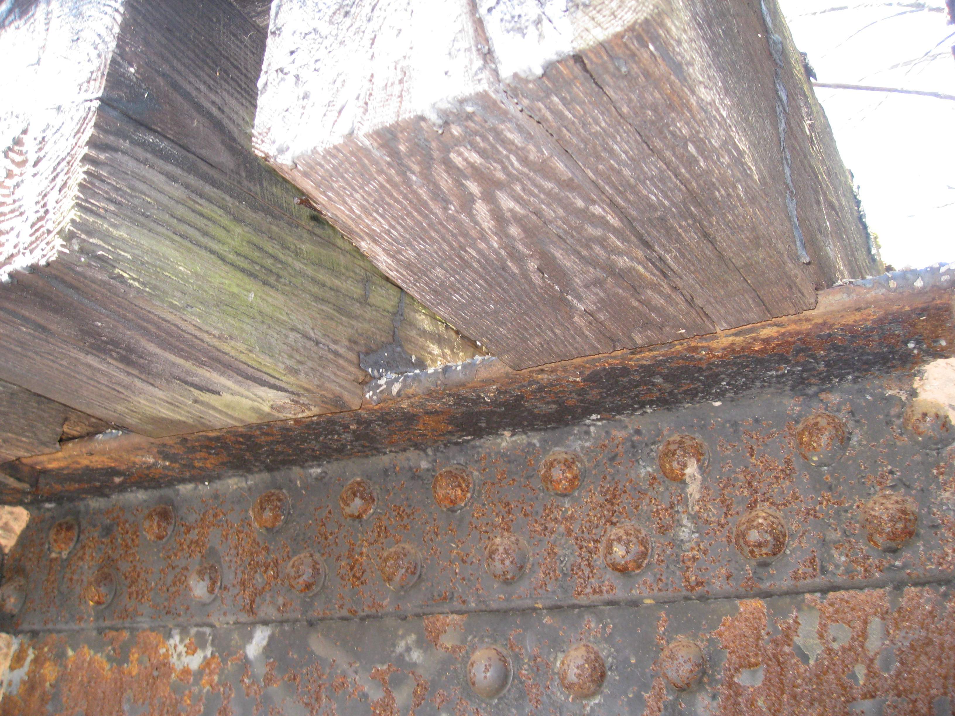

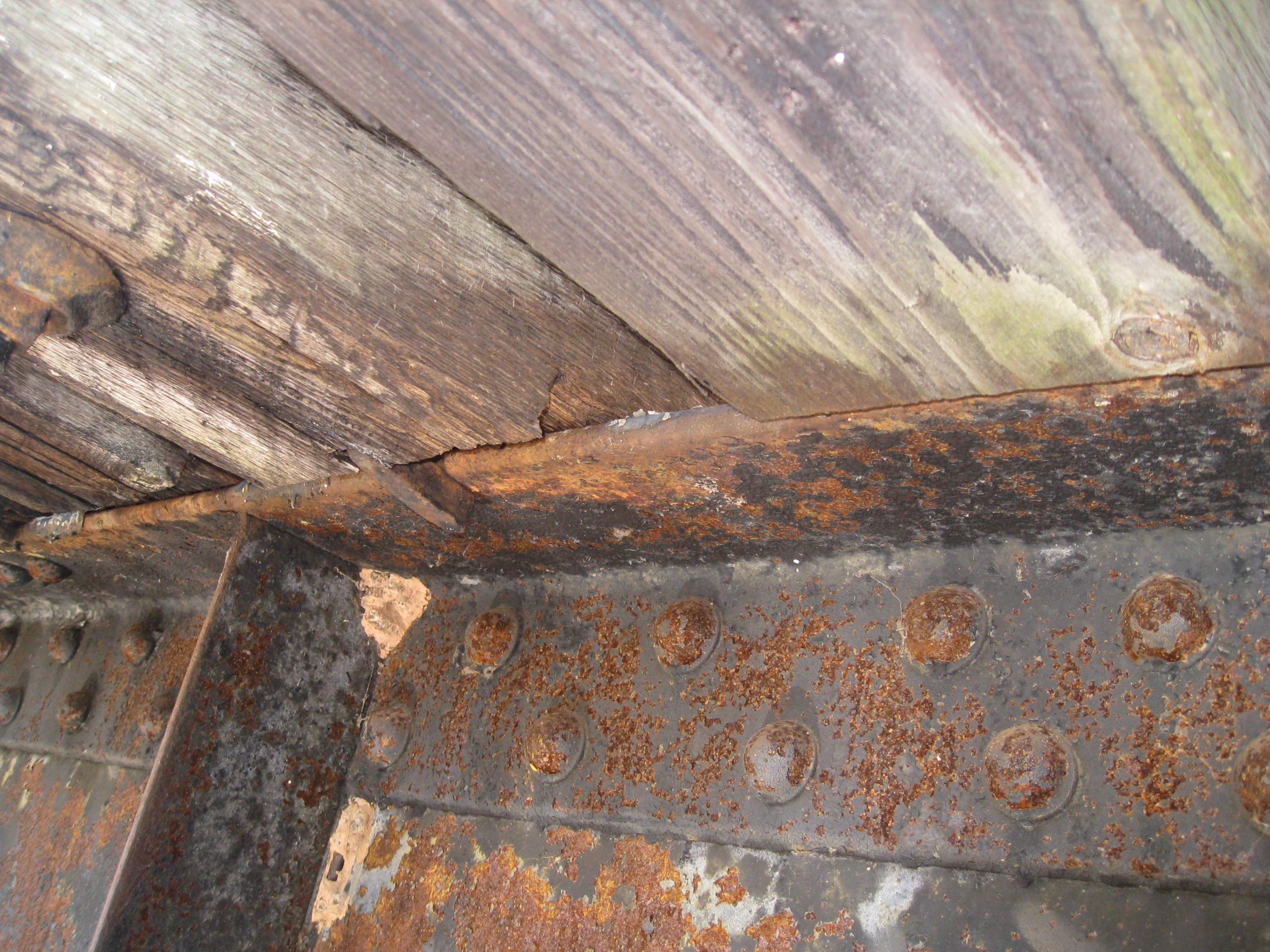

I was able to get new pictures from underside of the bridge. Looks like they just notched them and the ones that were longer (for the walk area on one side) they used a Spike and just bent it over.

By the look of those, they really subscribed to the "Things don't fall UP" theory.
Personally, I wouldn't take the time to do the notching. Lay the new ties in place, drive in a galvanized lag bolt with a LARGE washer tight to the outside flange of each beam so that the side of the washer clamps onto the flange of the beam. If you can't find suitable washers, you may have to make up some steel plates to do the job. Yes the washer will sit crooked once the bolt is tightened but not a huge deal in this application.

With the beams being at 8'3" out to outside of flage it only leaves and 1.5" over hang. So i was thing lag bolt like you mentioned or getting some simpson plates screw them down to the RR ties and bend the metal over the flange on the beam. Kind of like a "Z" shape.

McMaster-Carr has tapered washers for use with channels and other structural steel shapes with a tapered flange.
