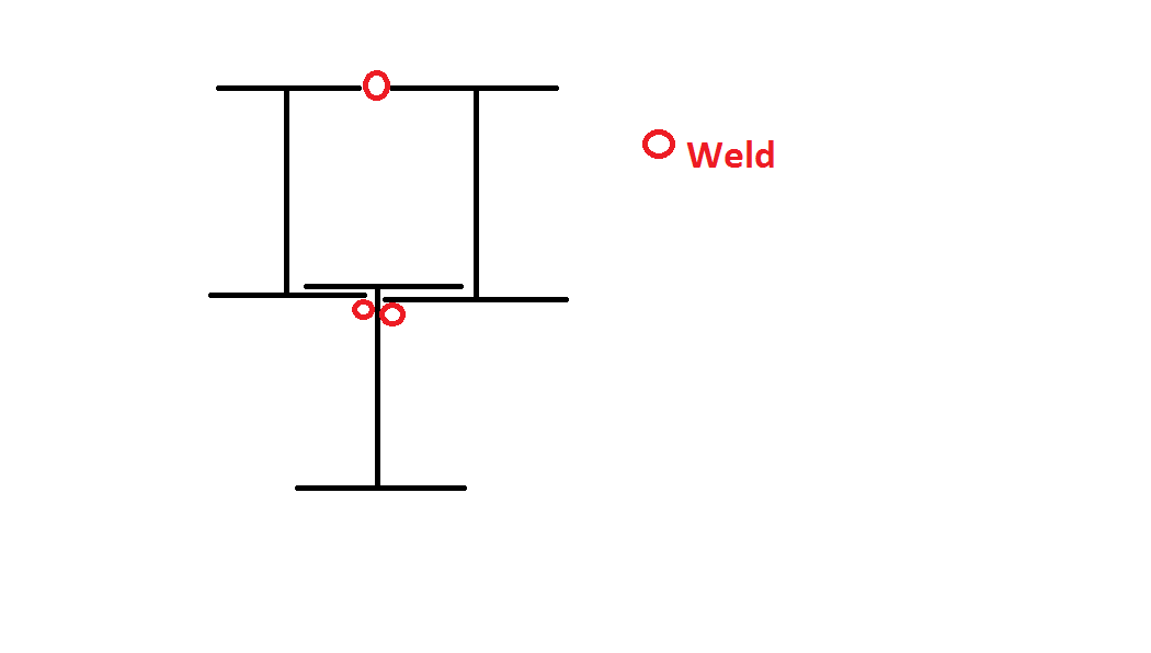

S12x35....30' long but he has 7 of them. I dont normally like S-type beams for long spans as they are too narrow and easier to twist or deflect in the horizontal direction with a single beam span and no flooring or nothing tying in multiple beams. But I have a crazy idea about attaching 3 of them together. Look at the picture for a cross-section:
Being two wide would solve the problem of S-type beams being weak in that direction. The bottom beam to gain depth would "probably" get the strength I need, but cannot find any formulas for stacking beams. The bottom beam would actually be about 1' shorter on each end, as the top two beams would extend and set on the "truck" that is riding on the rail.
My gut says this would be a sufficient setup, as overall depth would be 24" and plenty heavy. But the best part is this would cost me under $500 , and I could set them in place a beam at a time
Thoughts, Opinions, Am I crazy?

That looks like a TON of work. I would rather just take two beams and stack them I think.
It is a bit of work, but you would just make a template to cut a few feet, then reposition. And it wouldn't add any weight.
It would be quicker to just add a square tube to the top. Would help with torsional rigidity too.

LD, maybe I missed something but you said "It will have 12' of run, the a push-trolley on the 38' span" Why don't you turn the design and make the 12' span the bridge and put your posts in the other direction so that you can use smaller material all the way around??
Also, your deflection calculation is most likely going to control your beam design as long as their isn't a localized failure in the flanges of the beam due to the high point loading from the very small trolley wheels. Also, don't forget that if you have to much deflection center span, that the beam could potential rotate off the running gear at the ends or at the least bind it up. Also, don't forget to look at lateral torsional buckling when you get tall slender sections.
