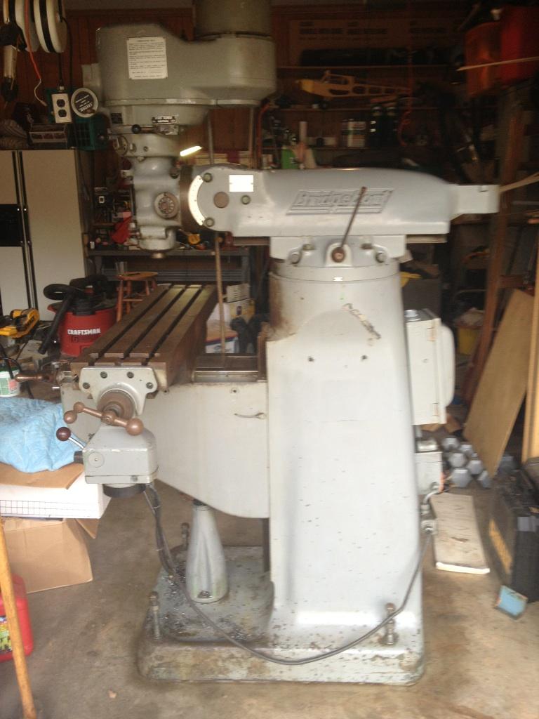

THanks, I re-read that advice. How heavy is the head when I flip it over? I was told I can loosen the bolts, then flip it. Can one person hold and guide the head as it rotates? Is there a trick to that?
You angle the head by loosening 4 nuts and then turning a separate screw. That screw is probably a worm gear in there that not only angles the head controllably but keeps the head from flopping down. On mine, that screw gets harder to turn as the angle approaches 90 degrees so using your other hand to take some of the weight off the head seems to help. As others have said, flipping the head 180 degrees lowers the center of gravity and it may be helpful to crank the table up to support the head. I like to keep the table as low as possible too so if you bring a stack of boards to use as shims, you can keep the table low and still support the head.
Sorry if this was obvious.
   / Bridgeport Mill ??? Should I jump on this?
#44
Well, I bought this mill tonight. Thanks for all the advice. I rotated the head and moved the bed as you guys suggested. I used pipes as rollers and a come along to apply force. It was a little scary but everything went ok. Loaded it onto a lift gate on a rental truck and brought it home and unloaded it. I will clean it up and take some pictures. It looks really nice. The seller used it at his work but it's been sitting unused for 5 years. I appreciate all the input

   / Bridgeport Mill ??? Should I jump on this? #46
Congrats on the purchase. I dont know how much you paid for it, but in the one pic, it didnt look like it came with any tooling or a vise. You will easily spend twice what you paid for the mill for a vise and some basic tooling.

   / Bridgeport Mill ??? Should I jump on this? #50
There's a lubrication point about head high on the right hand side behind the quill power feed selector that may or may not have a zerk in it. They are only supposed to be oiled there, not greased. If there's a zerk there, take it out and see if there's grease behind it, if there is you will have to clean it all out. You can see in this pic the little right angle Gits cup that it should have. Not all have the zerk but some do and only The Flying Spaghetti Monster knows why. From what I have been led to believe, the zerk was originally to be used with a pressure gun that was filled with oil, not grease. My BP clone has the zerk and I have to take it out and squirt oil in to lube it...too lazy to fix it right, eh? :embarrassed: BTW, $250 for a BP is definitely gloatworthy!
