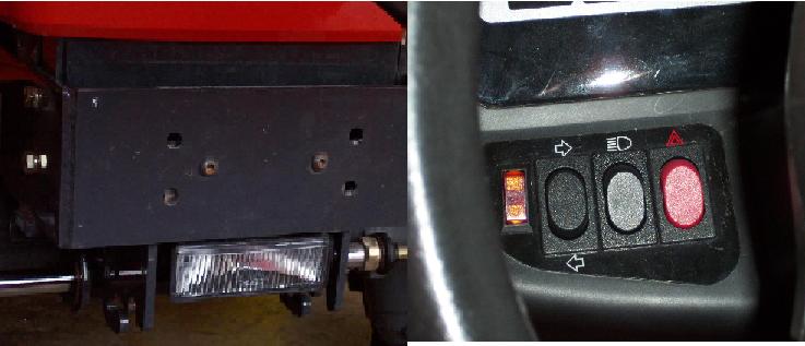

   / Brighter Headlights BX2200 #23
I too wanted to be able to see under the bucket in the dark so I mounted a single rectangular light under the front of the tractor and added a switch next to the other switches on the dash. I used some sheet metal bent on a 90 degree angle to mount the light to, and then used holes that were already in the frame to mount the sheet metal to. (See Attachment)
   / Brighter Headlights BX2200 #24
That would work for me too - what kind of light did you use? Looks like a fog or backup light
