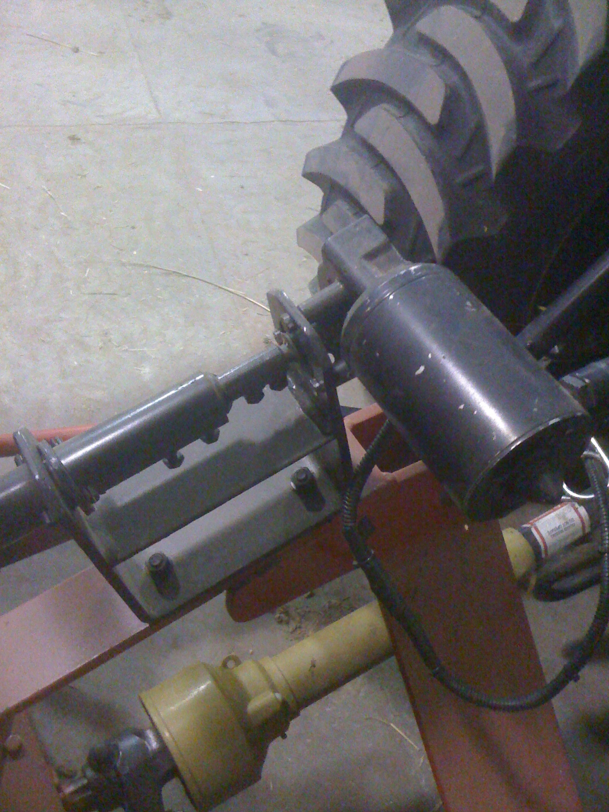

JJMarotz, How do you keep it from steaming up on the inside, or snow off the outside? Do you have a heater in the cab? Also, I am interested if your blower came with the electric chute control, or did you build that yourself?
/ Bring on the snow!!!
#9
The gap around the top between weatherbreak and the canopy provides enuf air circulation that I have never fogged up. No heater, just the heat from the engine blowing back keeps things semi warm. So far I havn't had a problem with snow sticking too bad on the outside.
The chute rotator was my build. It came with a hand crank, which quickly got replaced with that little 12v motor.

JJ - Nice job on the electric chute rotation. I just picked up a snowblower with manual chute and want to do the same. Any info on how you did it - e.g. what motor and bearings, where did you get them, etc - would be greatly appreciated!

Thanks. The motor is similar to this one.. Reversible Electric Gear Motor 12v 50 RPM Gearmotor DC - eBay (item 220513251140 end time Dec-19-09 09:44:29 PST)
I did manage to find it cheaper than that one, but same thing. No bearings were used. I made 2 different sized sleeves to adapt the motor shaft to the original hand crank tube. And the motor is mounted to the blowers original handcrank bracket, that way if the motor pukes out on me I can remove it quickly and reatatch the hand crank.
