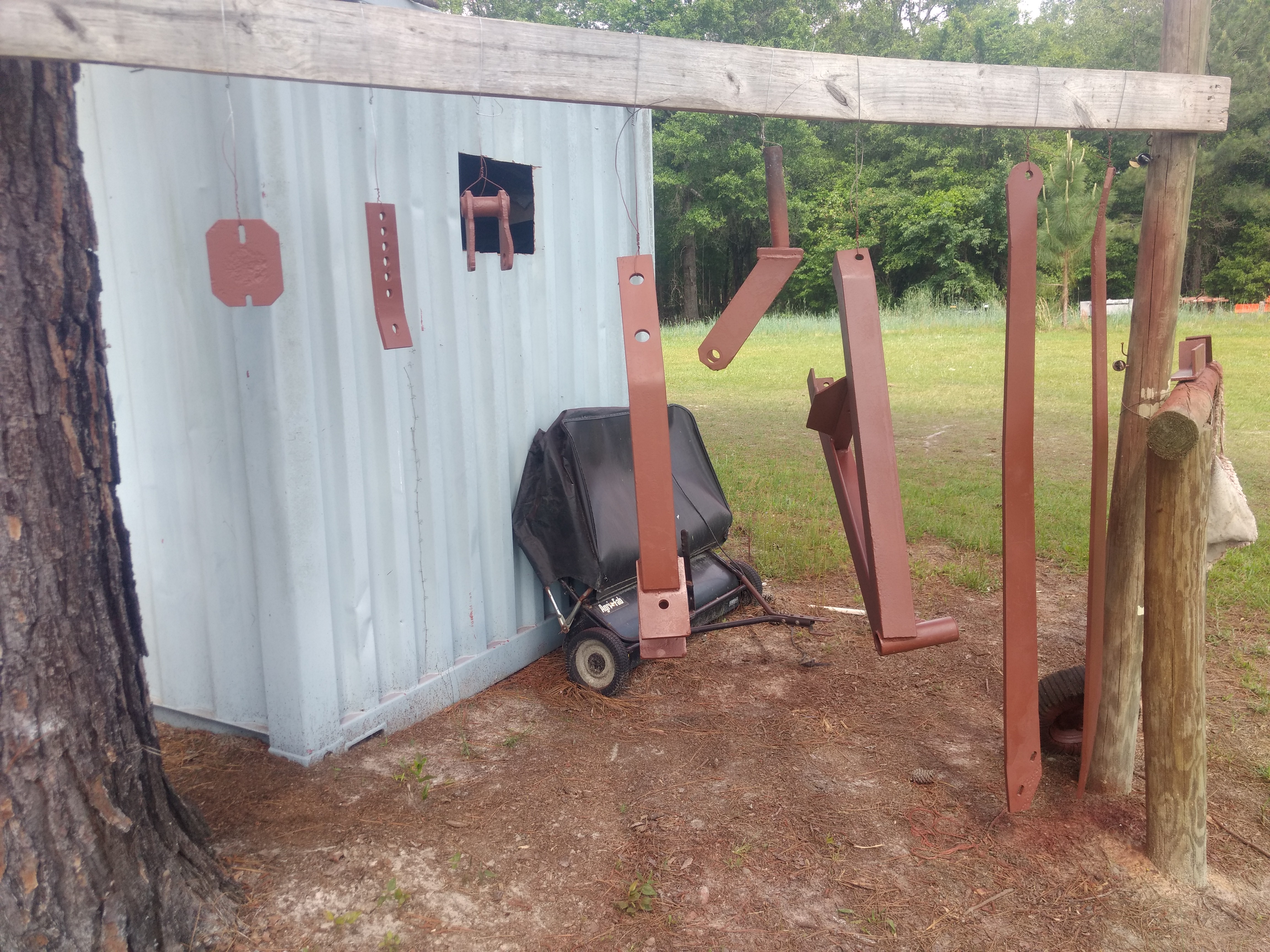

Second coat of primer applied 2 days ago. Still soft so maybe Saturday it'll be hard enough to apply the top coat. Paint definitely takes its time. I could possibly go ahead and put the top coat on but the paint manufacture says wait until you can't leave a fingernail mark between coats.

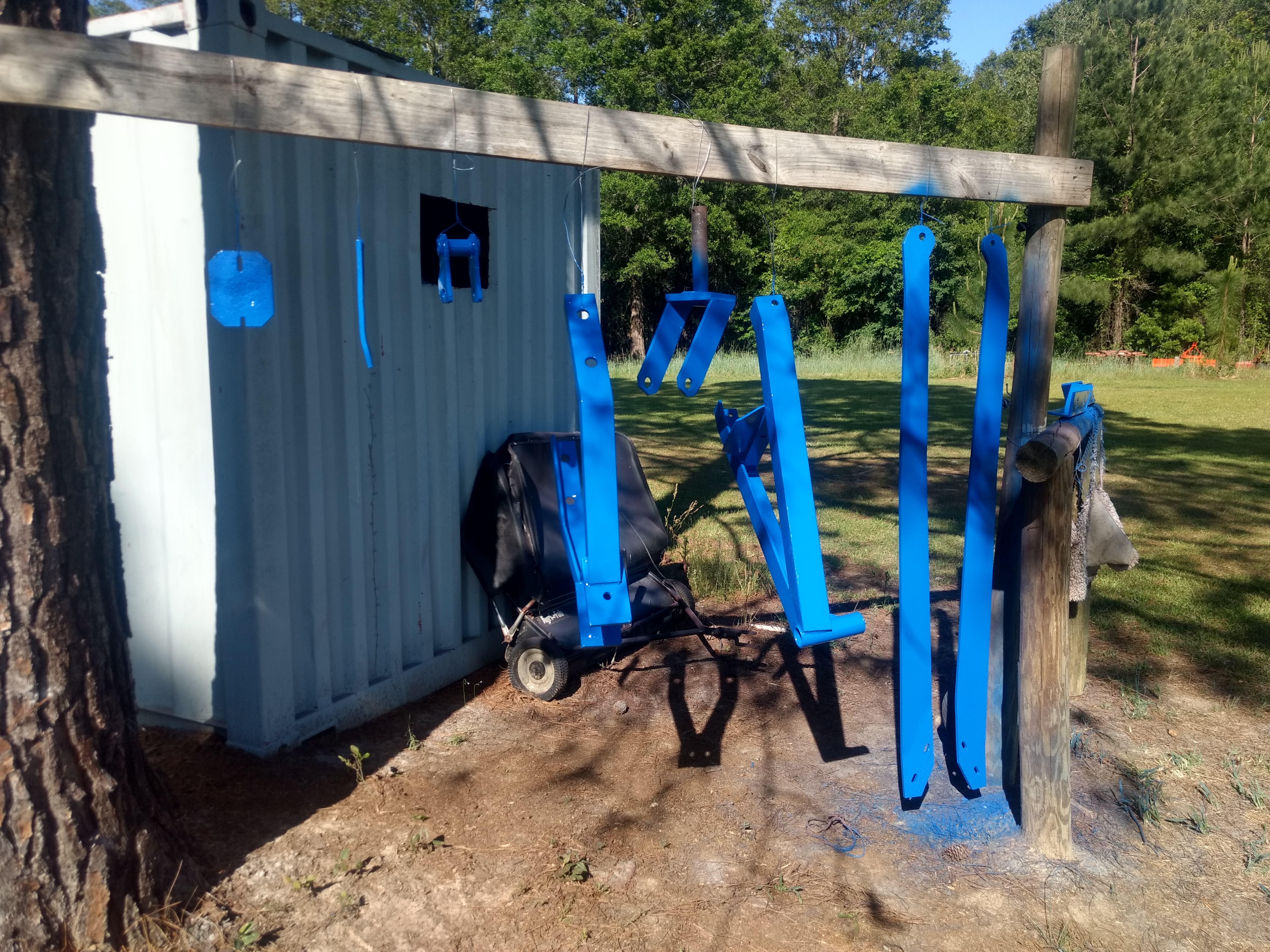

Have the second coat of NH blue on everything, going to put one more coat on and call it good then give it a week or two to harden before I reassemble it and that'll give me time to go get all the new bolts. I will say the top coats with Hardener dried much faster. I was able to recoat the next day.

Appreciate it, I'll add the final pictures after I get it reassembled with before and after shots. I think it should have a long lasting life now.

That looks great! Was the primer brush on or spray? What type of paint did you use?
   / Bringing new life to the Rotary Cutter
#19
1st coat was brushed on, we went through a spell of high winds for weeks and doing this outdoors it was to windy and some rains we're forecasted after I finished prepping it so I had to get some primer on it. After that everything has been sprayed. Using Majic's tractor & implement paint (1st time using this brand) being the only one I could find locally that color matched my NH.
