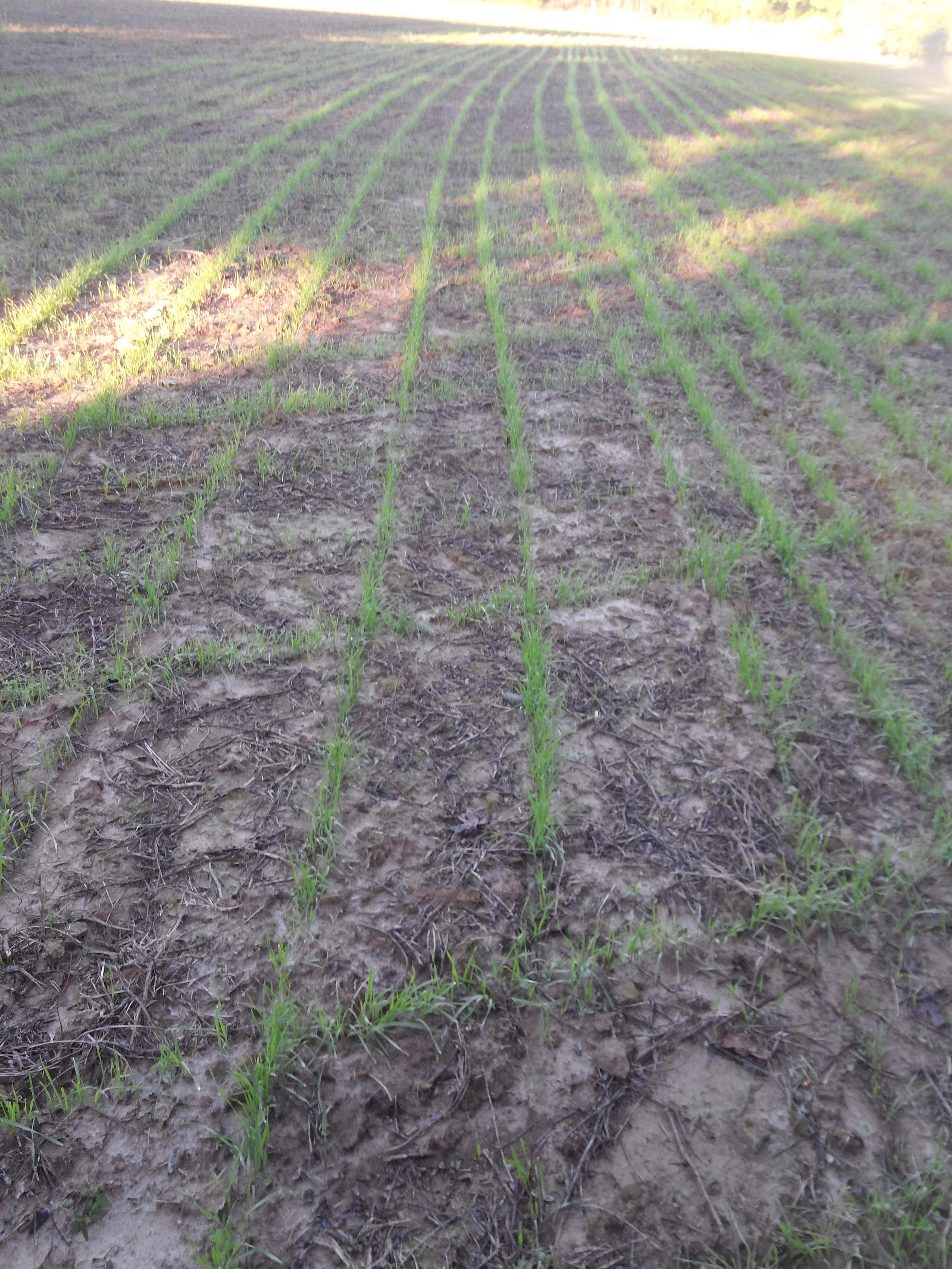

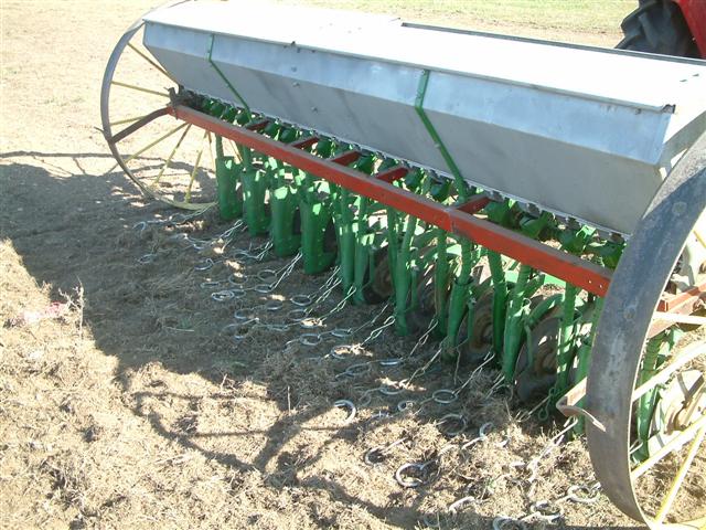

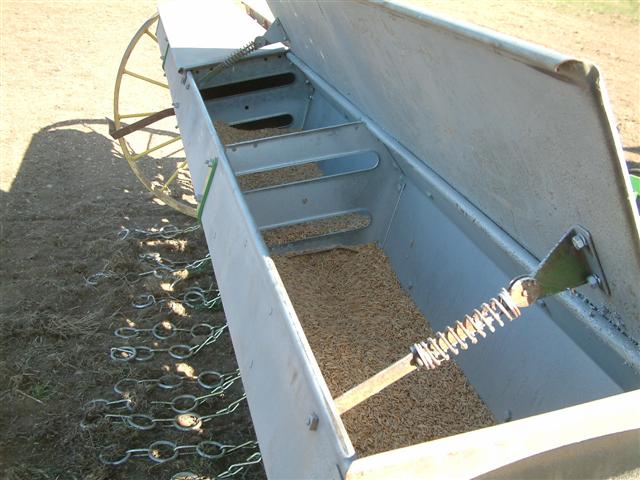

I bought two old Minneapolis Moline P3-6 grain drills (10 ft wide, 20 drops, single disc openers) from a neighbor for $275. Used the parts from both to make one good drill. Added a hydraulic cylinder to raise the openers out of the soil while making turns. Total cost: less than $500.
Here's a couple of photos of Kanota oats planted with that drill.
The drill plants in rows separated with 6 inch spacing. If you want a solid stand with 90% germination you need to consider something like a Brillion grass seeder. You can rent these sometimes at county ag agencies. They show up on eBay regularly. A 5-fti wide Brillion goes for $3K or so.
