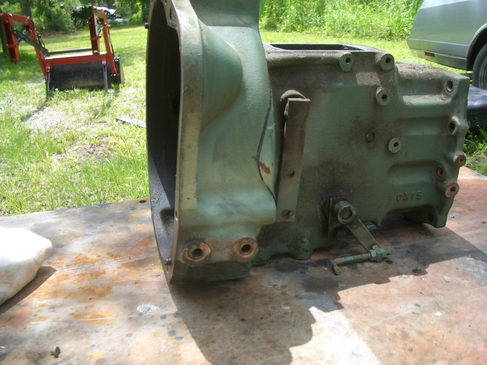

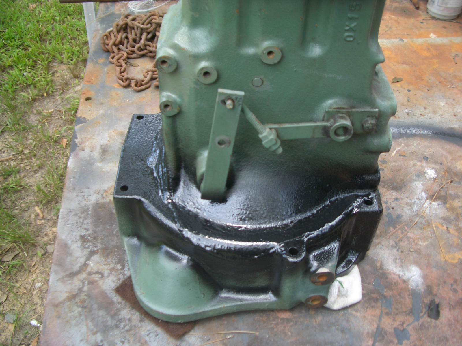

Bulldog or V2 loader?
Did this have the recommended loader subframe tied to the rear axle?
Koyker 80, and no it didnt. My buddy who is welding it for me says he has it all back together. He said it was a real pain. so ill show an update later. Id still like to find a replacement though, since id be leery of re-installing the loader with it welded.
   / Broke Clutch Bellhousing
#12
I thought it might have been,
I wonder if the same housing is use for any other YM CUT models in similar size? Is there any No# to be found on it?
OX15 is the only thing on it.

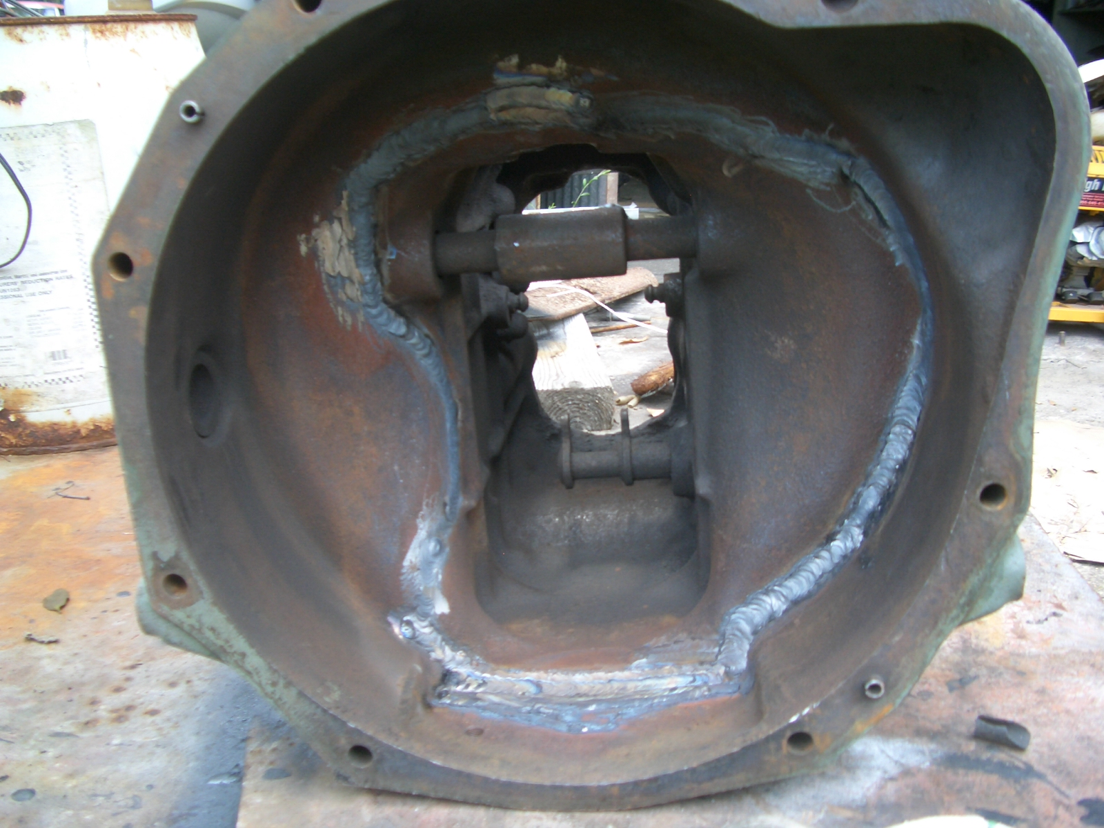

Its not pretty, but its back together. Still haven't had any luck in finding a replacement so this will have to do. wish me luck.
   / Broke Clutch Bellhousing #18
That looks great he did a real nice job! I wouldn't be afraid of it at all but remember what caused it though and Id get him over to help you fab some good braces and you will get another lifetime out of it. good luck :thumbsup:
   / Broke Clutch Bellhousing #19
WOW!! That looks Great! I agree Brace it up looks can be deceiving Esp. on just Pics. Should be fine IMO. Esp. now you know "What Not To Do" :D
