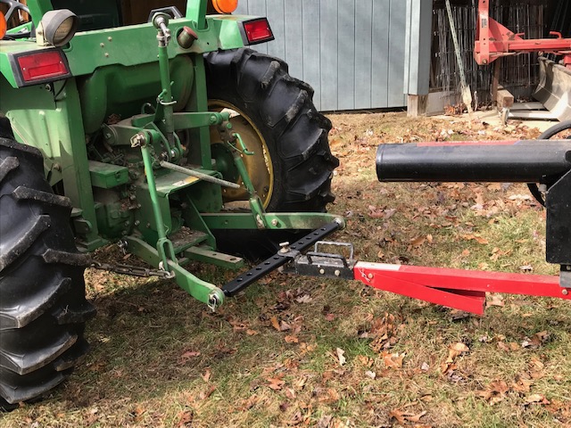

The one issue I see is I'll have to watch carefully how sharp I turn, or modify the hitch on the splitter. The narrow mouth works fine on the drawbar where it can rotate freely, but can easily bind on this thing.
Could you just unbolt the current end of the tongue and replace it with a standard ball hookup?

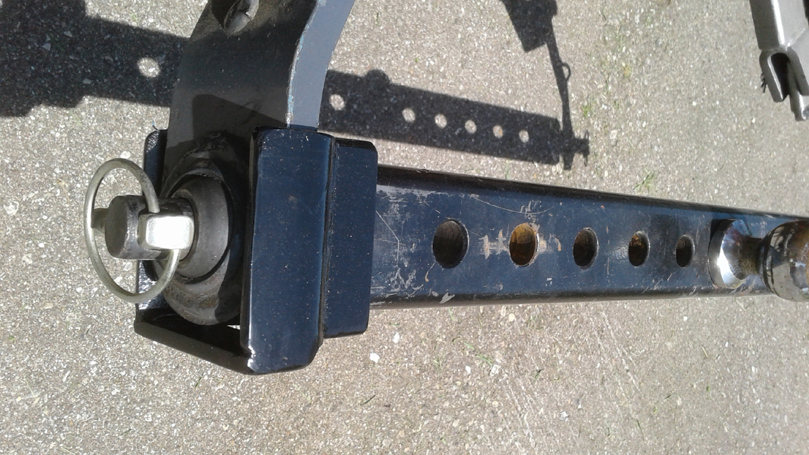

These drawbar locks are a must. I've used this type of drawbar over they years and these little clamps solve lots of unsolvable problems before they occur, especially if working in the woods. Plus, there's a little fab time in making one. There's a store-bought one out there for maybe $20 but it doesn't work correctly and doesn't last very long. Make the one in the picture.
If you have the right size clevis, you can use a clevis as a drawbar lock, put it over the lower link arm and pin it into the first hole in the drawbar.
Aaron Z
Sixdogs,
I like that solution and was about to ask whether you used one on the other end of the draw bar when, I noticed the shadow of the other end.
   / Broke Down and Got One of those Fake Drawbars :-( #28
Aaron Z
I like that solution, too.
Doug in SW IA
Doug,
Yes I could. In fact it came with a ball hitch and I replaced it with this one so I wouldn't have to fool with a ball.
But if I did I'd have to get some means to prevent the bar from turning as several have mentioned here, and install it every time I want to hook up the splitter. I'd rather fix the issue by modifying the current hitch and not bother with all that. Seems much easier on an ongoing basis to me.
