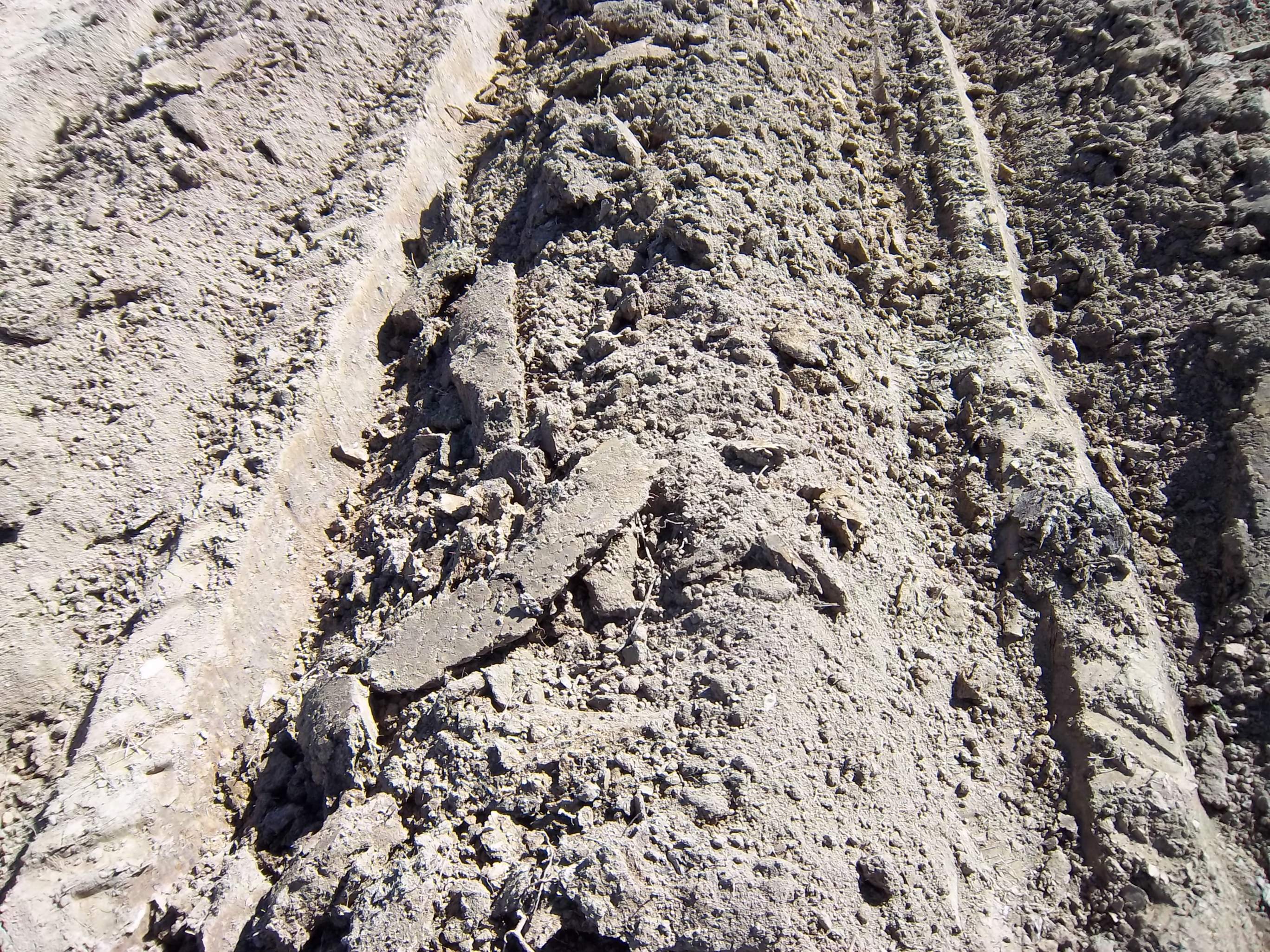

When you work soil, if it is too wet, clay based soils will compact easily and will clod. The makes irregular shaped bricks out of the clay content. If they were perfect rectangles, you could fire them and build a wall.:)
Working the soil until it crumbles into fine is a matter of hitting it when the soil moisture is just right. I'd recommend you might consider dragging a spike tooth or spring tooth harrow over that ground before trying to plant. Once the clods are formed, it can be difficult to find that sweet spot of not too wet and not too dry when the soil will crumble.
It is also a sign of inadequate tilth or humus composition of the soil. Next fall, generously apply as much compost as you can muster and till it in to integrate over the winter.

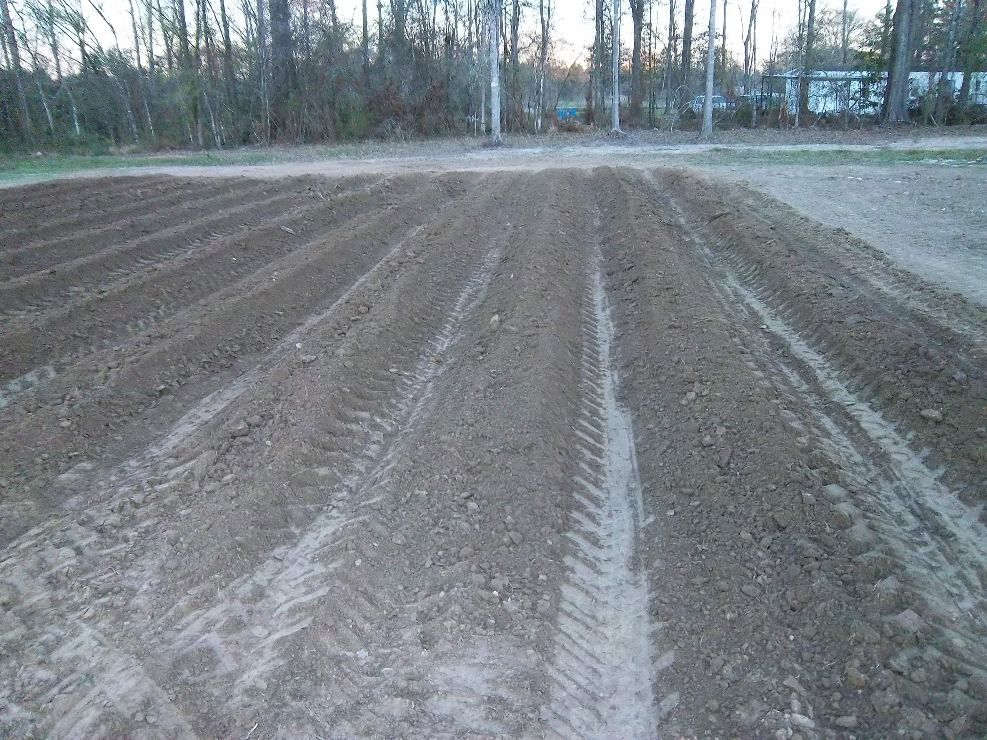

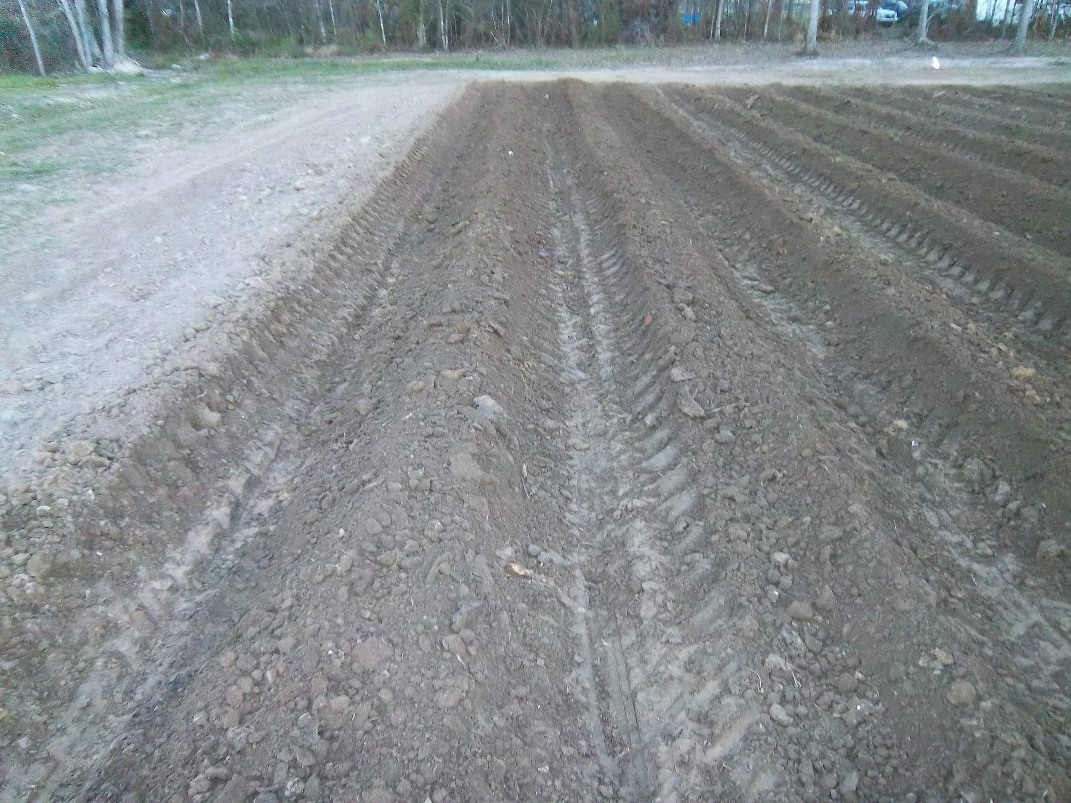

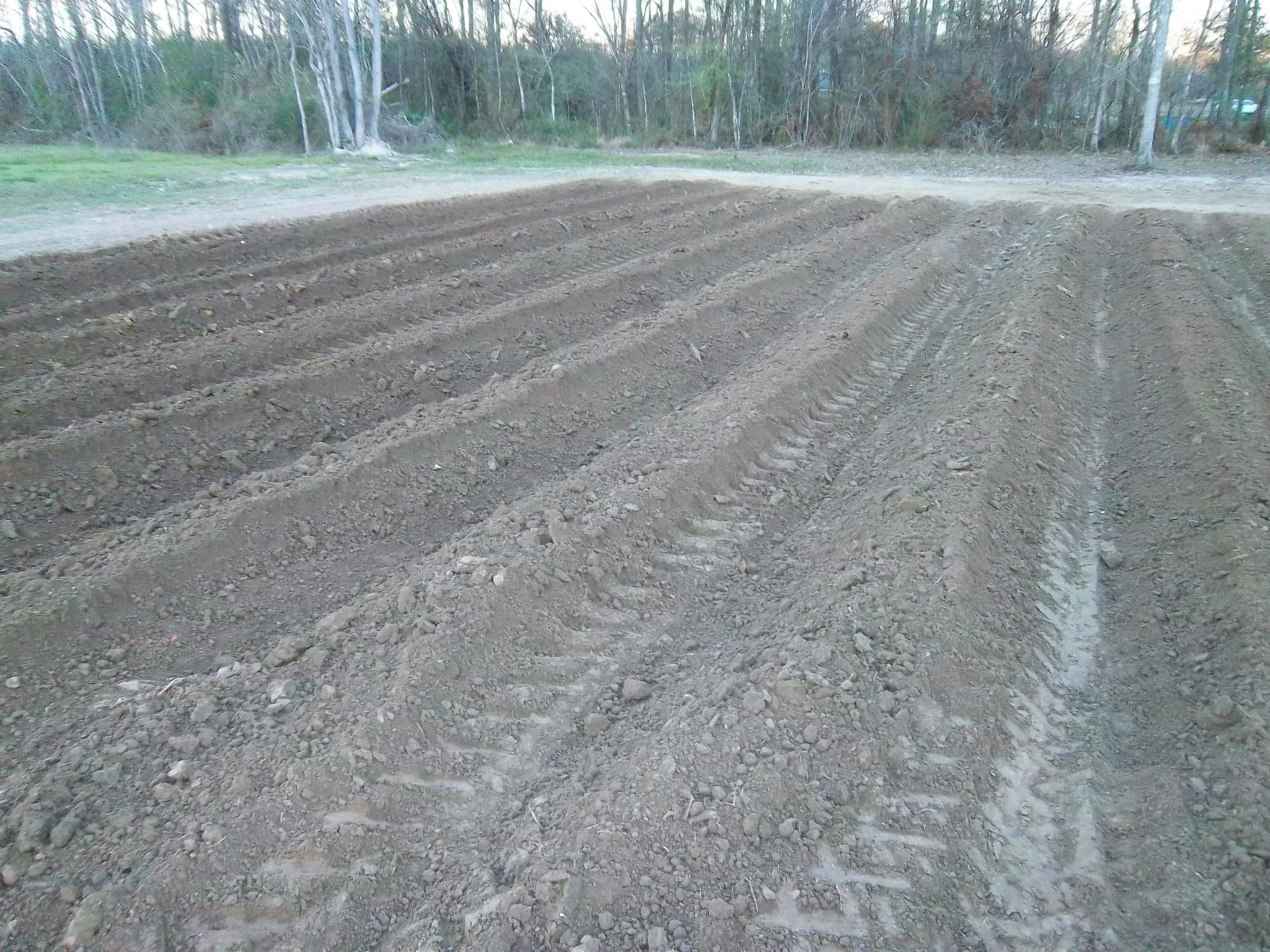

Ok, the rows are finally completed!! I'm satisfied with them. There as good as they gonna get for the Spring of 2011...
Got 14 rows about 80 ft. long. Planted a row of red potatoes yesterday, and planting corn tomorrow.

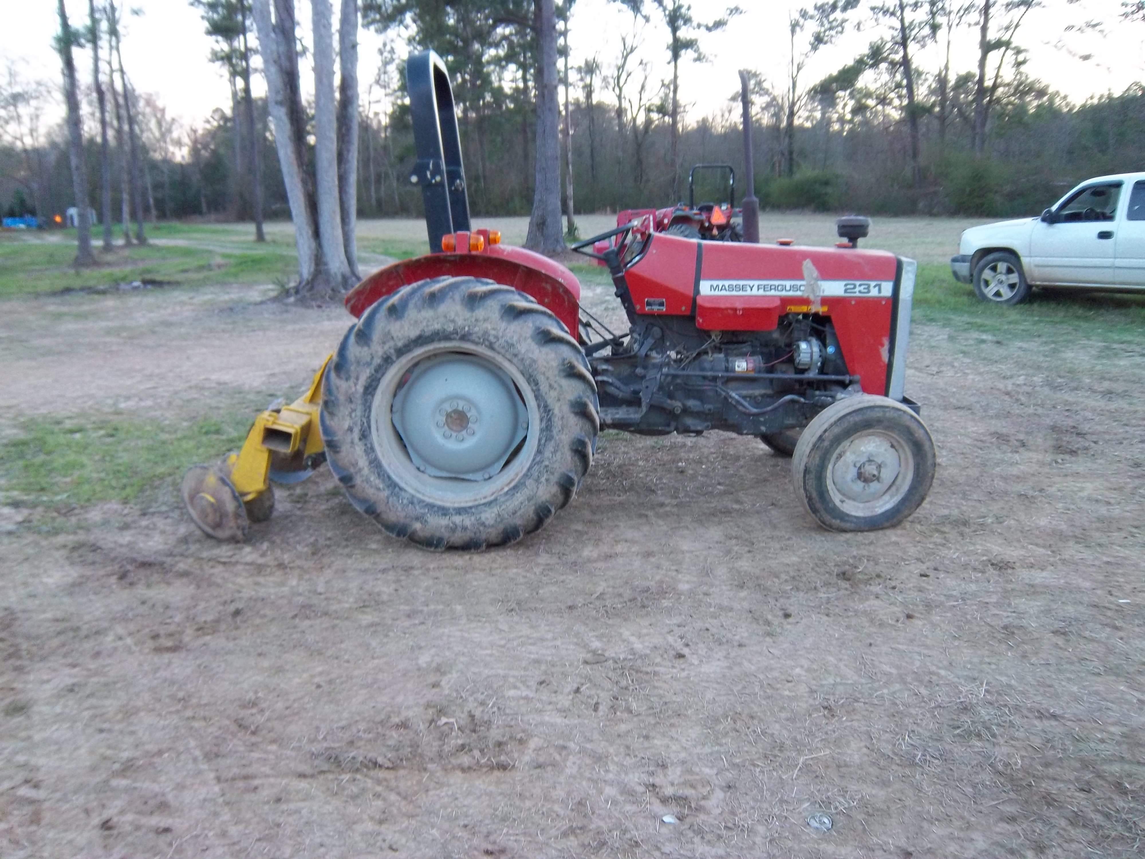

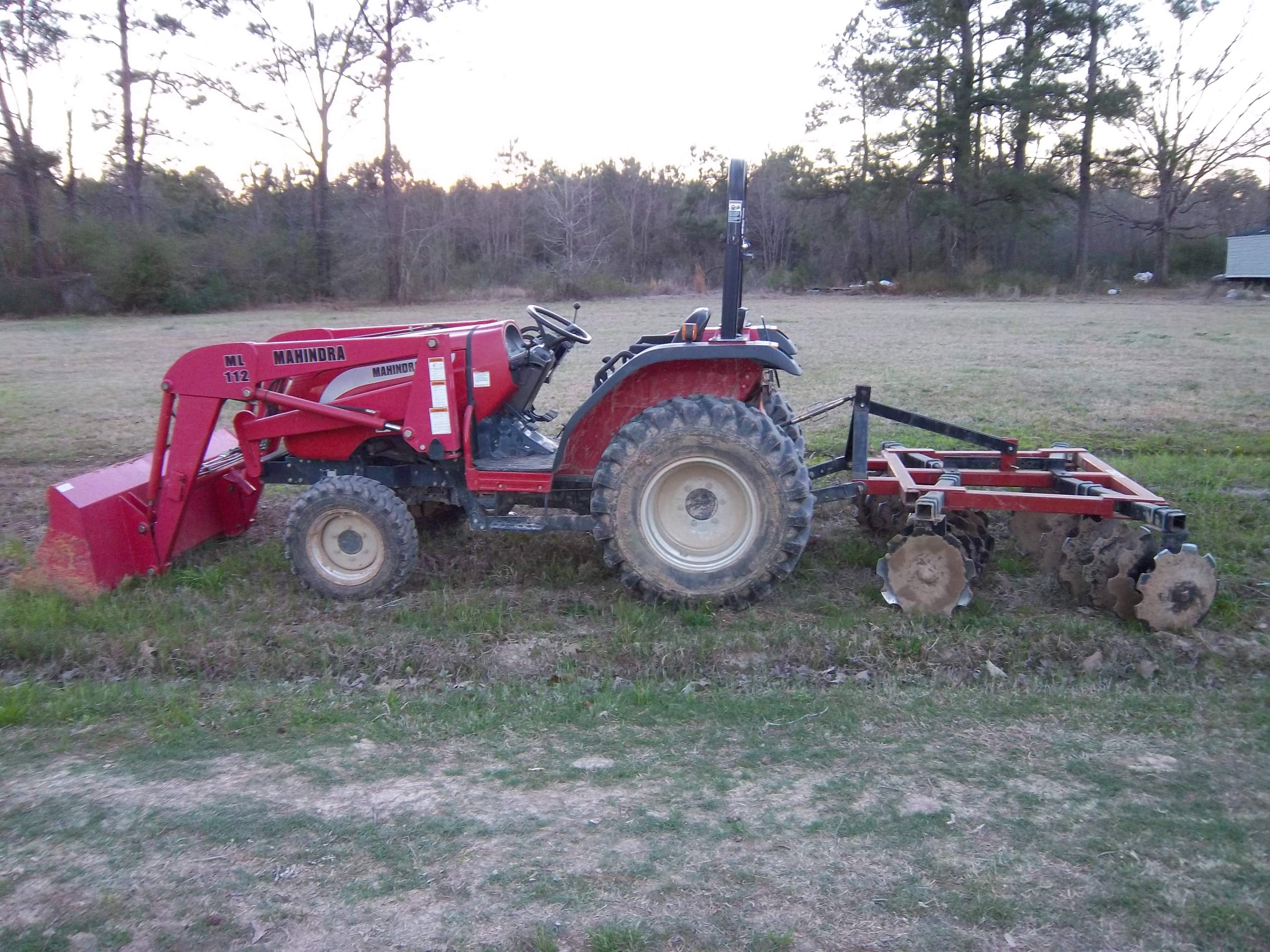

The problem with the row disks was I had them set way too agressive, causing them to cut way too deep! All I had to do (after I got someone there who knew) was to make the toplink short as possible and not let the hydraulics (lift arms) go all the way down. A friend of mine that I've known all my life (and who lives close by) brought his Mahindra 3510 over and we put my disks on it. I had the row hippers on my tractor (he seen how aggravating it was with me having to switch the 2 implements back and forth). We disked and disked and made rows, disked some more and made more rows! Finally go it though and yes, that clay is HE**!!
Anyway, we got it all done and I took a few pics. Will take more pics tomorrow.
**NOTE: THE LAST 2 PICS OF THE ROWS YOU SEE ARE PICS OF THE PROBLEM I WAS HAVING, NOT THE FINISHED PRODUCT. ALL OTHER PICS ARE THE FINISHED PRODUCT.**

Looking good!!!! That soil looks rich. good job.
