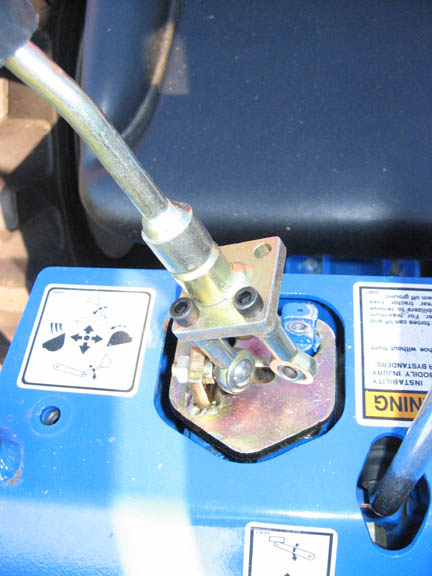

Grim,
Thanks for your suggestion. However, I went to check this out this evening to see if it would work for me and I don't see how it would.
In the attached picture it shows the plate in place (still not bolted in, just laying there). I know you know what this looks like - this is for the benefit of others who just like to look at photos.

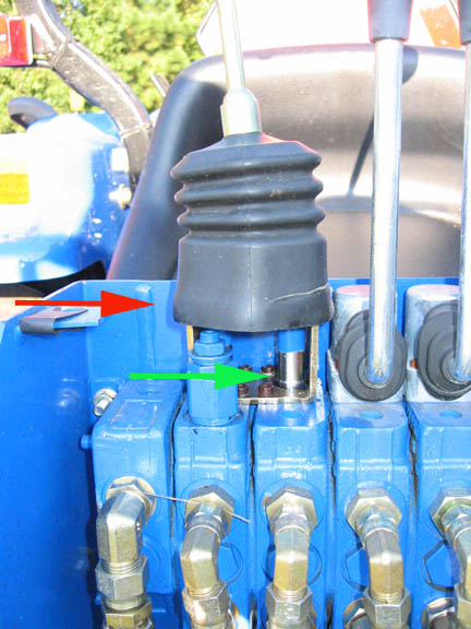

Then, when I pull the rubber cover off, this is what you see:
   / Broke My Backhoe
#14

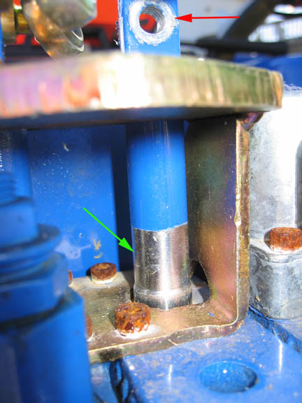

Now, I want the oil applied at the green arrow, which is not accessable with the cover on, unless I squirt it somewhere arounf the red arrow and let it drip down.

Because I have a pretty skinny tip on my oil can and it won't get between the cover and that gold-colered plate.

Also, with the cover on, I can't get the rubber to stretch and snap over that flat plate. Well, I couldn't do it easily. Just gave it a quick try to see if it would just pop back on. Maybe with a little more effort I could negotiate it.
Obviously, your experience is much greater than mine and this approach works for you. It sure would be easier your way than mine.

<font color="blue"> If there was "stiffness" in the control it may not have been caused by lack of oil. The "ball" in the socket has a plastic liner which, I suspect, may have been the cause of the stiffness </font>
Actually, the little ball thingy moves easily in the socket. No arthritis here. I tried to manually lift and depress the valve after applying some oil without success. Then I gave it a couple of light taps with a hammer. This allowed a little oil to seep in and since then the valve operates smoothly. But in the future, I'll be sure to do an arthritis check if oil doesn't do the trick.

Thanks - pics good (worth 1000 words & all that). Carefully looking at them, the 756c looks set-up similar to the 758c I have, but there is a little difference. You are trying to let oil dribble down around the plunger rod which goes into the hyrdaulic distribution block. On mine, squirting from the top (above the cover plate in the crack between the rod/cover) let's it dribble down. If you sprayed/dribbled/dumped it from the small opening between the rod & cover why wouldn't it cover it adequately (soak in around the plunger)? I wouldn't think the oil would damage anything - you get hydraulic leaks anyway. I notice some of the nuts are even rusty - given that, I might even just "pour" it in, but that's just me.
Anyway, the few times I have left mine out I covered it with plastic tarp. A small one over the control panel would keep direct water out of/off the hydraulic block. Glad you arn't having "arthritic" problems - wait till you get older! The plastic in mine (ball sockets) was chewed a bit.
