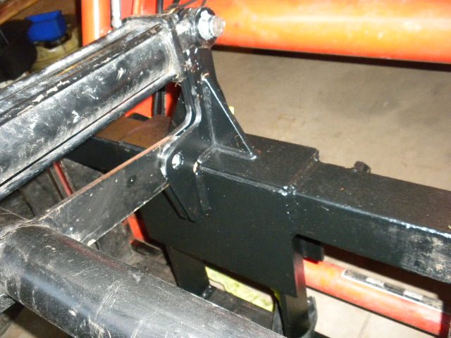

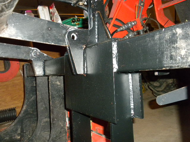

I had the same thing happen! The cylinder mounts and top of the box member tore off. I don't know how the crack started but it looks like it propagated by fatigue and followed the weld heat affected zone (where the cylinder mounts were welded to the box member). My box member was just a shade under 1/8 inch thick.
I boxed the whole area(front, back, top) with 3/8 plate. The new plate is welded to the old box member and to the 3/8 tines. I cleaned up the old cylinder mounts, milled 3/8 off the bottom and welded to the new 3/8 top plate. The jaw opens and closes pretty fast so I am going to add a restrictor to slow jaw movement.

Looks like that will be a good and quick fix. Stuff happens.
Agree-looks like a good fix-and NickelPlate. I don't think its junk-rather as Wildkat refers to it-a "48" ECONOMY model. There are plenty of Wildkat 48 owners on this site so this is a good lesson for all. I wonder if an inexpensive bit of "prevention" might be to weld a 1/4" 3 x 3 angle to that box beam and then weld gussets from the 3x3 angle up to the verticle pieces that hold the cylinder????

Looks like your attachment points are also pulling against the thin wall tubing. Looks like PP design to me. Built cheap to sell cheap. For $50 more they could have put 1/4" wall tubing on that main frame or even 3/8 for much better strength. Why have 3/8 or 1/2" tines attached to 1/8 tubing and doesnt look like it has a scab plate to spread the load across a larger area like it should have
Are those in fact 1/8" tubing/main frame? If they are what hp rating are they good for? 25-30 hp maybe? I'd be afraid to put that on my loader, the 400x would turn that into dust. :(

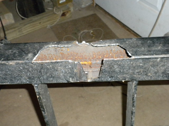

Well, user error caused my grapple to break. I was pushing over trees while making a food plot in my woods. I did not see that I had the grapple tilted too far down and the center tooth on the jaw of the grapple contacted the tree before the bottom tines. When I pushed the tree it put too much stress on the jaw and it punctured the top rail of the grapples box tubing like a can opener.
I found out that the grapples box tubing only has an 1/8" wall thickness. The grapples box tubing is 3 1/2" square. I took a piece of 4" square box tubing with 1/4" wall thickness and cut one side off. I plan on cutting off the cylinder bracket and sleeving the original box tubing with my new piece and then welding the original cylinder bracket back on. Any thoughts?
Just re-read everything. Wow, that doesn't appear to be user error to me. To be frank I looks like a cheaply made grapple. 1/8" thick framing is plain crazy.
What hp tractor are you using with this thing? I do realize it's the economy version but come on. Anyone know what hp they're rated to?
