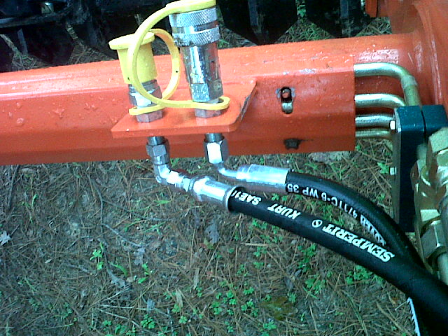

Update - I found a Parker Hannefin shop. He cut off the busted connector and put a 90 on it, and I bought a new line just like it had been, with a 90 on it. I also bought a 90 degree fitting for the other line. They SHOULD route together no problems. I also bought more heavy black tie wraps
It was too late when I got home, and too dark outside.
I will install the new line and the fitting tomorrow and reprot back here with pics and status, probably after work though...

Update 2 - After breakfast (my meetings for today changed and I'm working from home) I dashed out and partially fixed my grapple hyd situation...
As sugested by SSdoxie, I changed this to 90 degree connections so they do not stick out as far.
All I have left to do is finish routing and tie down the Hyd lines, and reconnect the quick connects for the tractor end, and the grapple.
It started raining, and I needed to do some work-work so I will do that likely after lunch.
So... Any thoughts on this setup? Does it look good?
PS - I noticed that the paint was rubbed off by that same cedar that hit the line...

Looks good David, did that cedar knock off the nut that holds your hose guard plate to the crossbar or did you take it off?
