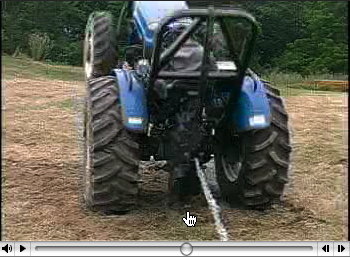

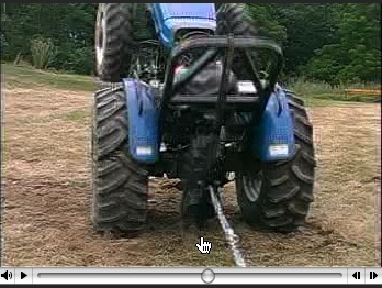

Willl:
Take a look at this this movie http://www.mne.psu.edu/sommer/projects/tractor/tractorFY1/videos/rear2.mpg , which is from the Safety Forum on TBN, and then look at the two frame grabs from the movie I have attached.
Just above the pointy finger you can see the shiny metal of the drawbar in one of the grabs, and in the next, it has buried itself in the ground. If the chain had been hitched to the end of the drawbar with a clevis, somewhere between those two frames, the overturning torque on the tractor would go to zero, and the incident would be entirely survivable. You can see from the angle of the tractor that it would just sit itself back down on all four wheels if the chain were properly attached.
I have to agree, it doesn't look like this is going to happen if I just eyeball the drawbar on the tractor before the test, but this is one of the reasons why manufacturers hire engineers.

When the tip of the drawbar is on the ground, the height difference between the attachment point and the bottom of the rear wheels is zero, which means there is no overturning torque. The operator will get the scare of his life, but good mechanical design will have saved him.
You could have just said, the drawbar works as a wheelie bar!
