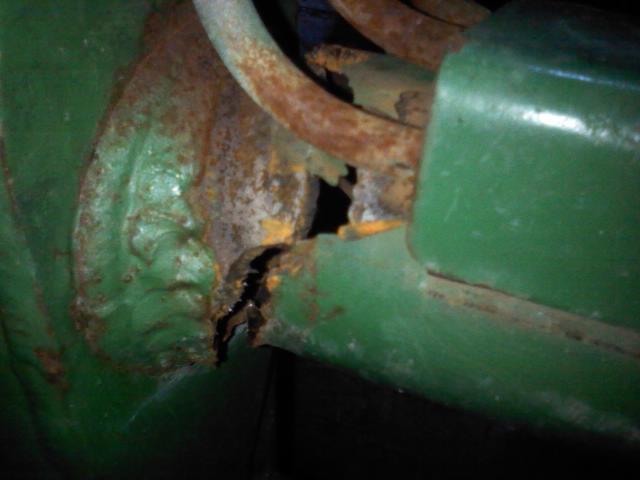

I was using my machine this weekend and I broke the pipe like support that holds the two loader arms together. This is the same piece the hydrolics are attached too. What are my options to repair this? It looks as tho I could just weld a new pipe on its place. Any ideas or has anyone ever seen this?

Yes you can weld the tube....you might have to cut out the damaged
section and put a sleeve in there before welding so that the repair
will be at least as strong as the rest of it. That is how I do my critical
structural members (like roll bars).

If you sleeve it make sure to drill holes in the sleve pipe. Them you can weld the ends and then weld the holes shut. It helps spread the load.

I have never posted a photo so i hope this works, its not great but I took it in the barn this morning on my way to work. There is some surface rust, but the steel is still in good shape. Just thought a few of you would want to see it.

Did you buy it new? Looks to me like that end has been welded before...

I did not buy it new, I did notice that also, but both sides look the same and I cant see any paint seams. Even if it had been done before it didn't break at the weld.

That's a pretty rusted & busted up piece. Is the picture of the dash in your avatar from the same tractor? 3.5k hrs is a lot of work time on a loader.
