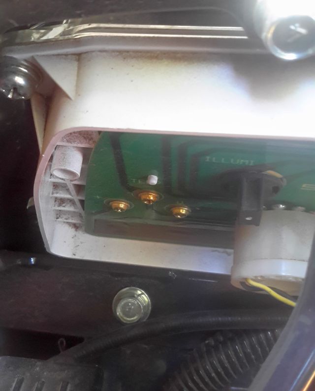

:mad: Only 25 hours and it's already broken:yell:
Mowed all day and temperature never showed above cold mark, where gauge shows even when off.
I checked the connection on top of the motor, the fuses, and under the dash board. All looks good.
Called the dealer, waiting on call back.
Not really mad, yet. Stuff happens. Now I'll see how good the dealer is on fixing stuff.

There are three screws that attach the mechanical part of gauge to printed circuit board, all three of mine were loose... No gauge reading, little short stubby phillips screwdriver snugged them up all is good....
Little man in Indonesia (where my 1715 was assembled) took rice break...

I typically work on all my own stuff too, AFTER the warranty is up. Since this is a warranty issue, they will fix it.
I have not had time to check those 3 little screws, if it even has them.
