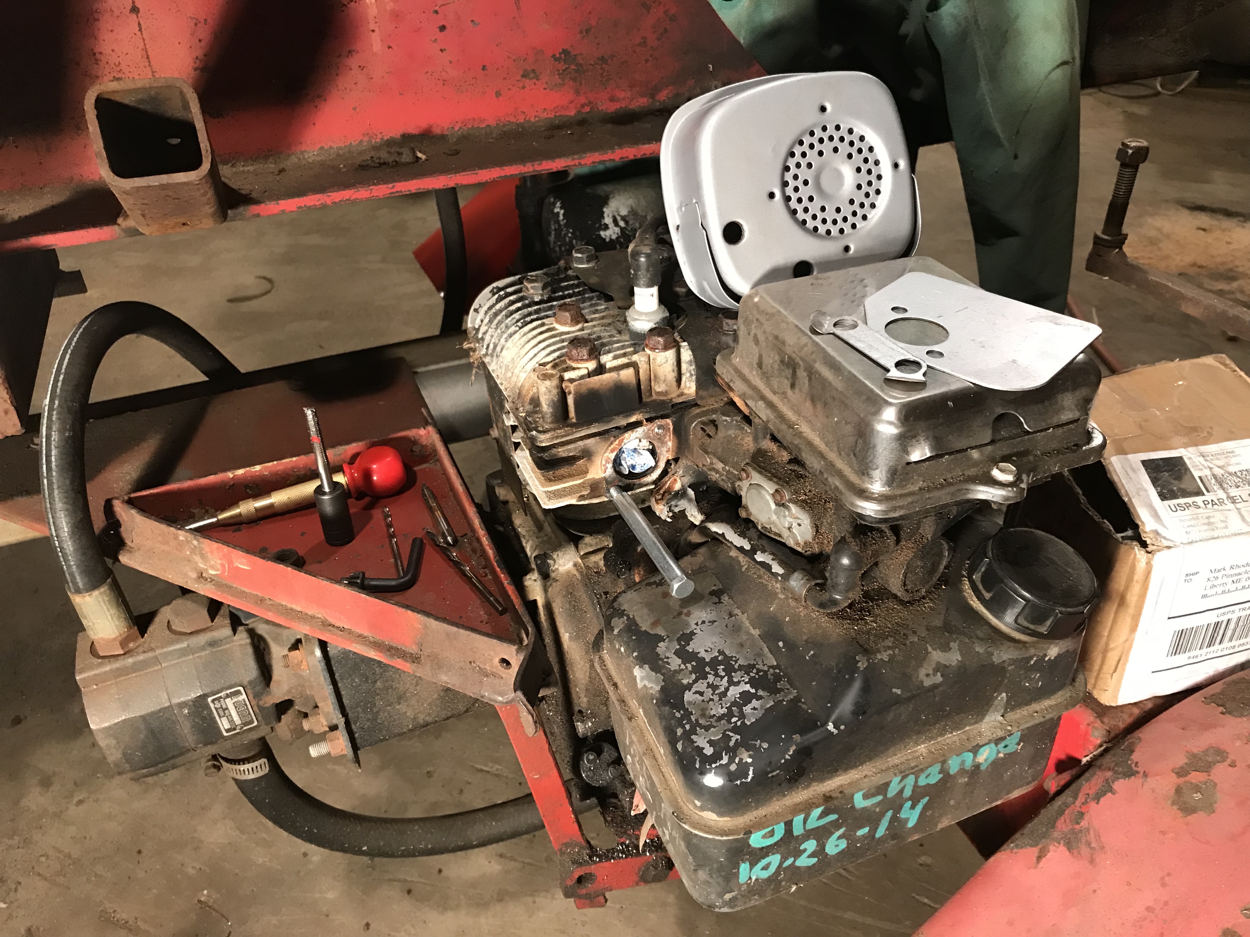

Brass studs, with brass washers and nuts are fairly common in holding exhaust manifolds on in Japanese cars. What you might end up doing if you mess up the threads is to source some from a parts store that will fit through the new muffler, both diameter and length, and helicoil the cylinder to take them.

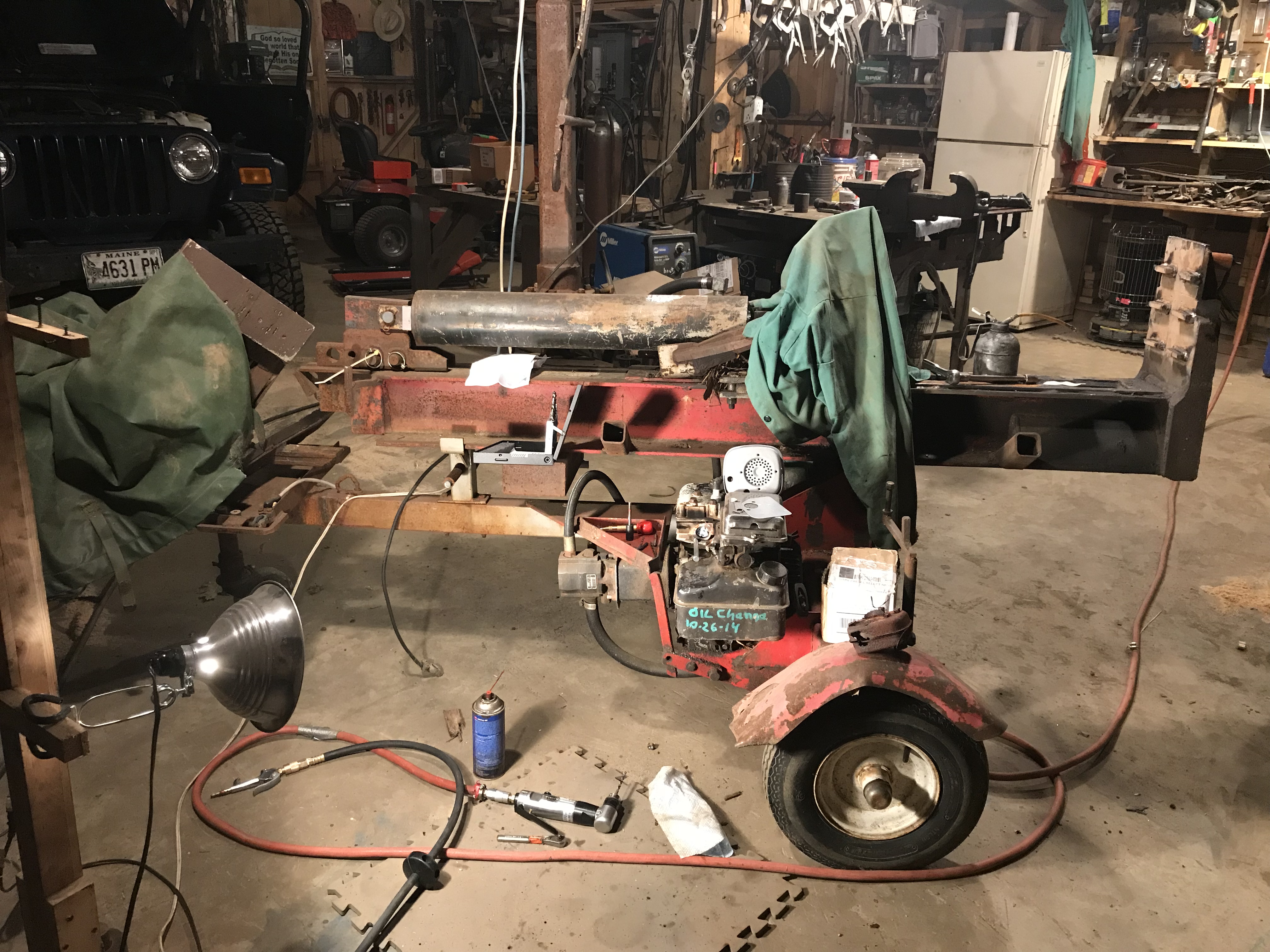

I got one hole tapped tonight, do the next one tomorrow when I have time when things go south......
