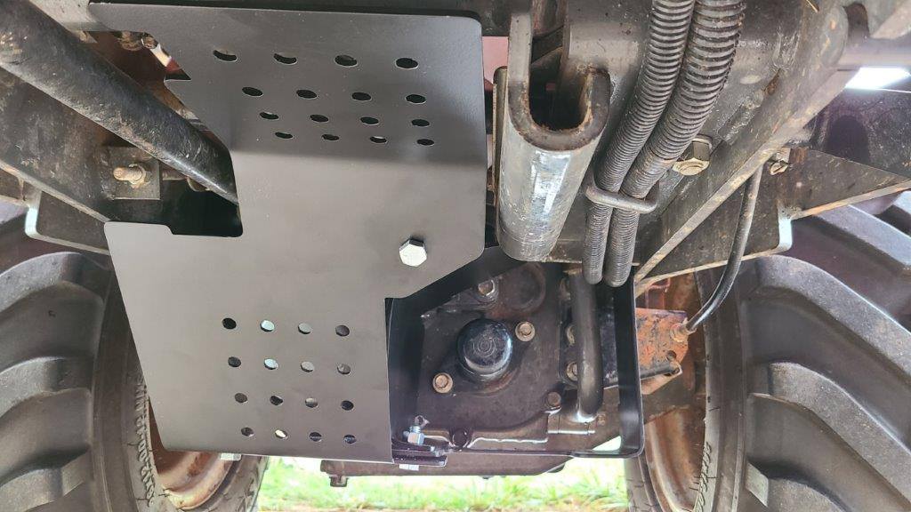

After you are done with this big job consider the Sentinel protector.
It would help protect against this type of damage.
