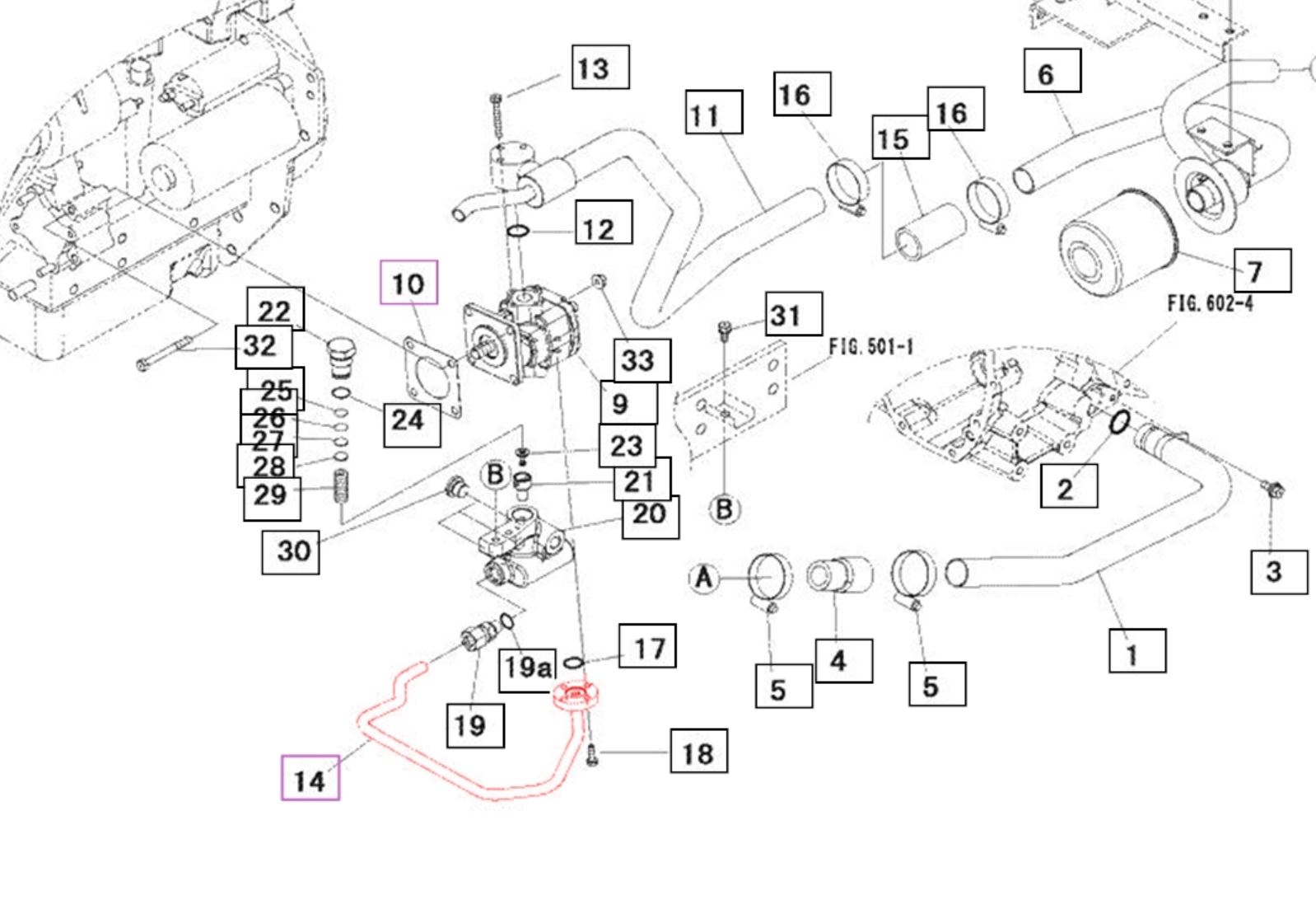

Hello everyone,
I hope I can get some help and opinion on my situation.
I only had this tractor for less than 10hrs.
Couple of weeks ago I was digging a hole and couple of stumps, then decided to move the remaining sand to the back of my property.
Besides not being able to get a full bucket I noticed some power lost and and immediately hydraulic fluid coming out like a fire hose from somewhere on the left side of the engine
After immediately turning off the tractor found that hydraulic line coming out of one of the pumps had a hairline crack.
This happened on Sunday Dec 2nd.
Went online and submitted the order to replace the part.
The next day called Cobb's Tractor, very nice people by the way, they informed me that the part was in back-order or something along those lines and that they were going to reach Mahindra to see when they could get it. I also ordered some other misc parts, like nipple and o-rings, and got those couple of days latter.
Part number 19582580AG0 - check attached diagram pic "Part Highlighted in Red". Still missing and no answer.
It has been about two weeks already.
I went over Pirtek Altamonte Springs and they will be taking the broken line and try to repair/replace it with some fabrication and using some hydraulic hose.
At this point I will be happy just to be able to move the tractor to my garage.

Let me guess. The tube line failed at the pump mount flange ? This is a known issue. Many are failing and that's why there is a backlog of orders. Should be warranty. :thumbsup:

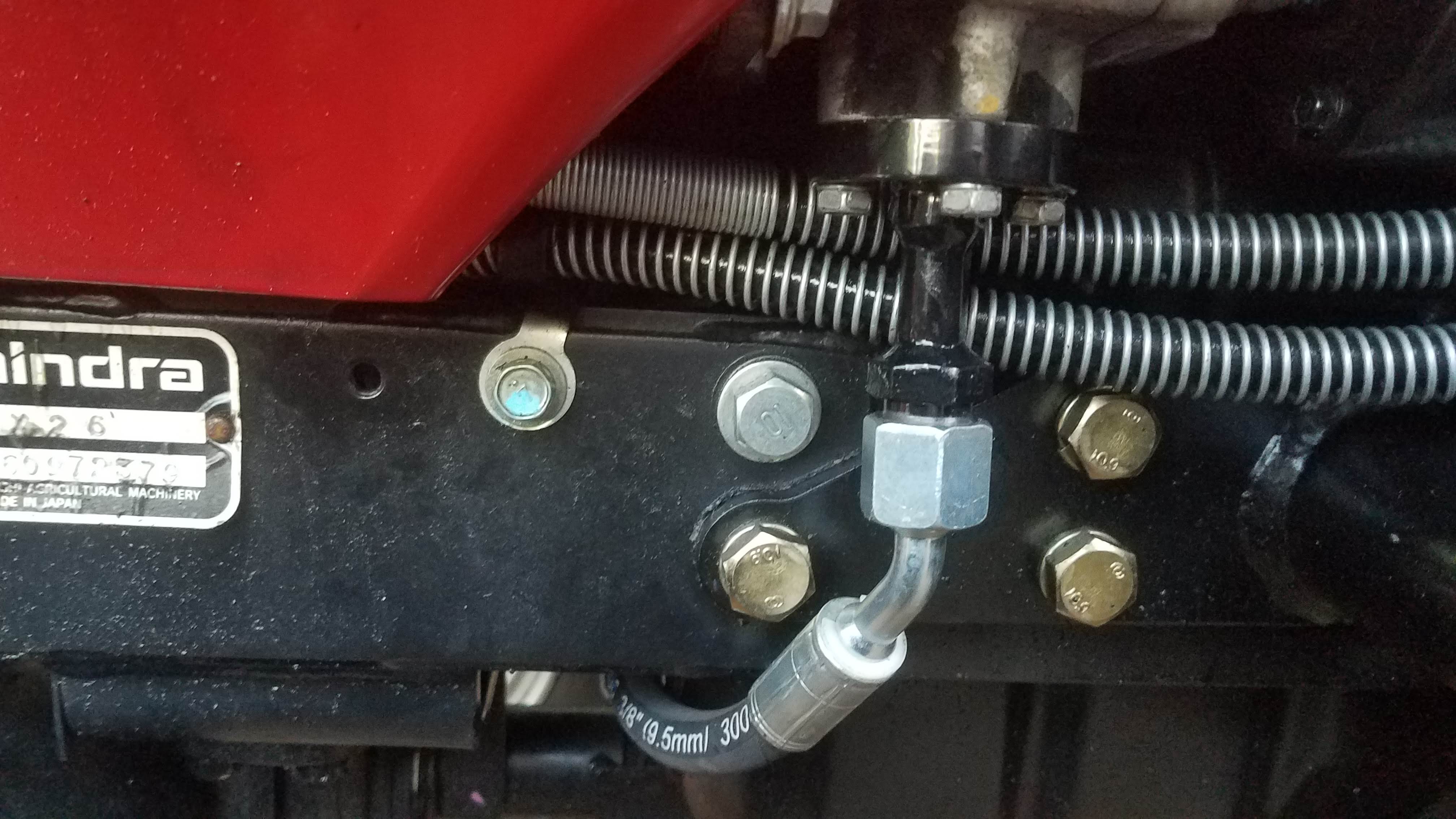

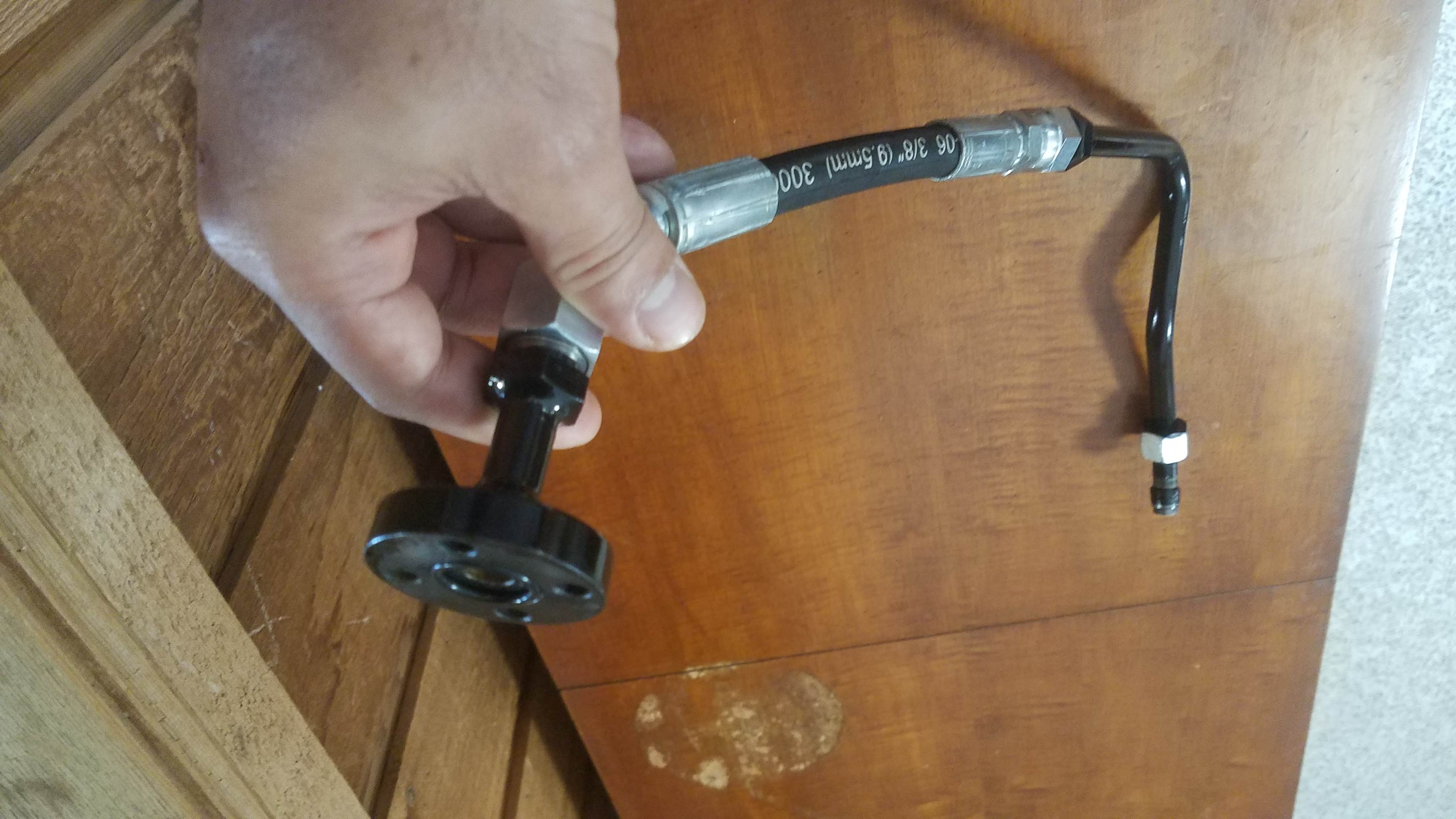

ChibyTron is back and fully operational.
Mark from Pirtek Altamonte Springs did a nice and quick work.
So far all good.
Now I need to install that 3rd function kit.

Was it brazed or tig welded? That’s a good fix. No reason to have something rigid off the motor like that. A bit of flex in that hose will go a long ways to preventing future failure.
   / Broken Hydraulic Line #11
Was it brazed or tig welded? Thatç—´ a good fix. No reason to have something rigid off the motor like that. A bit of flex in that hose will go a long ways to preventing future failure.
I agree. Most likely vibration caused the original line to work harden and crack. That piece of hose should solve the problem. Very nice repair job, by the way.
