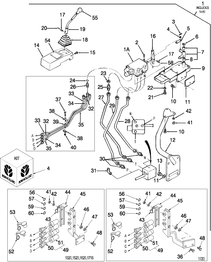

I've got a 1715 Ford with a 7108 FEL.. The machined pin broke that supports the yoke that the joystick pivots on... I went to the New Holland Dealer on the south side of Baltimore... They could only pull up the valve and couldn't offer any suggestions as to where to get the part... I'm looking at making a repair that would replace the pin with a metric bolt.... I'm looking at grinding, drilling, hack-sawing and welding... Right now I'm stuck trying to get the pin out that holds the joystick in the yoke.. Looks like the pin is a press fit. Tomorrow I'm going to mount a small arbor press, to press the pin out..
Can one buy that part?
Is there an easy fix without a metal lathe?
Is that pin supposed to be a press fit?
Thanks, Tom
   / Broken Joystick on 7108 FEL #2
here is the parts breakdown. and a copy and paste of the relevent listings. The main support pin is part of the valve mount plate.

RickB, That's it, the diagram I thought the dealer should have... They didn't have a clue at the Dealer... Thanks!!! Now if the Dealer can get it before the next snow?

The valve is an accessory to the tractor; it won't be found by searching the loader. All two spool valves for NH compacts are cataloged that way.
