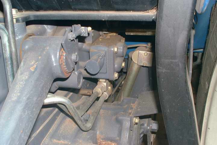

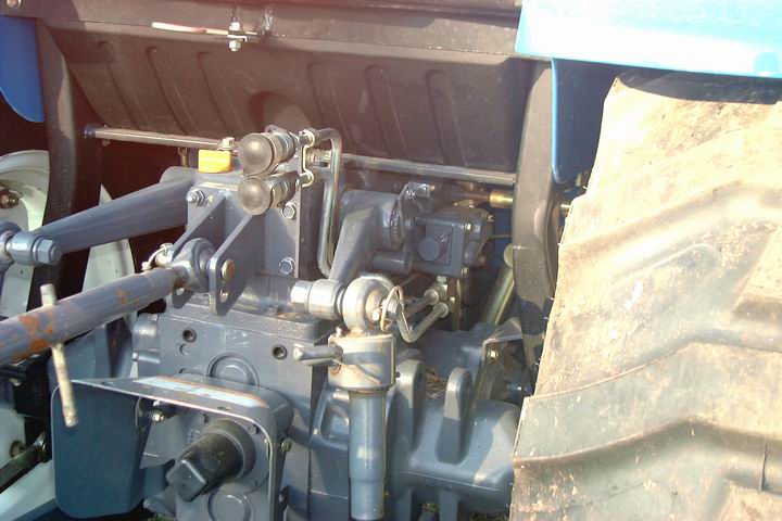

The repair manual instructions say to mark/score the rockshaft and lift arms for re-alignment when reinstalling. It also says to do the same with the internal lift lever. However, that is for reinstalling the same parts. If I buy a new rockshaft and it is not keyed in any way (and certainly won't be marked), it would seem that the only important thing is the relative positions of the inside lever and outer arms. After installation of the rockshaft, but before putting on the lift arms, I could run the lift control all the way to the top and then put the lift arms on the shaft ends and also put the lift high-limit lever on at that same position. The lift all the way to the top and the lift arms also at the top seems a constant in every case I can think of. Here is a photo of the right side rockshaft on my tractor (not that it looks any different from the OP's).
Edit: I'm adding one more photo. Wouldn't it be cool if you could remove the toplink bracket on the rear of the lift casing and have an opening into the case to view and hold parts? (You can't:() Check out my added photo.

One can transfer witness mark from the old broken rockshat/lift arm and also on internal rockshaft/arm to the new shaft. That is enough with no reference material or as you suggested per the book. I agree about being able to holds part from the rear bracket but we can already do that with a helper from the front removing the cylinder head and then piston/cylinder sleeve. I saw your photo. The only bad part of fancier tractor is that you have to take a lot of stuff off just to get the darned lift cover.
The best thing is to have tandem external hyd lift with two cylinders externally mounted. That's the cat's meow.
