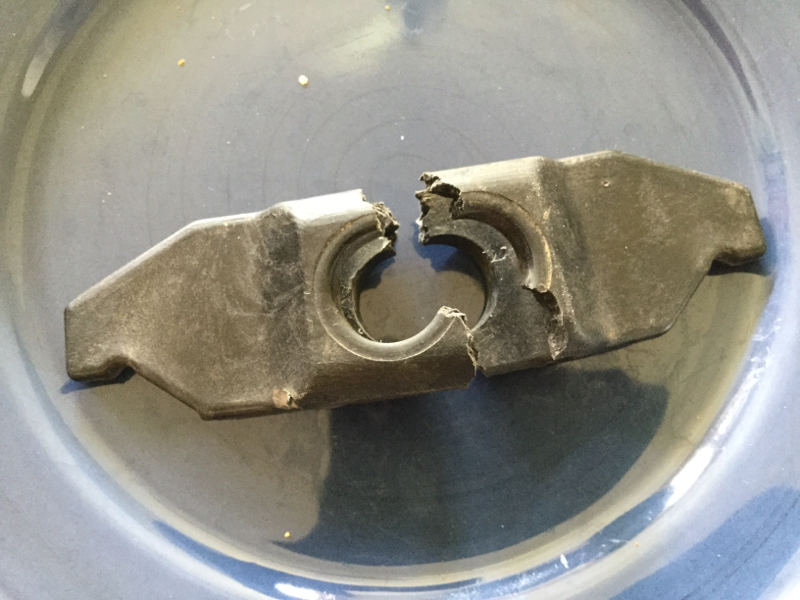

No the part is not available from New Holland individually. I have to buy a complete new seat at $462.00. I think I can make something similar. Anyone have an old seat laying around. LOL. It is part #11 on the parts page of the seat.

If it's steel it can be welded back together. Perhaps even fixed if it's cast aluminum. If it's that white pot metal crap probably not. For that kind of money I'd be making my own out of steel.

Seems to me it is a hard plastic. I can make something easily out of metal.
   / Broken Seat Part #4
I'd try to copy it but with metal. At first look, it looked like cast to me but when you mentioned plastic I could see the pattern in the plastic.

I looked at mine and it is metal. My friend came by and we both agreed it should be made from steel.
The manual for my 33D has a seat rebuild kit (part #86530936) that Messicks list for $154.53. It looks an awful lot like yours, but metal. If you gave me your best guess on the width of yours I would mike mine for reference.

I can measure mine and post later today. I am going to take two flat plates of metal, put two large spacers in it so the adjustment bolt can go in, drill the hole for the pin and I should be set. It won't take much just time. The tractor is 14 years old.

The tensioner under the seat pulls on this which tightens the springs at the same rate pulling the seat up for heavier people and more bounce. I have a replacement almost built.

Part is made. Just need to install now. All out of aluminum. This should never break.

Sorry for this taking so long to get back to you. I thought I had notifications working but I guess not. I think the guy charged me $35.00 dollars to make. I gave him cash so I can't remember for sure. I doubt this one will ever break break. It is made out of aluminum.
