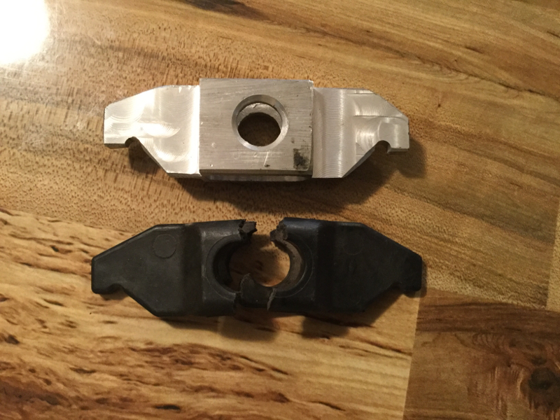

The tensioner under the seat pulls on this which tightens the springs at the same rate pulling the seat up for heavier people and more bounce. I have a replacement almost built.
   / Broken Seat Part
#13
Part is made. Just need to install now. All out of aluminum. This should never break.

   / Broken Seat Part #14
Excellent! Good job? Looks like some end mill action .
   / Broken Seat Part #15
Mine broke this summer as well, how much was it to make? My dealer said the same I needed to buy whole unit.
   / Broken Seat Part
#16
Sorry for this taking so long to get back to you. I thought I had notifications working but I guess not. I think the guy charged me $35.00 dollars to make. I gave him cash so I can't remember for sure. I doubt this one will ever break break. It is made out of aluminum.
