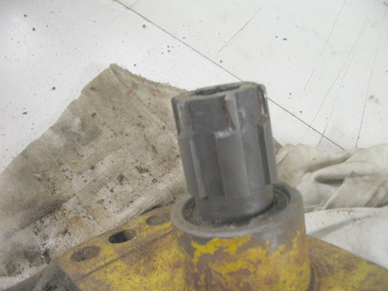

Actually, depending on the metal composition, spray welding might be the best option. This technique is used by many auto engine repair shops to repair valve seats and other engine block internal problems and by hydraulic repair shops to repair valves, cylinders, rams, pump shafts and couplers.
What hapens is that a special torch heats the base metal then sprays fine metal dust onto the heated area that then melts to form a joint. The weld then can be machined as necessary. My hydraulic repair shop used this technique to rebuild my dozer's hydraulic pump PTO shaft coupler.
Spray welding requires someone who has the equipment and knows what they are doing (it's all technique). You would also have to completely disassemble the valve block.
The first picture is the coupler before and the second picture is the coupler after spray welding and machining. it's better than new.

That coupling was never heat treated. It fits into a hardened PTO shaft that is connected directly to the engine. It is intentionally left unhardened so that it will deform and cushion the shock from the snap torque when the engine bogs then revs back up. This is a very common setup on heavy equipment.
A new coupling would have cost me $354 from Komatsu/IH. I paid a lot less to have this one spray welded and re-machined.
