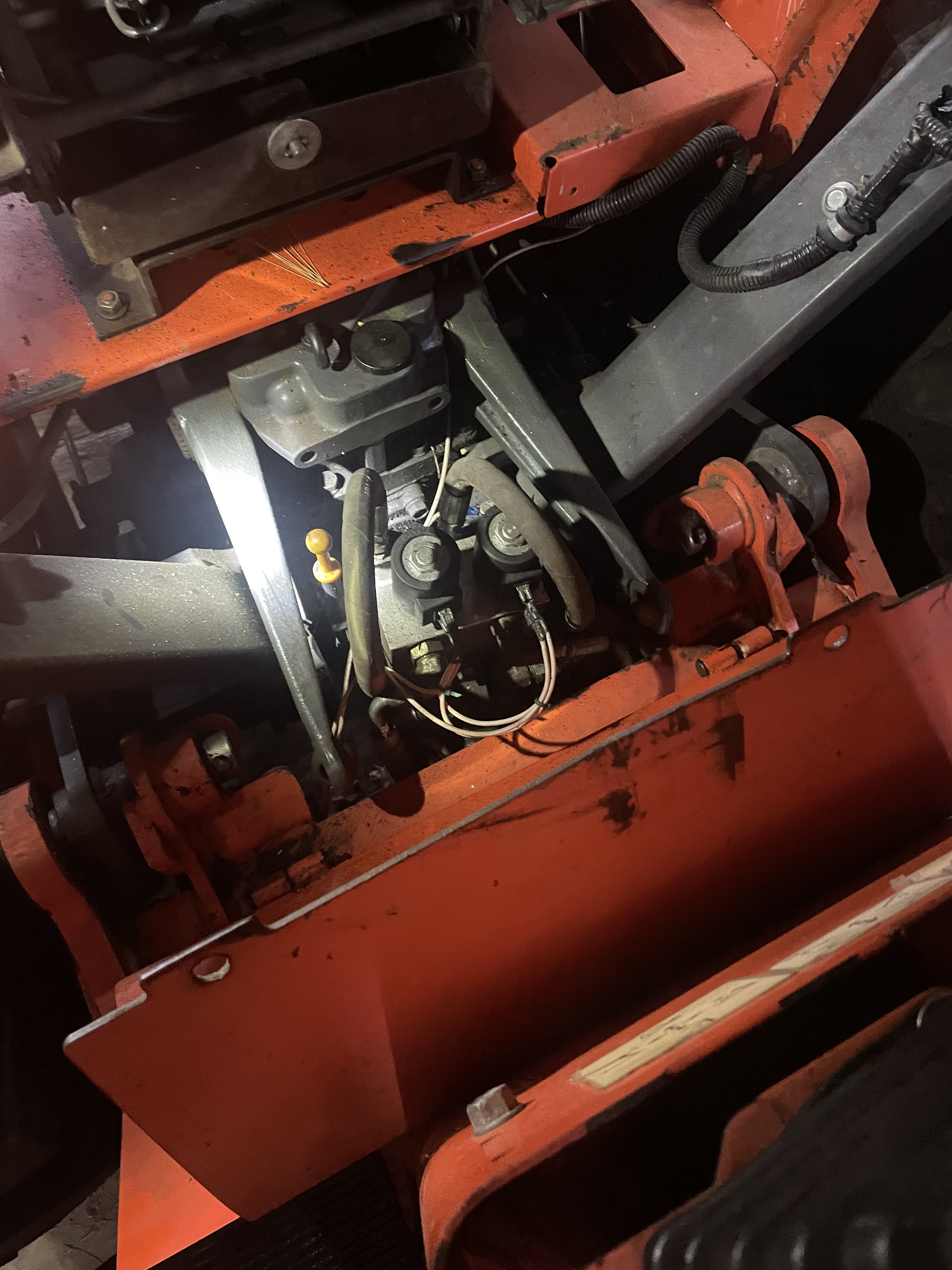

Hi everyone,
I'm trying to get some insight into what is going wrong with my Kubota B26. I had my mechanic install diverter valves in the front and rear of the tractor to accommodate a grapple and a hydraulic thumb. Since then a couple things keep happening
In the rear the backhoe spool valves (which had been rebuilt a few years ago) started leaking and one of the outriggers operates very slowly. It's been already repaired once, and then began leaking again.
In the front- when using the diverter valve to operate the grapple the boom cylinders sort of pinch down on the left side when closing the grapple fully. Now the boom cylinder (also recently rebuilt) is leaking. I chose the boom cylinders for the diverter valve because of the regen function on the curl circuit.
Are these diverter valves blowing my seals? Could this be pointing to the relief valve not operating properly?

They're surplus center solenoid diverters. 6 gpm
Not sure if pictures will be very useful but the forward valve is mounted beneath the right floorboard and is connected to the boom circuit. When the grapple closes fully it squishes down the left side of the boom. Doesn't look right but I don't think it's hooked up incorrectly.
The rear valve is plumbed in by the three point hitch.

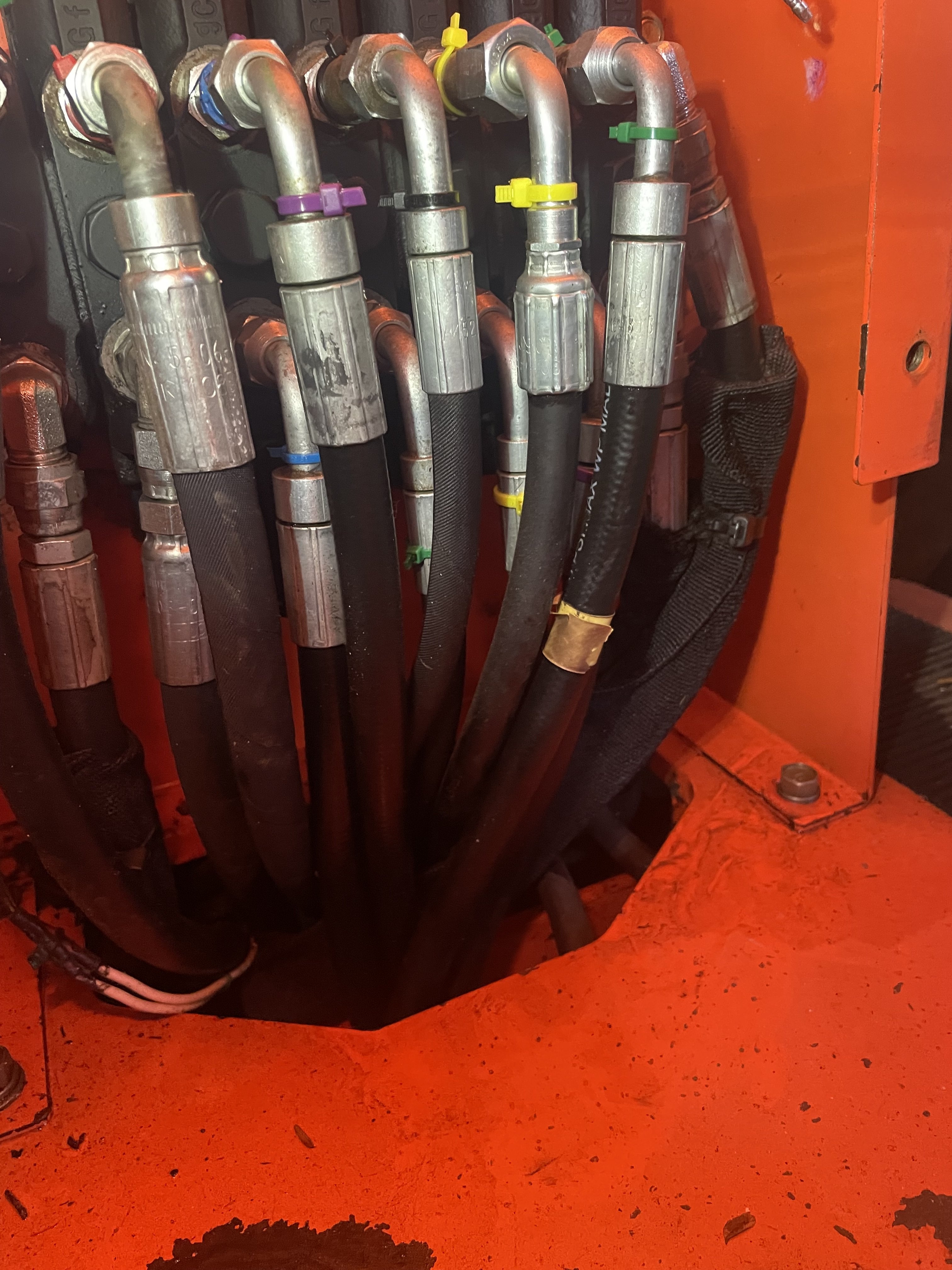

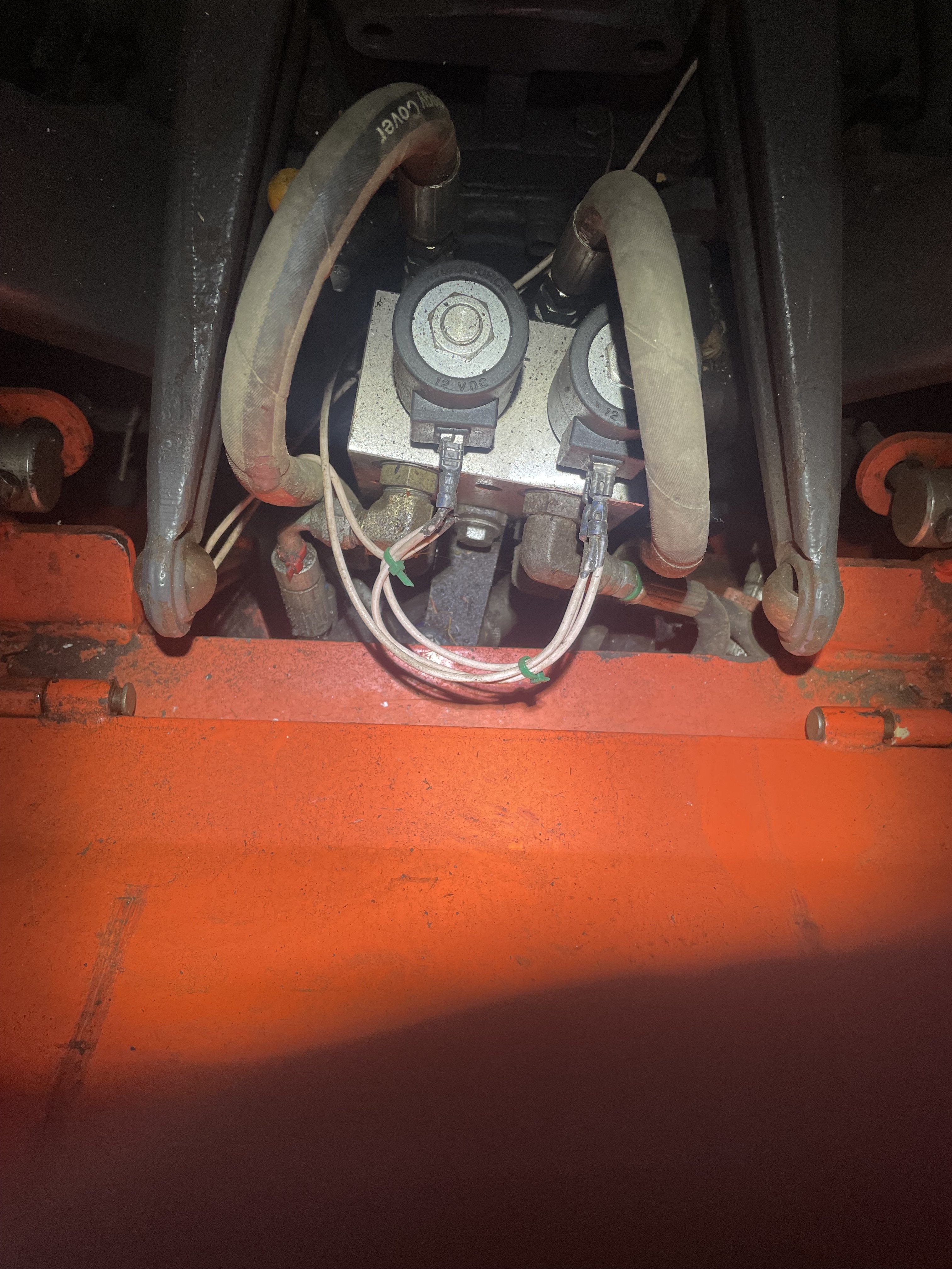

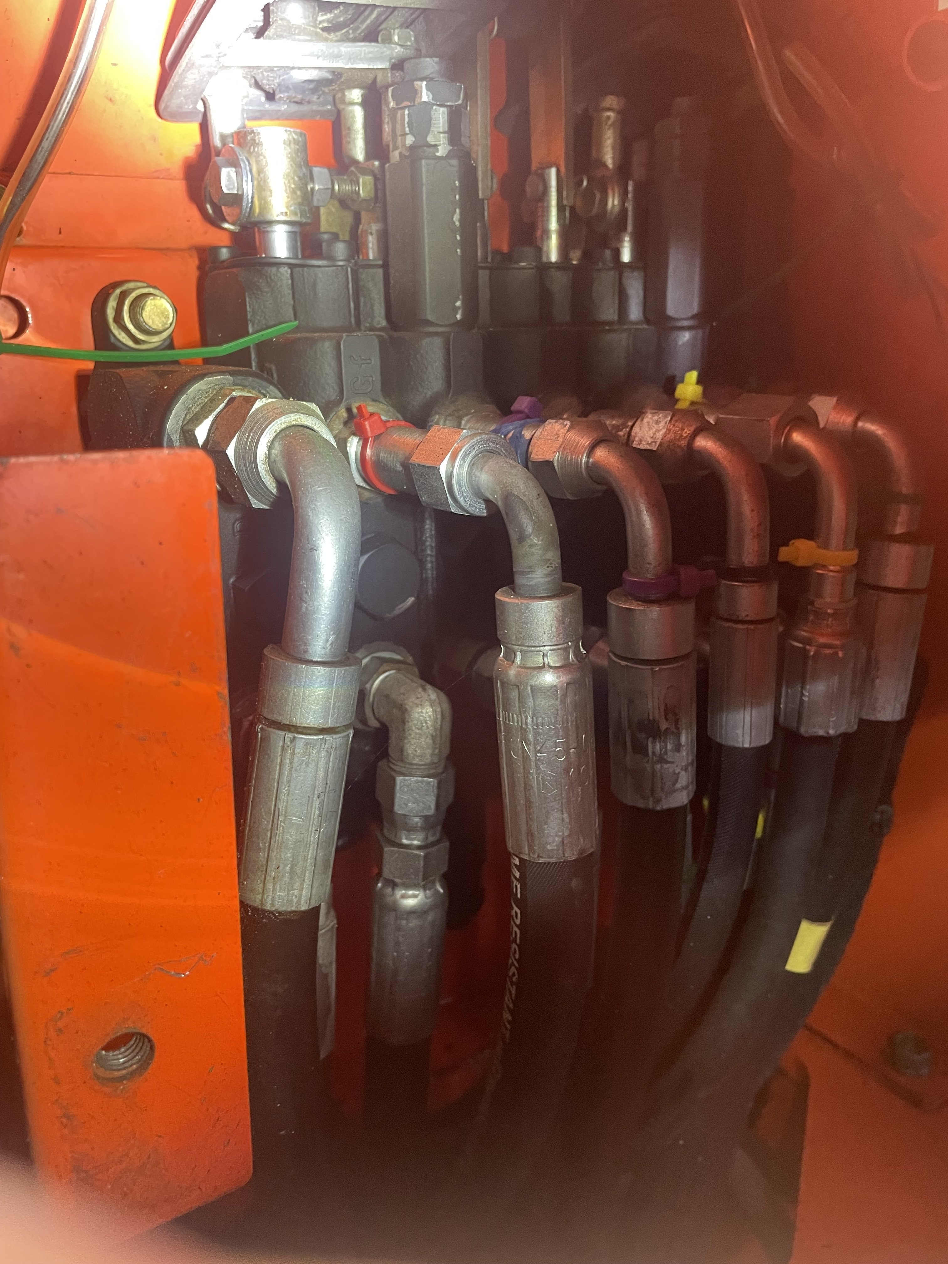

Both lines coming off the back of the diverter go to the connection on the spool with the red zip tie (second from left.
On the front of the valve there’s a red line zip tie on the left and a green on the right.

Are both solenoids being activated at the same time?
They need to be, they both have to operate to switch the function one circuit to the other.
Also they should be wired in parallel not in series.
