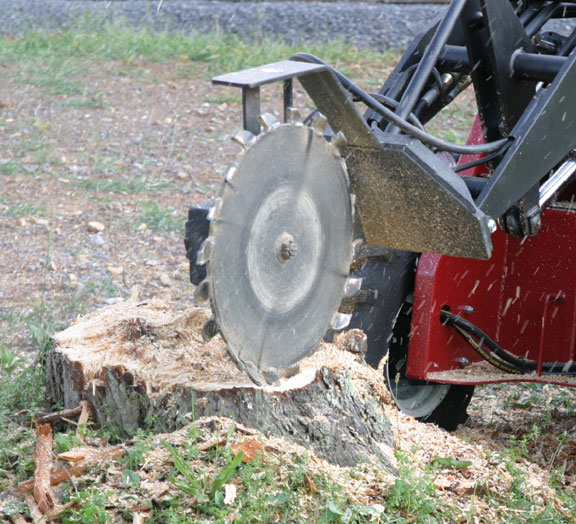

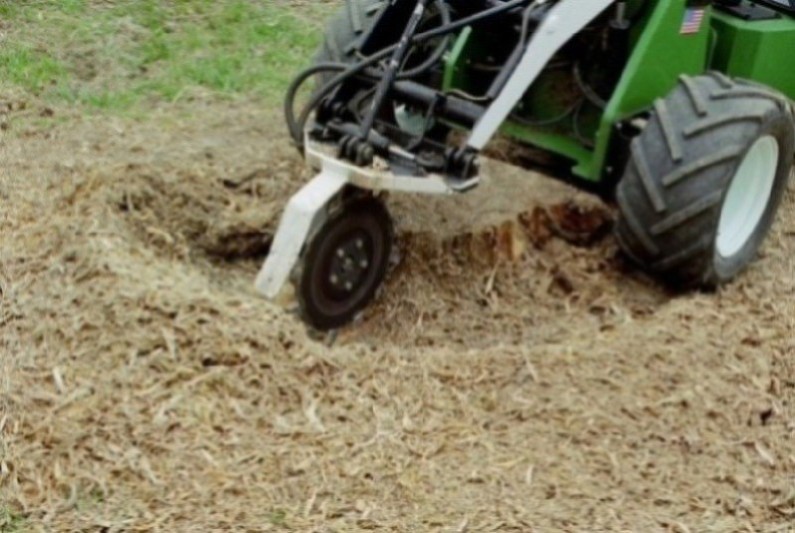

wa****a. Doesn't your hydraulic motor have solid taper shaft, and held on by a large nut and pin? I can't imagine a 1 1/4 in shaft twisting off. Pictures please. Does your stump grinder look like this, or does it have the bolt on blade? The second picture shows the wheel that can be turned around. Does anyone have a price on the wheel and hub?

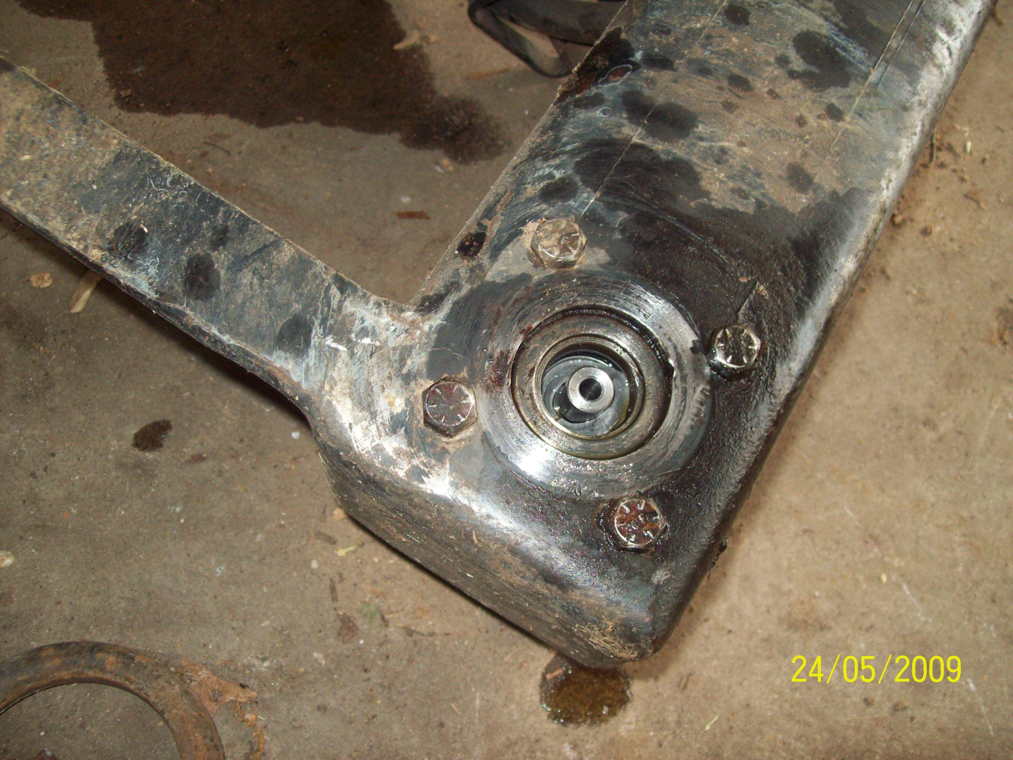

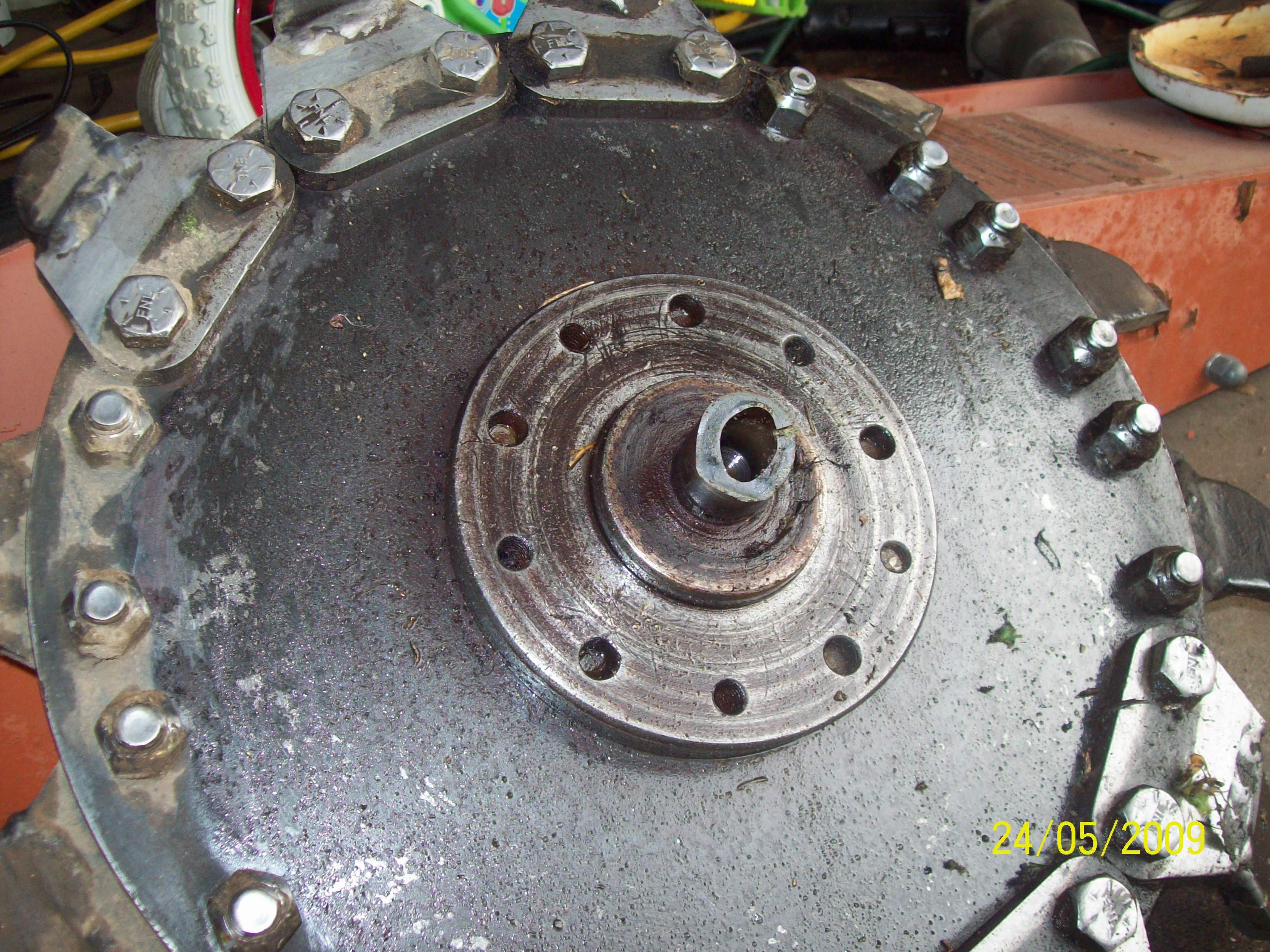

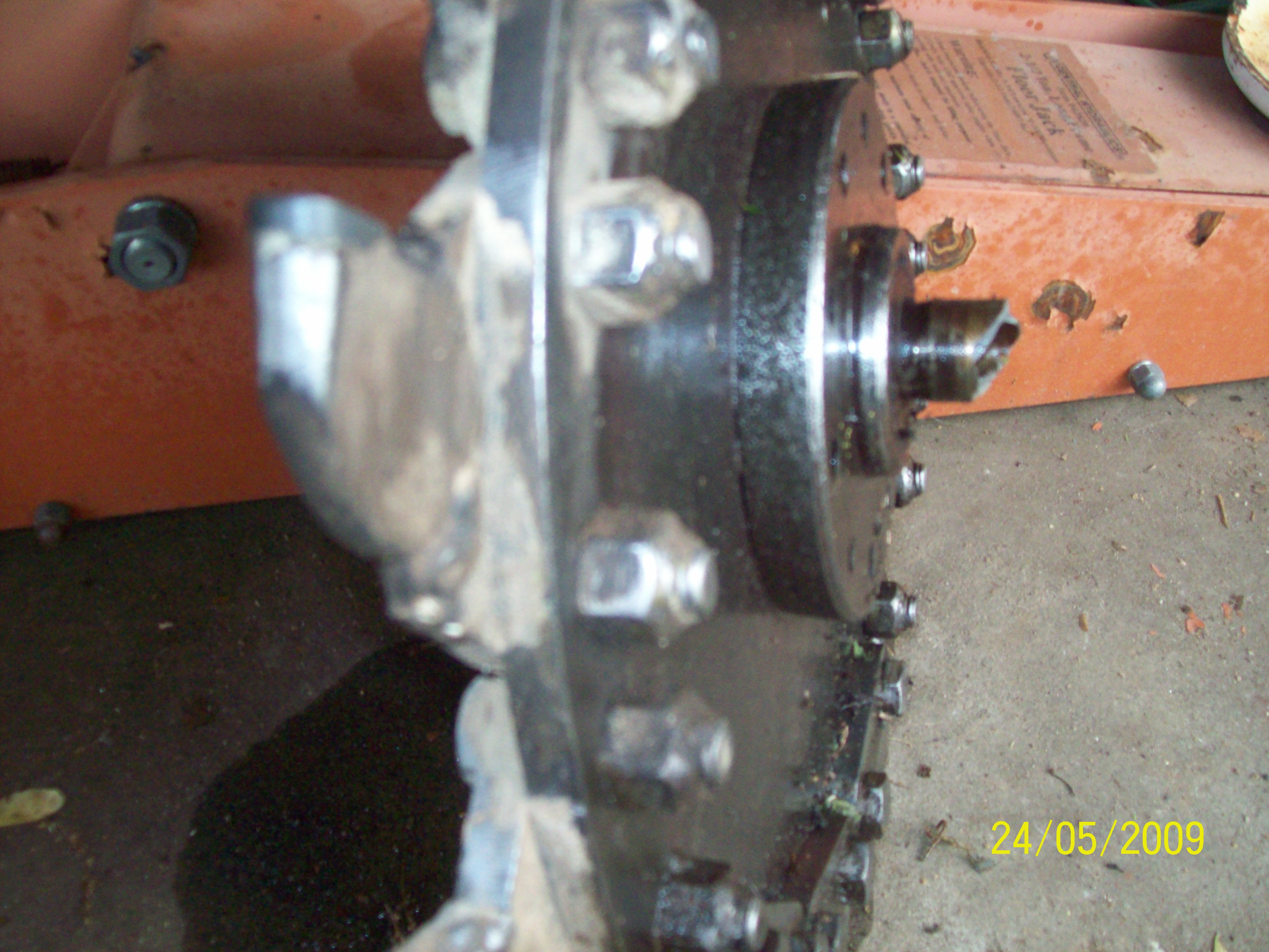

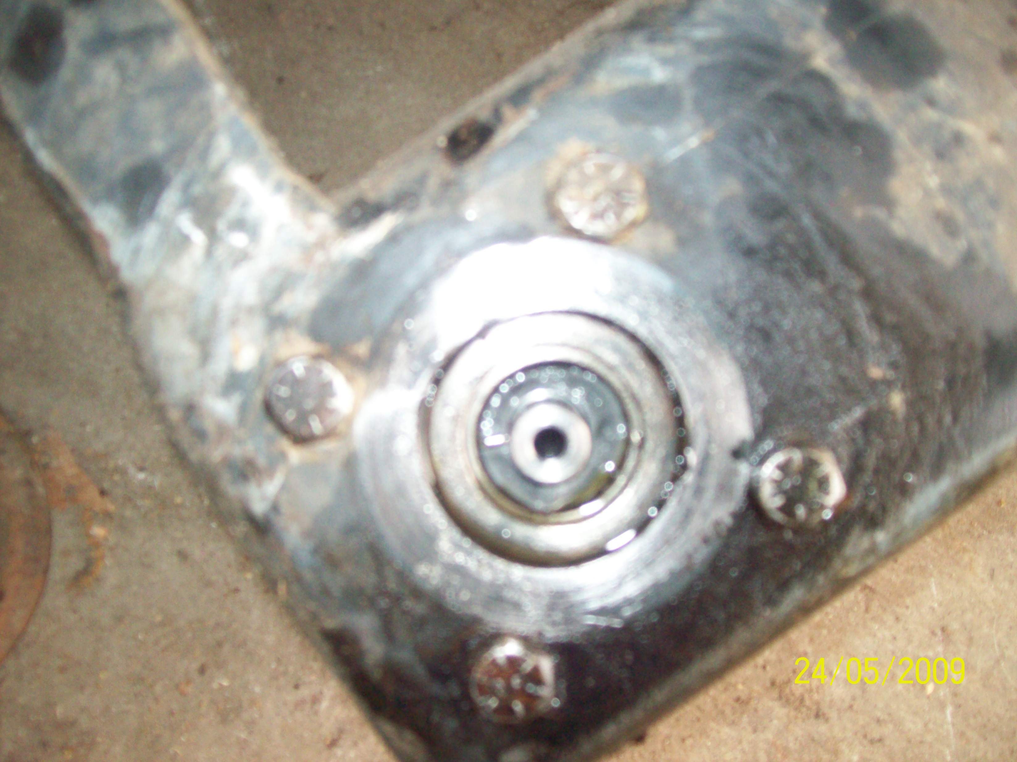

pictures :eek::eek: looks like potmetal to me:( whats your opinion

before any one asks the bolts on the teeth are not original I had problems with the bolts stretching and the nuts backing off :eek: so after a trip to my local bolt supplier I now have grade 8 bolts and metal locking nuts on the teeth only drawback is if I change teeth the bolts will have to be replaced they are not reusable I was informed that was a common upgrade locally the local sharpening center also claims to sharpen the top of the teeth also in a wedge shape I have not done that modification yet but might in the future but first to fix the motor issue 4 acres of stumps to grind :(

Well, that is a first for me. I haven't heard about or seen anything like this before. Do you think the wheel/teeth assemble might be out of balance. The only support for that shaft would be at the bearing, and the longevity would depend on how the stump grinder was used. Are you going to rebuild it or purchase a new motor? I didn't know those shafts were hollow either.

Is it possible that the shaft that is on the hub of the grinder blade may have had a roll pin in it located just where it twisted off. The roll pin would have been driven in through that shaft and into the motor shaft to hold it on. If it wasn't put in or put in improperly that would have caused it to shear and as the blade worked itself off it egg shaped the the remainder of the blade shaft?

Looking at your photos, and I am no expert, it looks to me like a manufacturing defect, do to the erratic nature and granulated look of the break. Good luck on the repair. I hope PT/the manufacturer come up with something.
