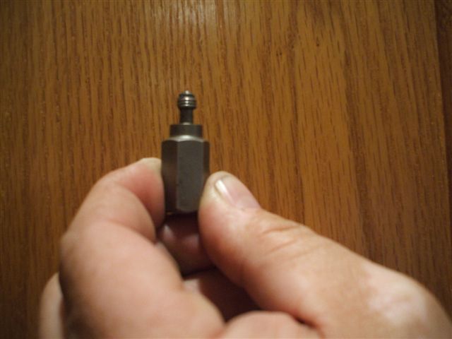

Here is a picture of the broken zerk attached to the snap-on tool I used to remove it.
Everything went well.
The tool from Snap-on was sooo nice and allowed me to use "hand power" to gently back the zerk out.

When dealing with extractors.. 'hand power' is all I'd ever use.. unless I wanted a snappe doff hard tool steel peg in the hole that I was working on..
soundguy
SG you are just missing out on all the fun then :D
DocBob, that extractor you have is the best design out there in my opinion.
   / Broken Zerk! #19
I've snappe dplenty by hand.. thus i know that doing it with a power implement would be shear folly.. ( pun intended! )
