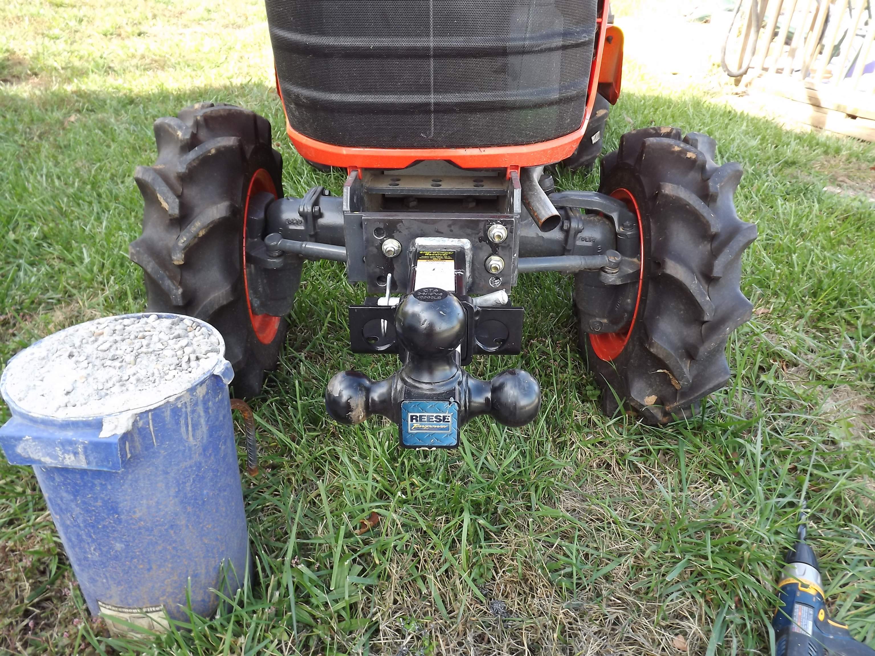

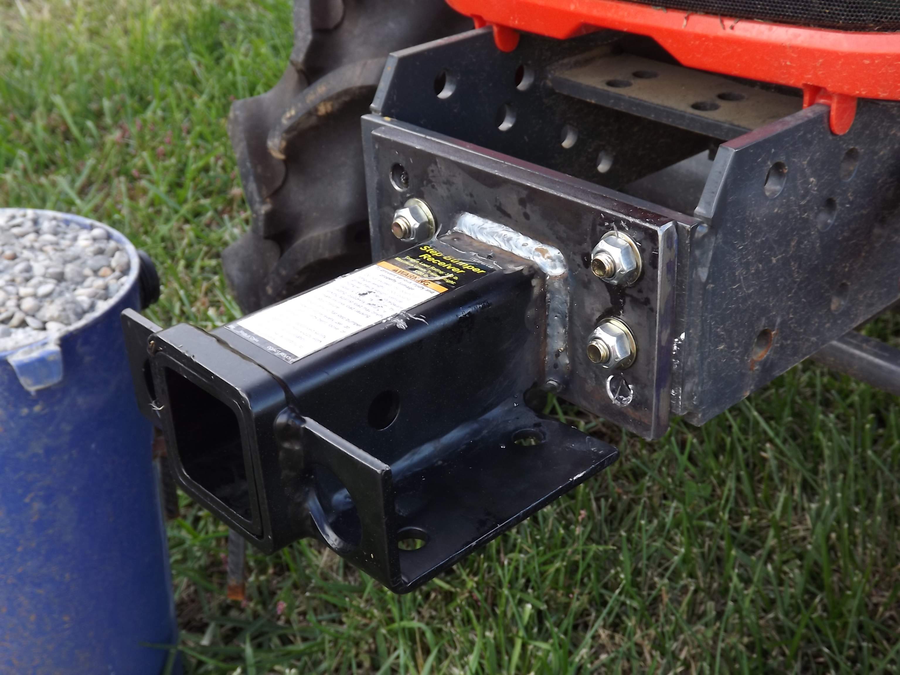

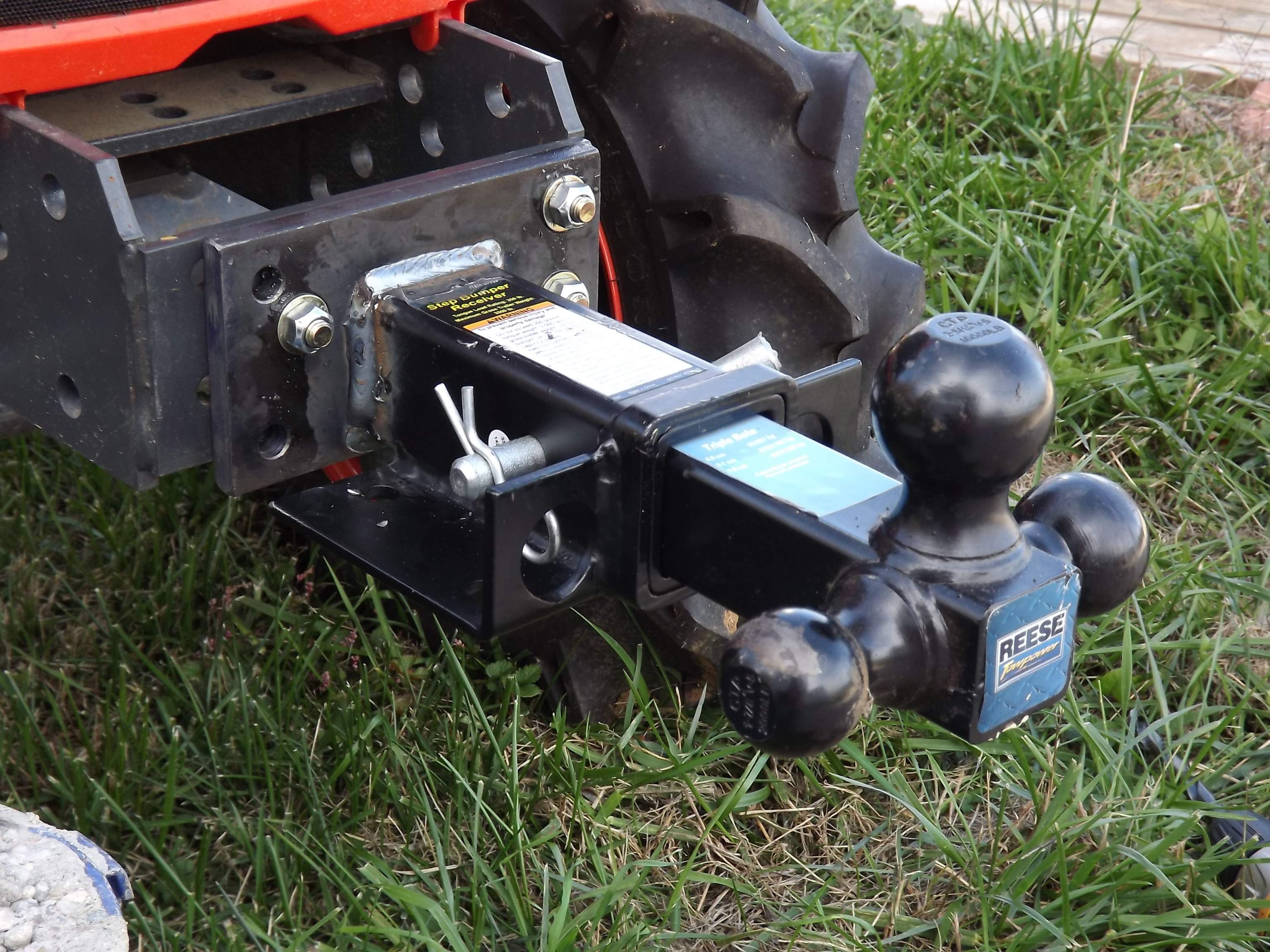

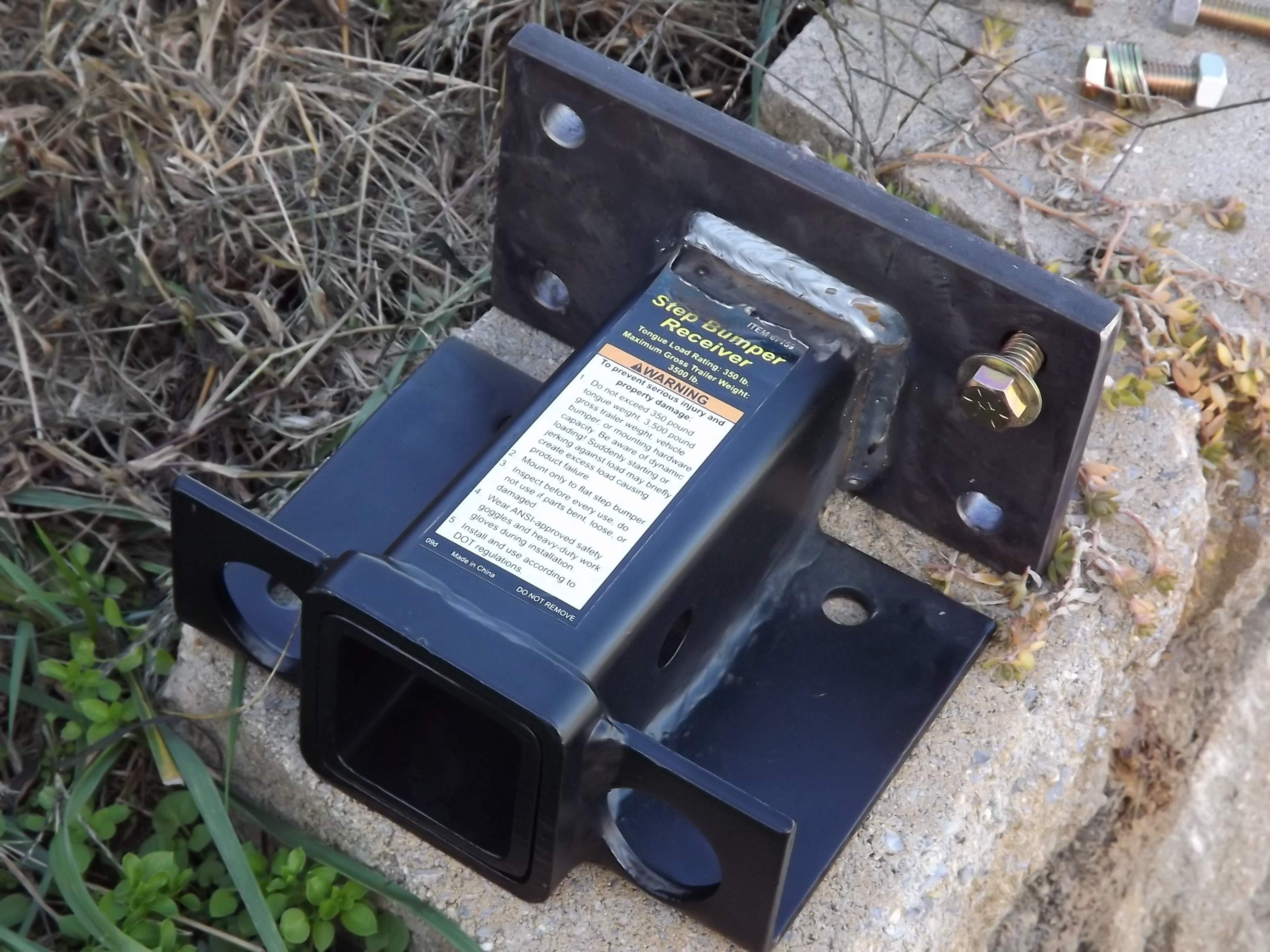

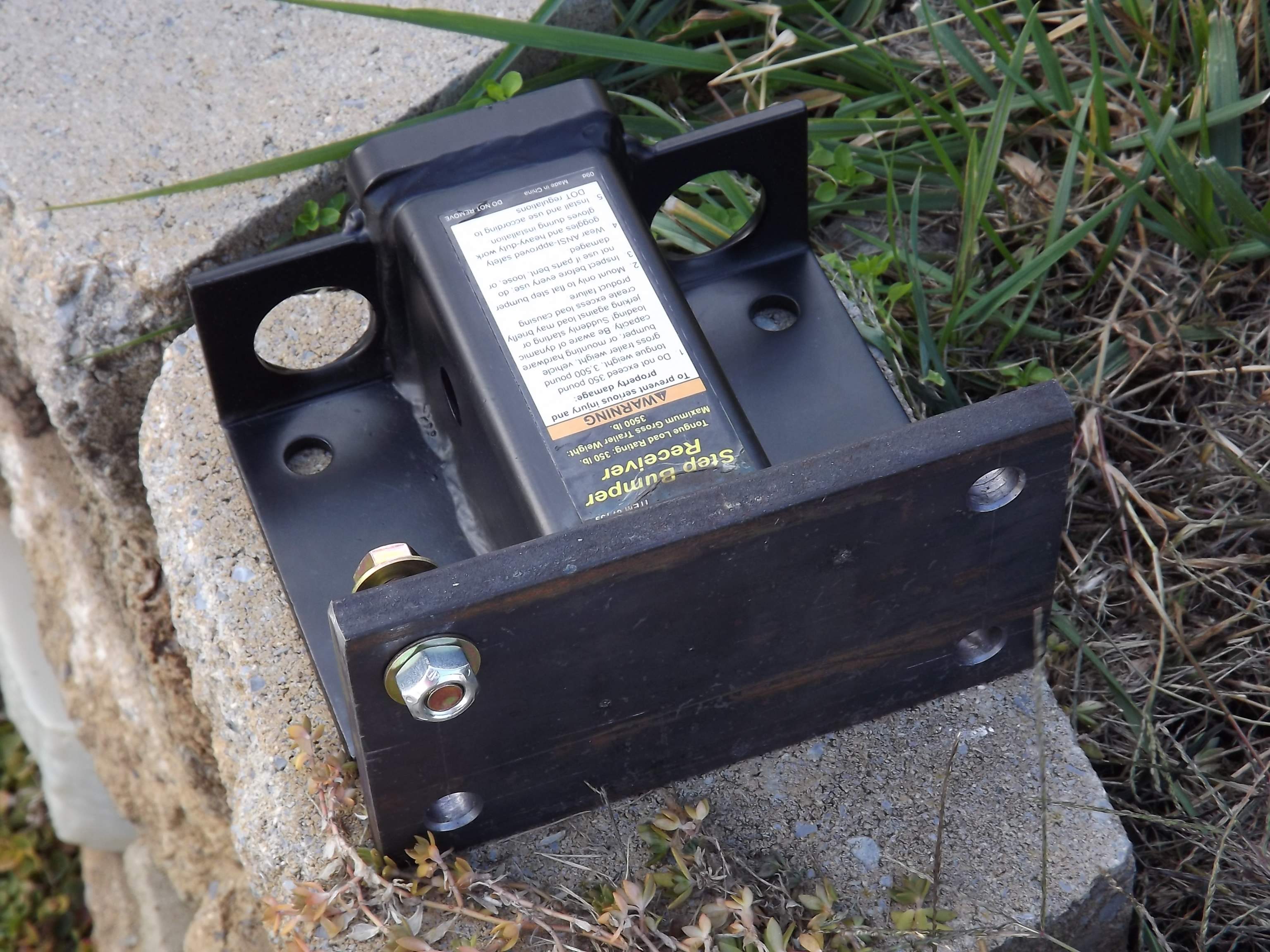

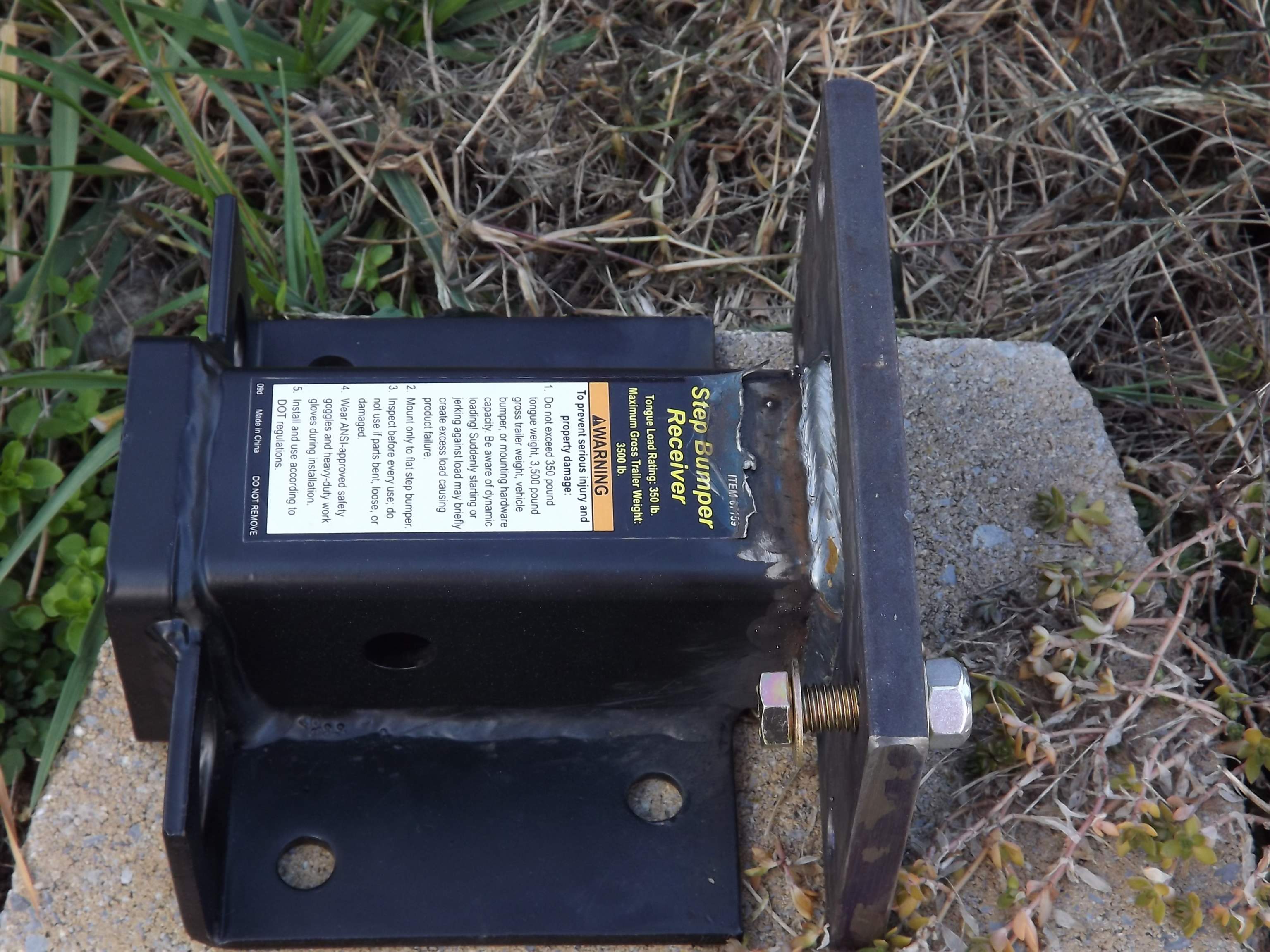

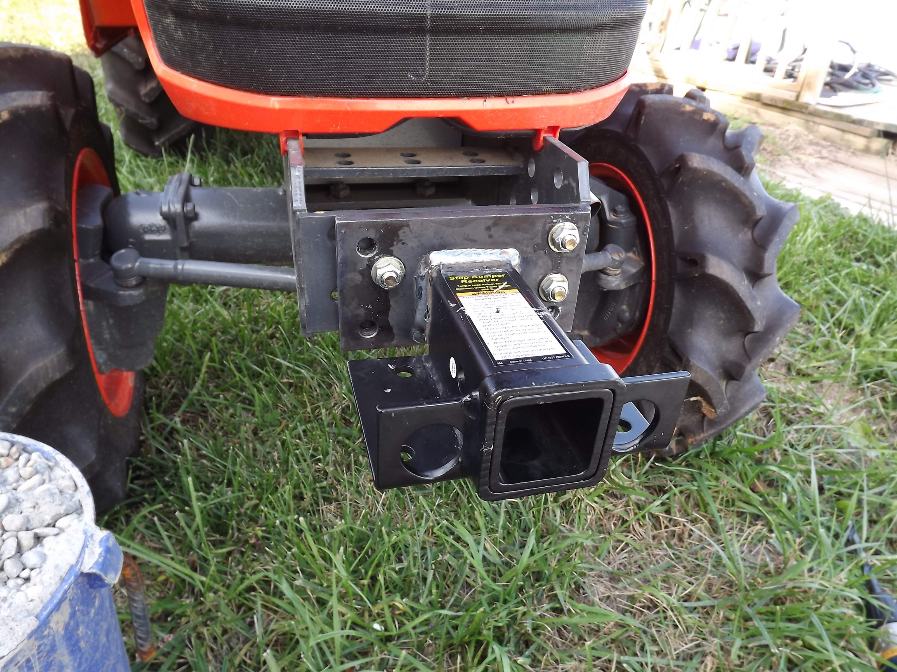

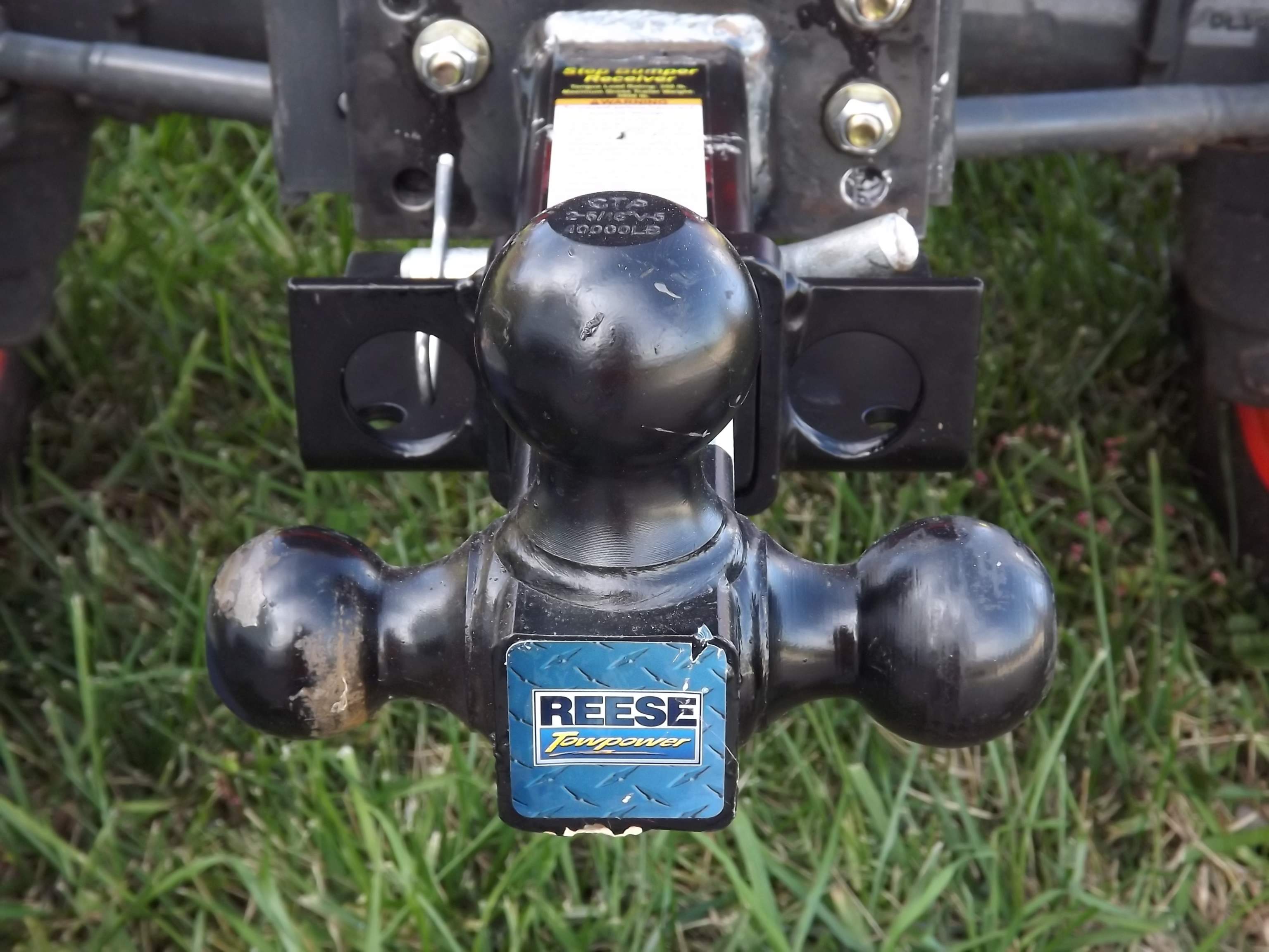

Need front weight for my B2320. Lots of pondering and consideration of others resolutions of the problem. Finally decided a Reece Hitch receiver on the front of my B2320 would allow me to attach weights, move trailers and other unlimited possabilities.
My Brother in law is a Machinist with his own Machine/Fabrication shop/factory. I asked him for advise on how to attach a Reece hitch receiver on the front of my B2320. Here are pictures of what he made me and I attached to my tractor. I asked him what another one would cost if a friend wanted one. He said he could do them for $99 shipped and would locate the bolt holes at the dimensions/location anyone wants. I didn't give him my bolt hole pattern so I had to drill a couple of holes extra to mount mine.
I added my concrete weights to the hitch and they are ugly but work fine. I'll do another post on front weights with pictures.
