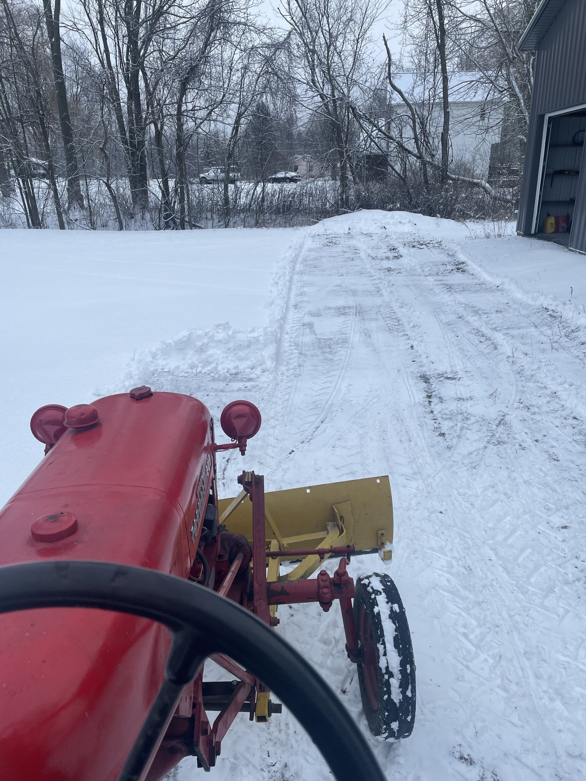

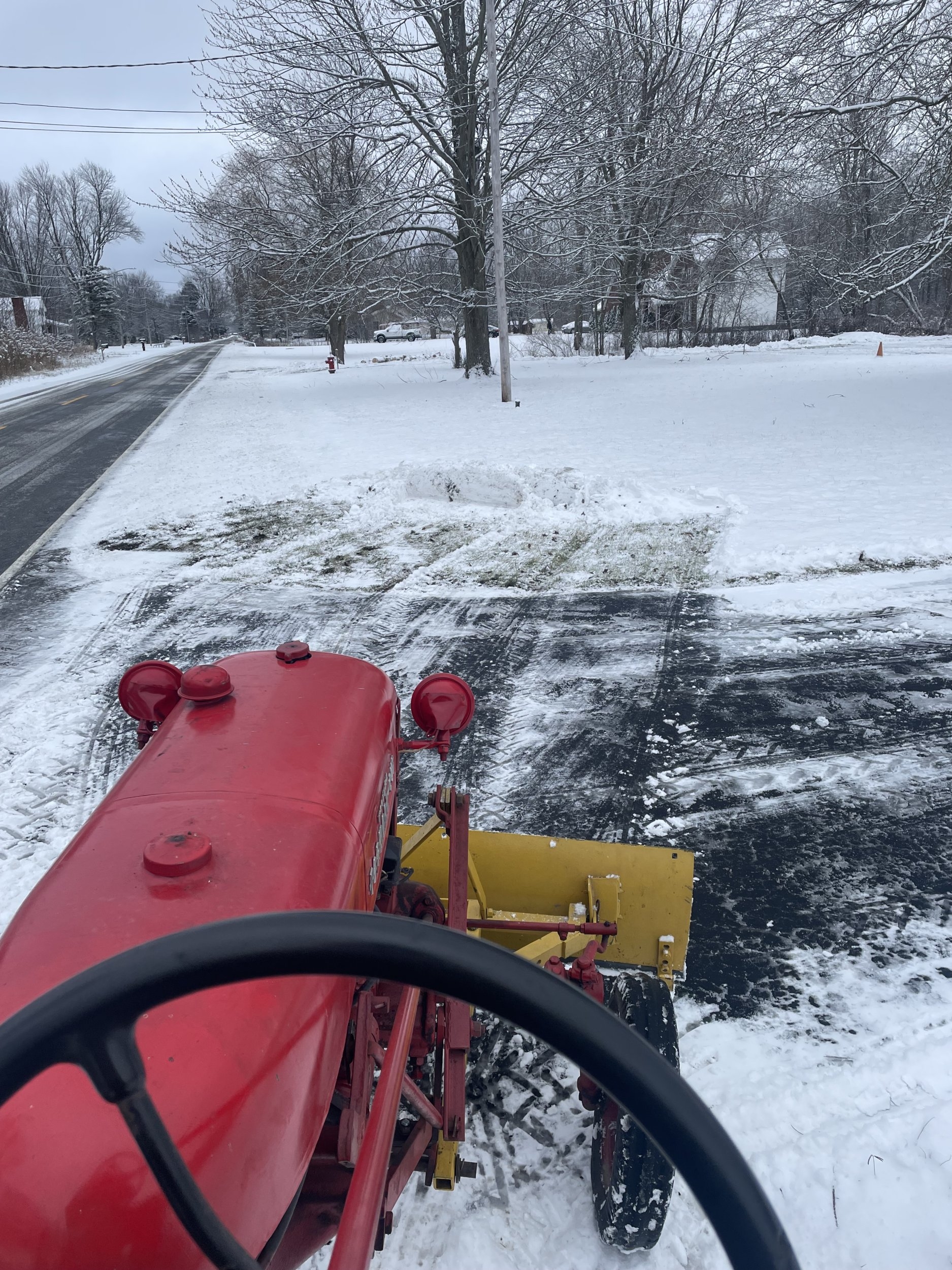

We got our first measurable snow of the season today. Just over 2” on the driveways when I looked out this morning. It is supposed to get up into the upper 40’s in a couple days so I’m sure it would have all melted on its own had I just waited.
I was wanting to see how the new blade and rear ballast modifications I did recently would work, so I tried it out. It worked very good. I doubt that I got more than a stone or two on the grass, while plowing the stone part of our driveway. The schedule 80 pvc pipe on the bottom of the blade did good.
It pushed very good with no chains on the tires. The rear R1 tires are loaded and have iron weights on them, plus I added a couple hundred more pounds with the big steel plate I bolted to the drawbar. Put my 200 plus pounds on the seat, and that little 10 hp glorified snow shovel can really push. I couldn’t get it to spin the tires at all, it just kept on pushing until I lifted the blade.
I’m not going to put the chains on the rear tires until the ground freezes up good, and it might not happen this winter, the way it’s looking. This thing works great for light snowfalls. The only thing I didn’t get to try was the lights.

On a stone driveway, you more than likely won't have to worry about chains until you get some ice underneath for one reason or another.
It looks like you're rear tires are running in a bit of the plowed snow. Not much of a problem with 2" of snow but guessing with deeper snow, snow may roll back in the wheel track.
Glad the PVC pipe on the cutting edge worked for you, hope it holds up. If it doesn't you can always opt for steel pipe like I did, now that you see how well it works. Good to see an idea I saw on a tractor forum (maybe this one) is being passed forward.

It looks like you've had enough experience clearing your drive, you know to push snow to the far side of the drive at the end. I plowed snow for ODOT here in Ohio for 32 years and the amount of people that pile snow on both sides of the drive then complain we plowed the snow back on to their drive still amazes me. Push it all to the far side in the direction the road snowplow travels, and the problem is solved. I even push the edge back 10' or so before the driveway to give the road snowplow a chance to clean out. You'll still get the snow off the road surface, but not like they are kicking the snow along the edge, or what's piled alongside their driveway they pushed up on there too. I've actually had people ask why we don't pick up our plows when we go by driveways, and not plow the snow back in they piled up on the "wrong side of the drive." When you explain to them to push all snow to the far side of the drive, you normally see the light bulb come on.
Worst of all are the one's that push it right back out on the road. I've stopped more times than I can remember and tell them if they are out that if someone hits that snow they pushed out there and causes an accident they are liable. I always got the same deer in the headlight look, but they quit pushing snow out in the road..!!
