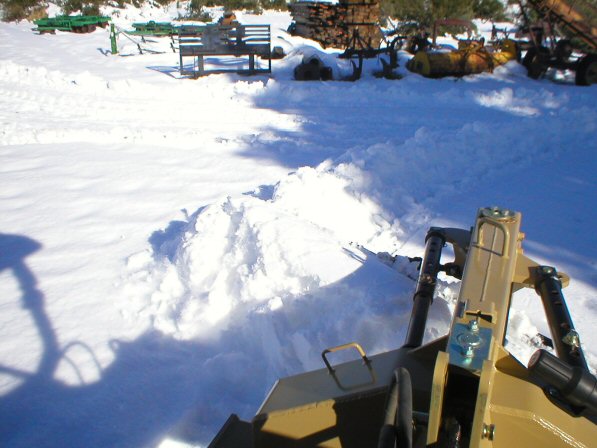

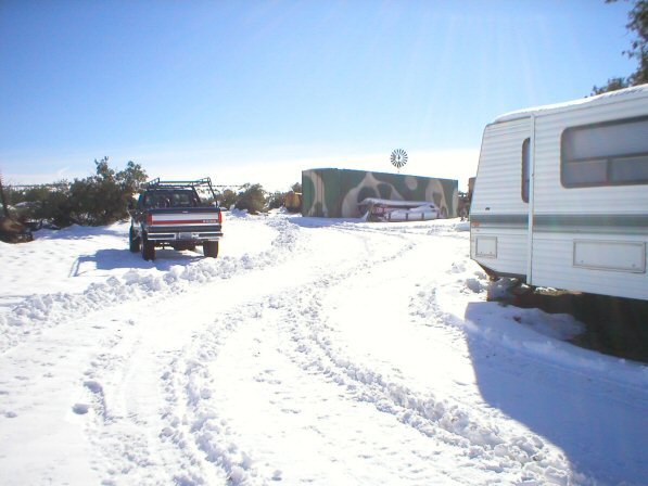

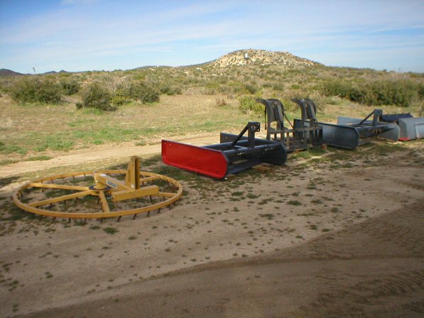

Hard to beat what can be done with a good rear blade. ;) Don't get me wrong, the landplane grader blades are indispesable for me. I even have 2 of them that I use, a 5' and 7'. But as we all know, there is no one implement that does it all.

Looking at your pics it seems your soil is sandy. Bet it is hard to keep in place, suspect you have to do an inordinate amount of blading to keep the road in shape. Looks like some clay would help, maybe lime the roads?
   / Brought home another toy (pics) #20
Steve, actually the roads are DG and need to be graded every 3-4 months to make them like glass. Rain, snow does not matter, the roads actually hold up very well. My brother can drive over them with his semi when they are wet and they do not get messed up. :thumbsup: When the roads are dry they are ROCK hard and when they are damp they grade very well. A big wash out for us might be 1" deep. :laughing: Been driving on the main road pretty much how it is, going on 12 years and have had zero problems. The pictures of my rear blade grading a road are actually when I was working on a new road to the top of our property. The worst part of our road is at the end down by the paved road. There are 5 properties that use the road and it can get wash board down on the flat area closer to the paved road. As you know, wash boarding is an area that is best graded with a land plane. Just one of the areas that a land plane grader blade really shines. :thumbsup: :thumbsup:
