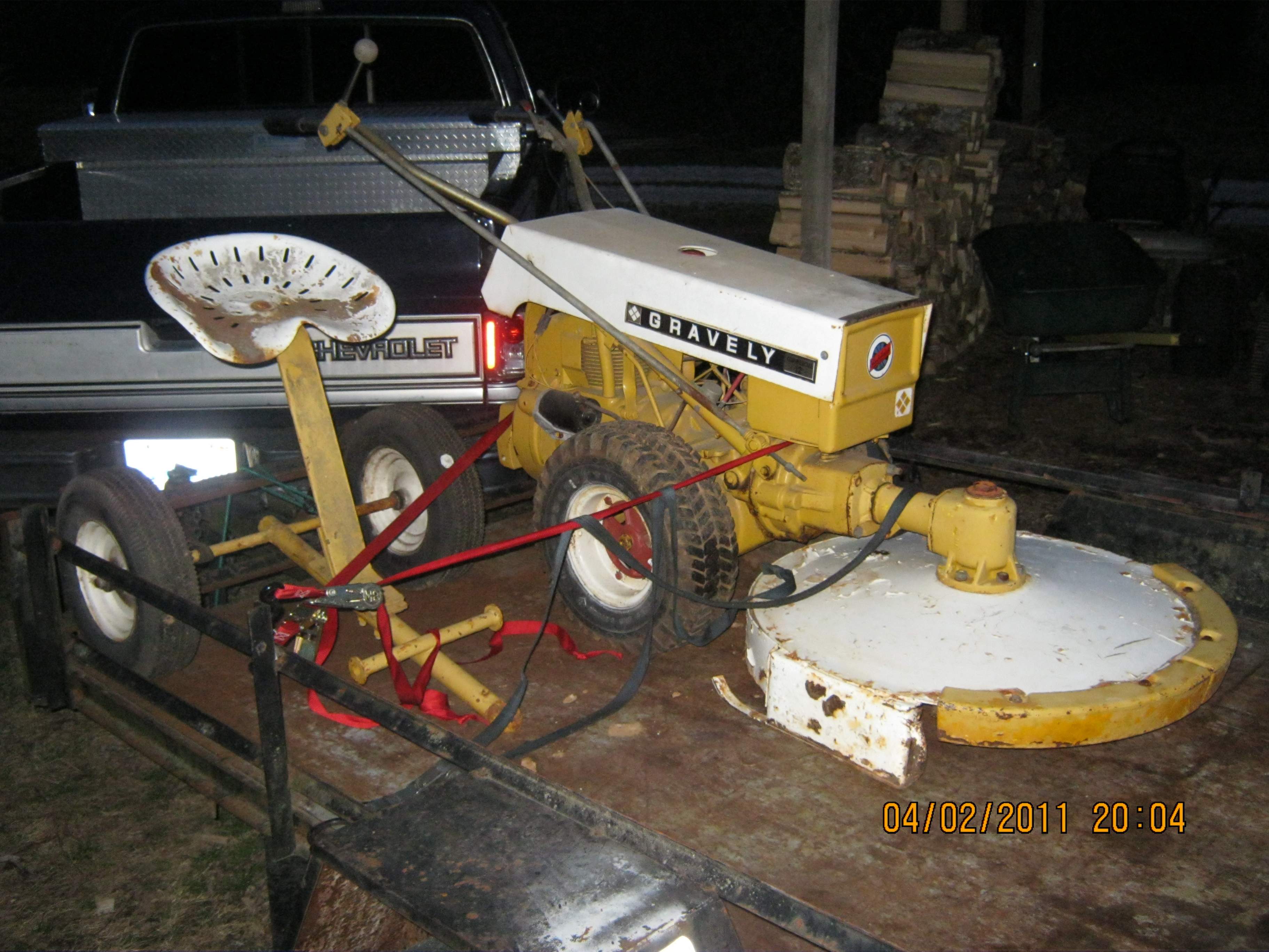

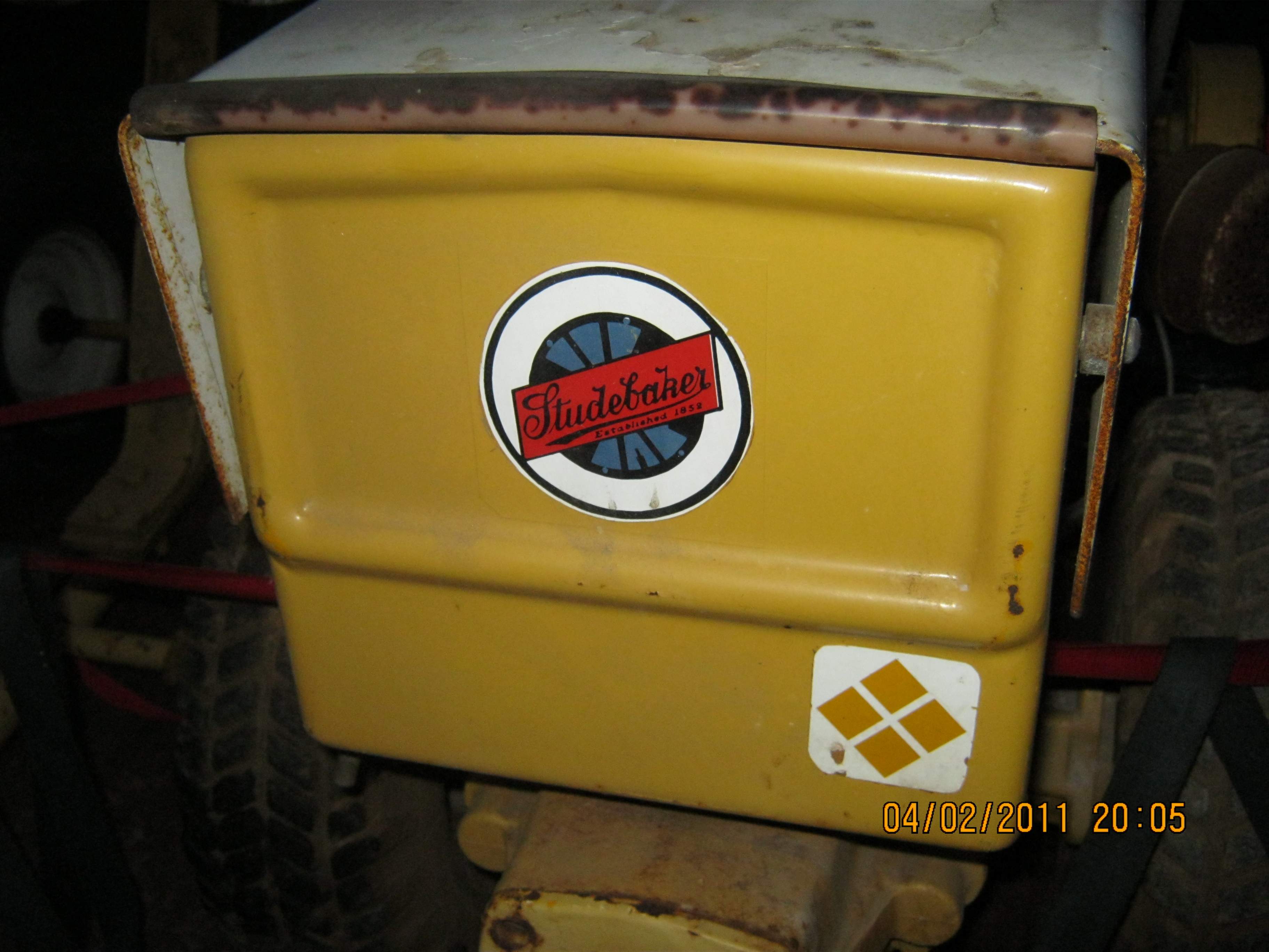

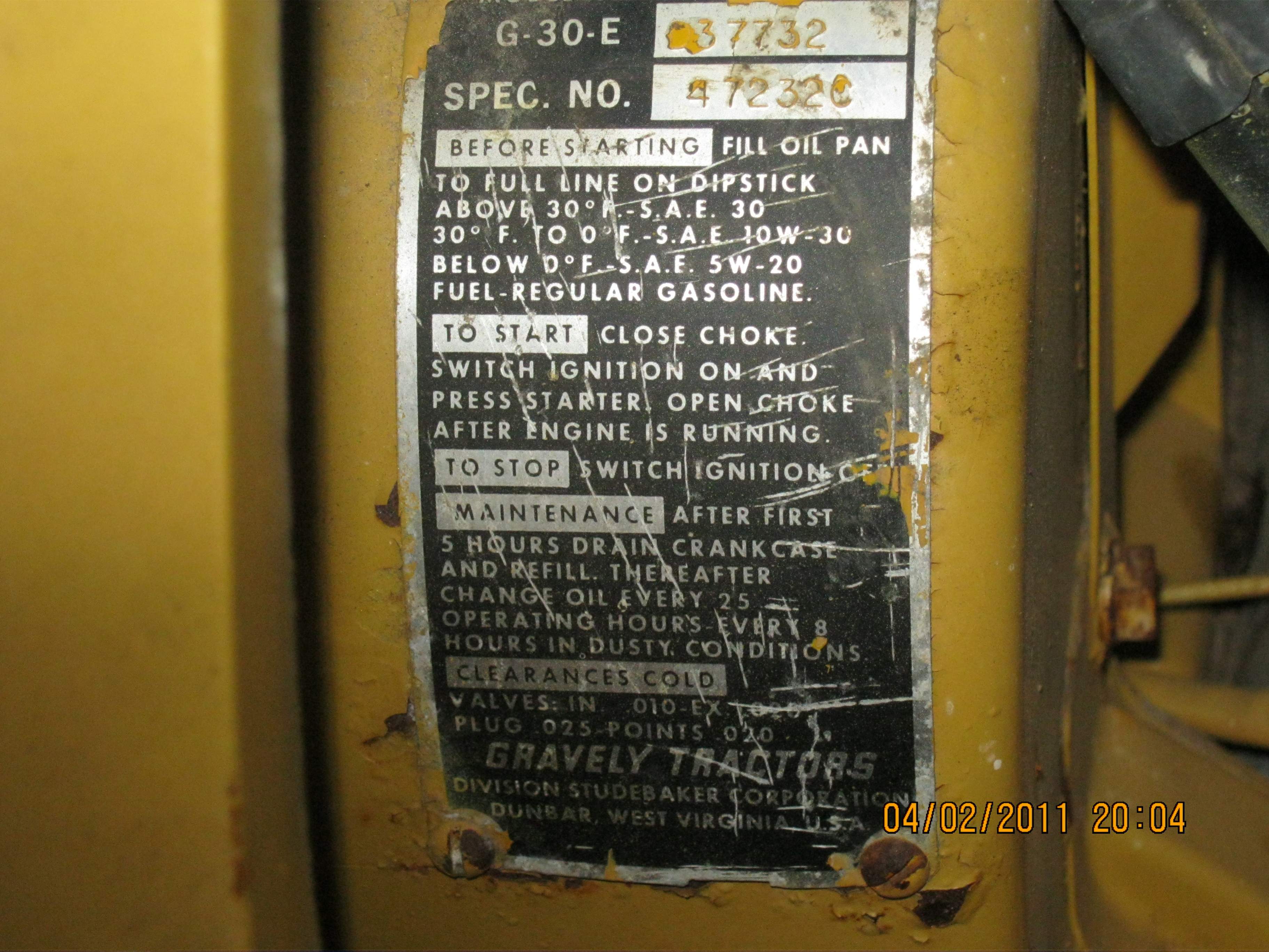

Hey folks. Finally took the plunge. After driving all day (some of it being lost) I bagged a Commercial 12. Been sitting over winter (or longer) so I jumped it off of my truck battery. It would run with ether shot to it but I can fix that. Fuel pump does work. It seems that it has something keeping the fire off of it (no spark). I noticed when I was tinkering with it at the po's house that it would quit running even with ether so I'd say it was lose spark then. Any quick thoughts on this is welcome. But it did start right up with no smoke, knocks or other noises. I can't wait to get er running. I'm going to put some pics here. There is one with the placard on the engine blower housing. Can anyone here decipher the numbers and tell me any info (year model, etc)? It has a Studebaker emblem smake dab in the middle of the front (what would be a grille).
Thanks folks
Kelly
P.S. I'm looking for a rotary turning plow in the worst kind of way. Need a good one if anyone knows of one. I'm in western N.C.
P.S.S. The tractor serial # is J-32738.

OK. Found out some info on this thing. By the serial # it was made in 1968. That per Richard at GravelyShop.com. Seems real knowledgable about thes beast and told me quite a bit about my tractor.
Mechanical issues: The key switch is the loss of fire so I got one of them coming in tomorrow. Carb was TOTALLY gummed up so disassembled and its in the carb soak right now. Kit coming in with the switch tomorrow (or so I'm told).
If all goes well, this baby outta be purrin' like a kitten tomorrow evening. I guess we'll see.
Kelly
