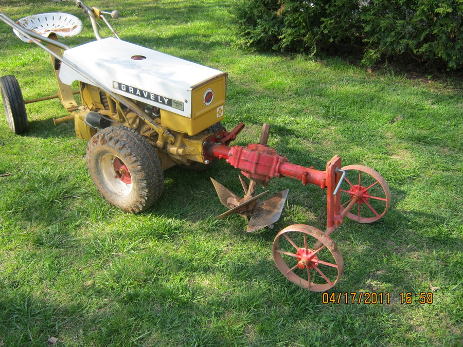

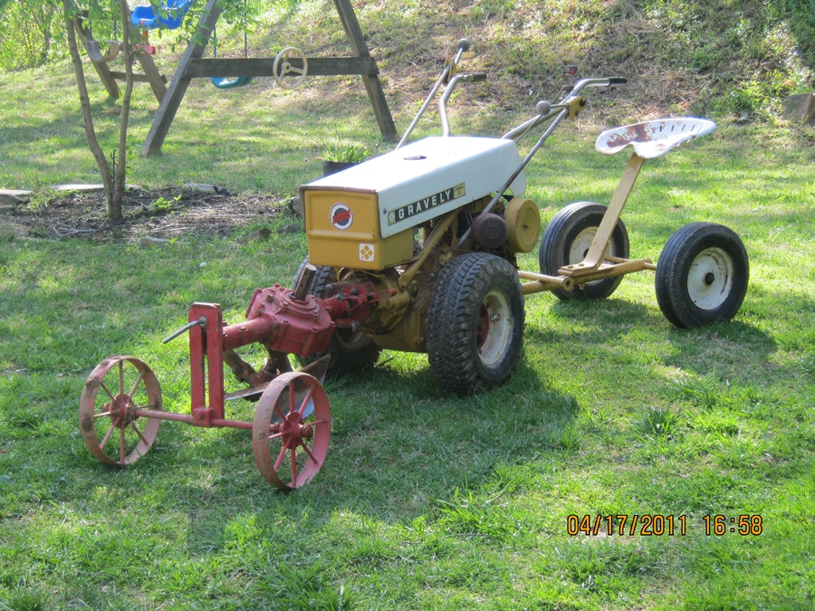

Well folks, I'm in the rotory plow business. Finally rounded up one today. Had to disassemble the driveshaft housing and clean/pack the bearings and now I have to say its good as new. I got the complete plow with dirt shield, 2 gear cases and 2 driveshaft housings in the deal. Now all I need is a dry spell to dry out the ground. I did take it to the garden and made a few passes with it and it worked great but it is real muddy. Hopefully we'll get a rest from the rain.

The old rotary plows have bronze or brass parts in them. Be sure to use gear oil that is suitable for bronze parts. I had to get it from my local oil jobber because none of the box stores carried it.

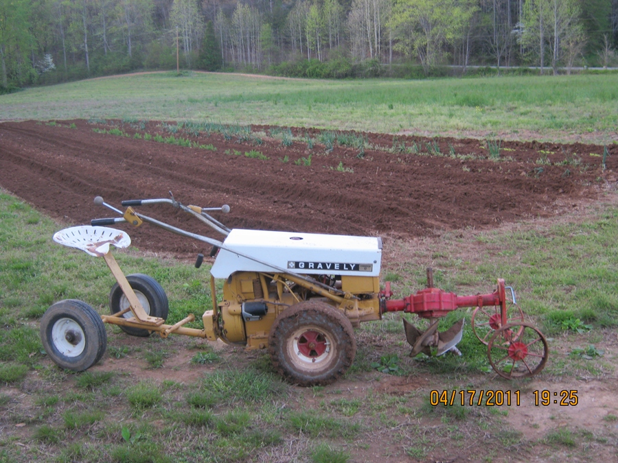

Ran the rotory turning plow through the whole garden plot today. Ready to plant. Man I really love that thing. And I found (as I suspected) that the old girls not charging. I checked with a DVM of questionable accuraccy and it read battery voltage but today I got the plow hung on a monster of a rock and it chugged the tractor down to a stop. Went to crank it back up and, not enough juice to turn the engine. I hooked up jumpers to my truck and let it charge for around 10 min. and finished my plowing. It runs a long time for something that isn't charging but I guess its time to drag my nose through the manuals and find the trouble tree for the charging system.

I may be getting my kohler engines confused, but as I recall, there is a solid state gizmo attached to the engine block that needs to be tested, and if it is good, then you may have a stator problem under the flywheel.
   / Brought the old girl home today #20
The battery is oversized on those tractors. The reason for it is they wanted more weight to balance the machine.
THe way to troubleshoot is to measure the ac voltage coming into the regulator/rectifier. If the AC voltage is within spec and the regulator output is connected to the battery, and the regulator case is grounded, then the regulator is bad. Check the terminals on the regulator. Corrosion will cause the charging system to not work.
