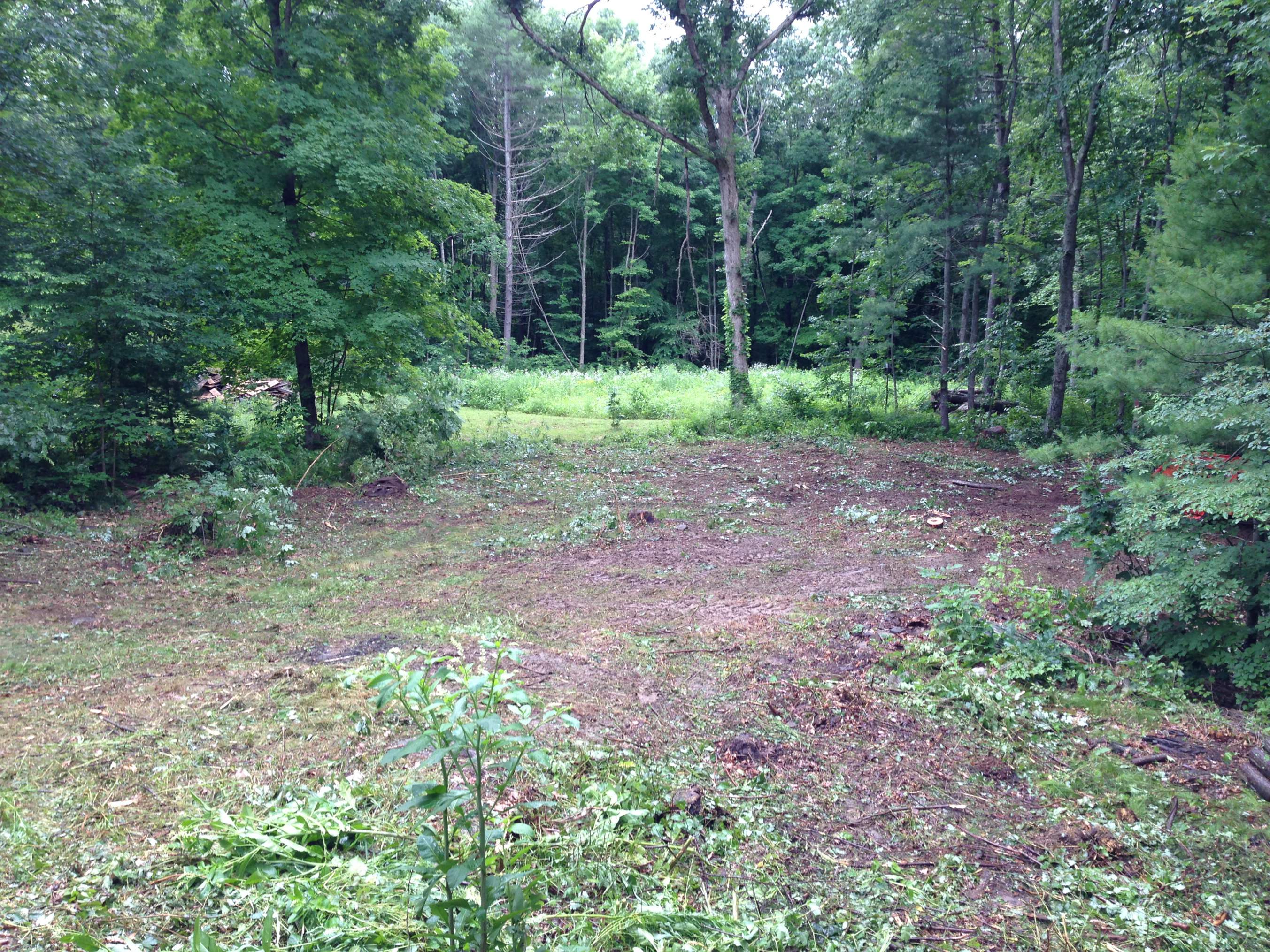

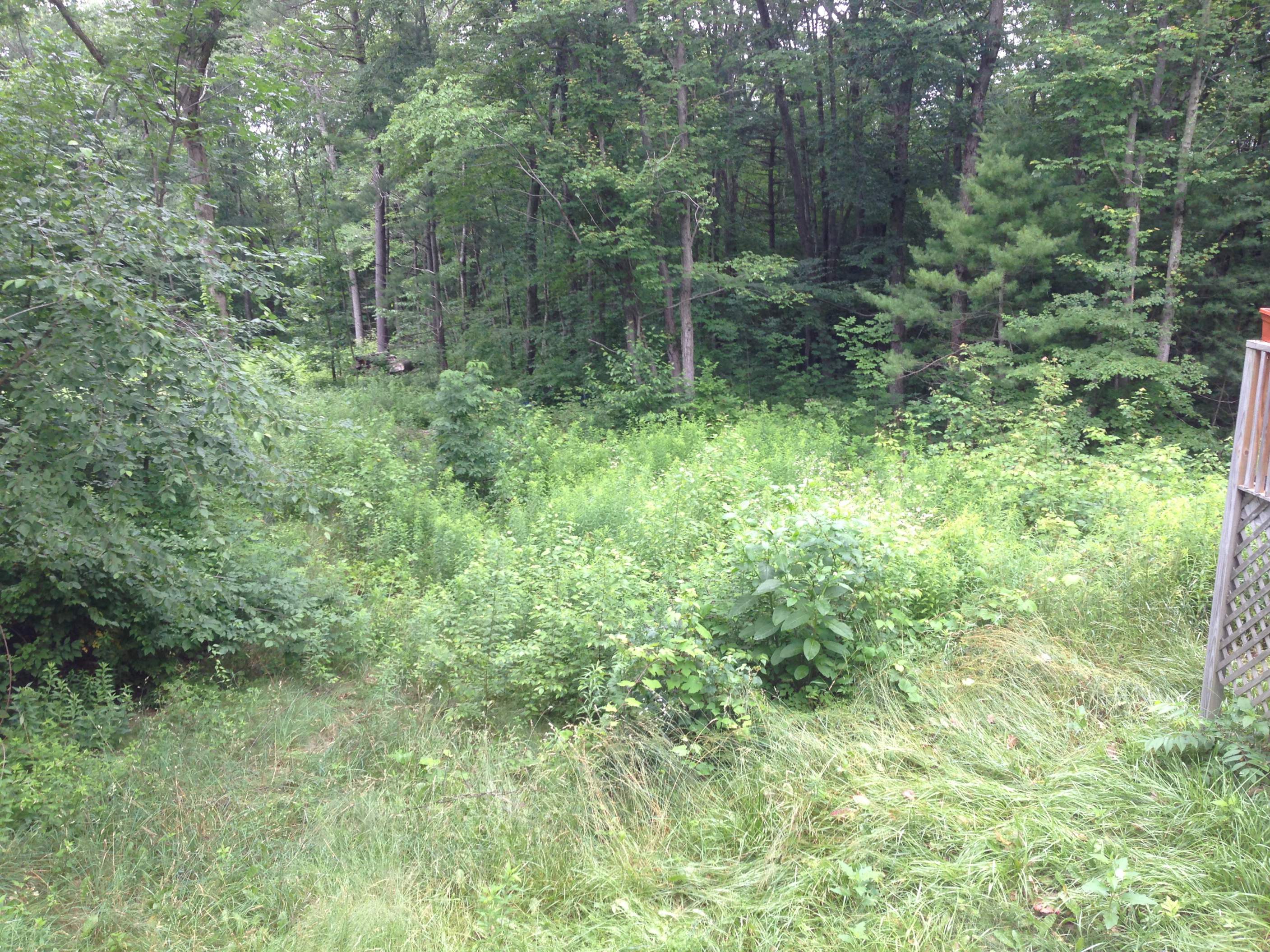

I did a small job the other day and used my rotary cutter so I figured I'd take some pics and post them. Of course, now I wish I got off the tractor more and took more pics :D But here is what I have.
I loaded up the trailer, probably a little more than I should have (really need that gooseneck!) with my equipment. The customer wanted a small area mowed, then some trees taken down, stumps ground, and a small area graded. I started off mowing the brush, which was mostly all small diameter overgrown weeds, however there were a few 3" hardwood saplings thrown in that didn't slow me down :D

I wonder where is the cutted bush after mowing? self collected?
Jack,
I did not remove any brush by hand. What you see in the photos is how it looked after I ran the mower over it. With the high blade tip speed of the mower, in combination with a slow travel speed, it mulches up whatever I mow pretty well. There were very few cut saplings left on the ground, many were mulched up into small pieces.

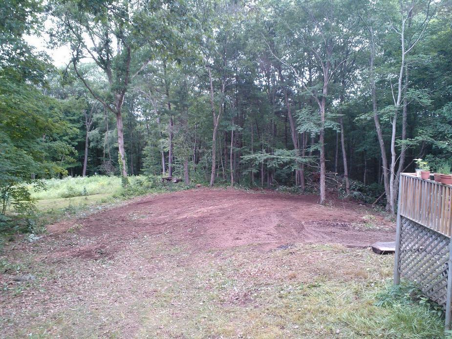

Here are a couple pics after running the box blade over it and smoothing out some of the areas.

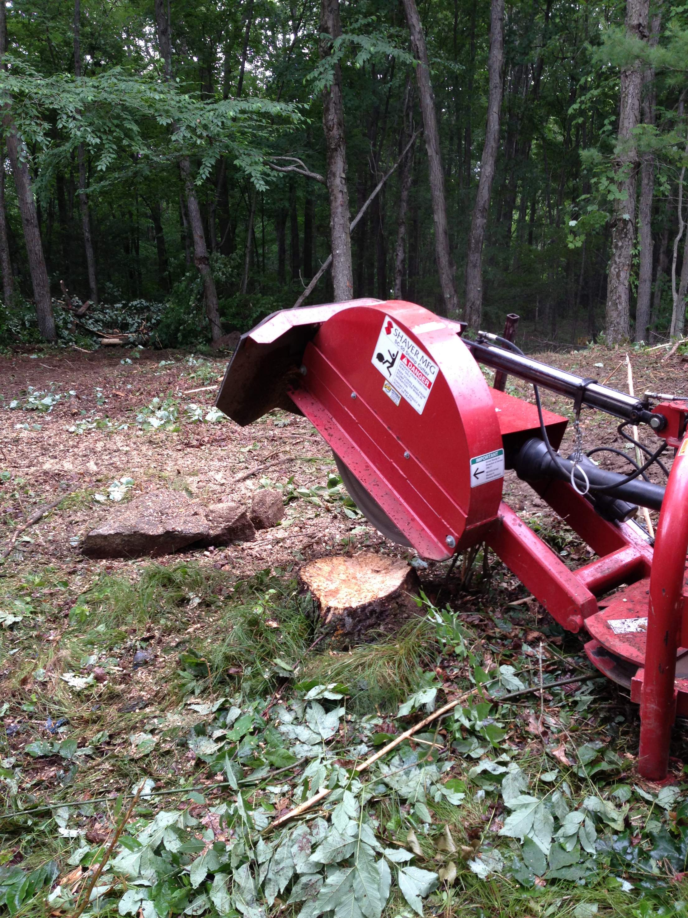

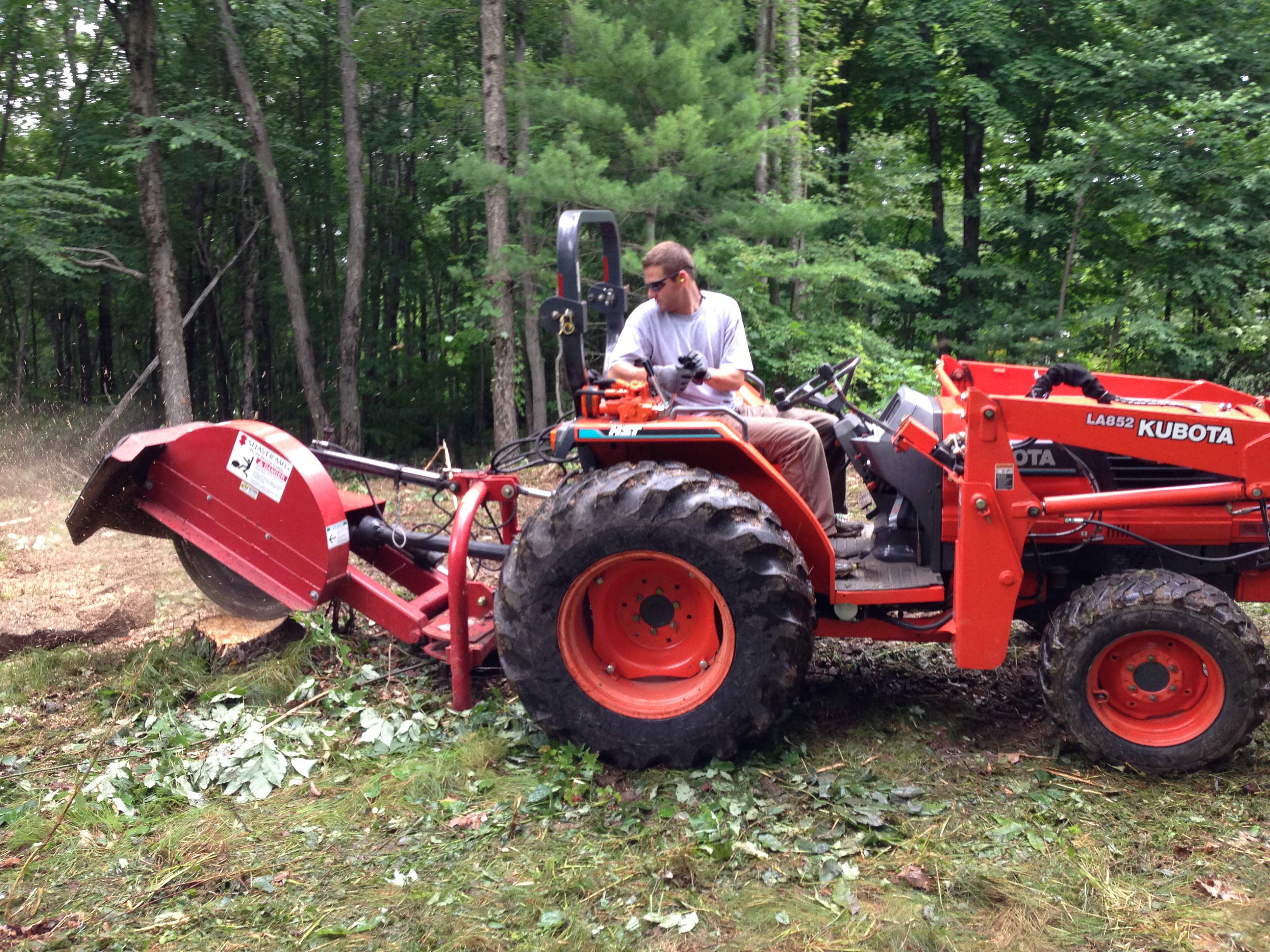

I found there is a tree stump in the photo, is it cutted by the mower????? it's really big of its diameter.View attachment 327014

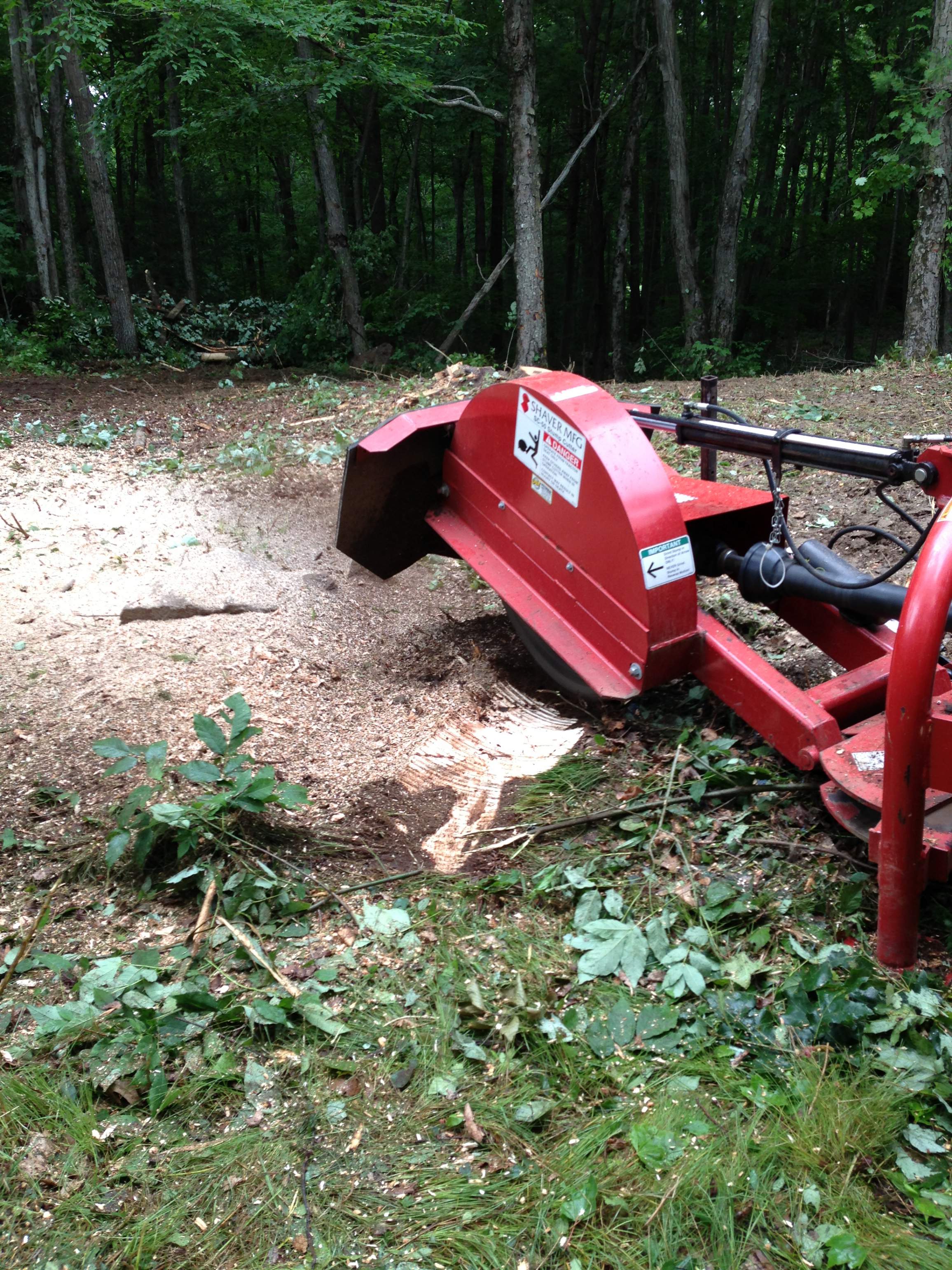

There were about 8 stumps before I got there, from old trees being cut down. Then I cut down close to 10 more trees, with only 4 or 5 of those trees being of any size. I could not cut them with the rotary cutter, maybe if I had one of Brown's Tree Cutter's I could have taken some down, than and a 150hp tractor :D
I ground the stumps down 8"-10" below grade using the PTO stumpgrinder. Some of the stumps had good size rocks embedded into the stump, and when I hit those I stop as they will tear up the teeth pretty bad after not too long.
Here are a couple pics (the few that I took) of some of the stumps. You can see in the last couple of photos I posted that there are no stumps to be seen.

Anyhow, you are telling Jack and me that all that undergrowth, bushes etc just got ground up and disappeared when you hit it with the mower??
That is exactly right. I did not do any sort of cleanup with a rake or anything like that. Here is exactly what I did on that job....
Arrived, unloaded the equipment, started mowing almost immediately (I had already checked out the site a few days earlier). Since I could barely see what I was mowing, due to it being so thick, I went very slowly and mowed a lot in reverse, which you have to be a little careful doing but I haven't had a problem yet. There were a handful of old stumps already there, from old trees that were cut down a few years ago, and the customer warned me about them, so I took my time and kept a watchful eye. Many times I would back into some thick brush, and run into a stump or rock. The mower would shake pretty good, the blades would get battered, and the slip clutch would start smoking. I would then pull away or lift the 3 point hitch and the mower would go back to normal run up. Then simply go back to mowing. It didn't phase the mower at all and there was/is no damage. This thing can take a beating.
After mowing, I parked the tractor to take a couple pics, the ones I posted in post #2, the first "after" pics. I then put the stump grinder on, ground down all the stumps, and a few good sized rocks by accident :laughing: Then when the stumps were gone, I put the box blade on and started leveling a small area for a future raised bed garden that his wife wanted. I also ran the box blade over the entire area to smooth everything out and then cleanup some of the debris left behind. This is shown in my last couple "after" pics in post #5.
The reason for the good mulching action is because of the high blade tip speed, as well as slow ground speed. Many people mow with their PTO at less than 540 RPM, I almost NEVER mow less than 540RPM, because the cut is no where near as good, and when your doing paying jobs, people want a good quality cut, with nice looking results. The customer was very happy with the outcome!
