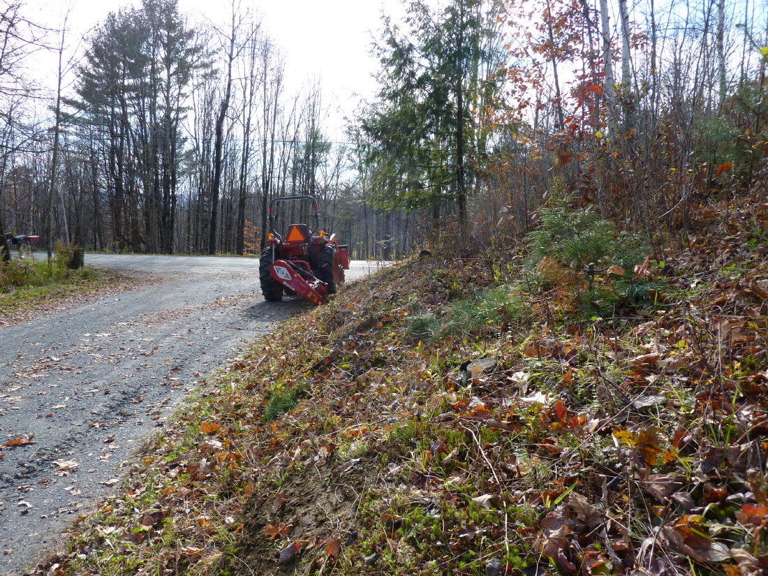

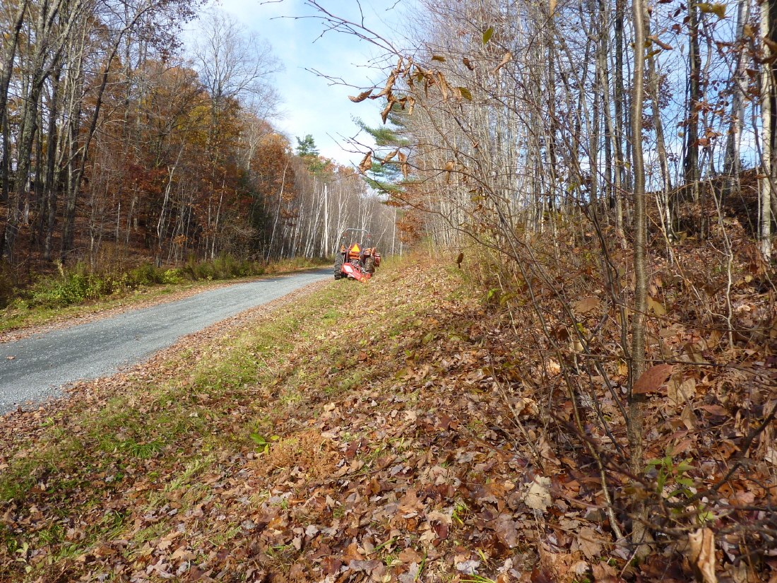

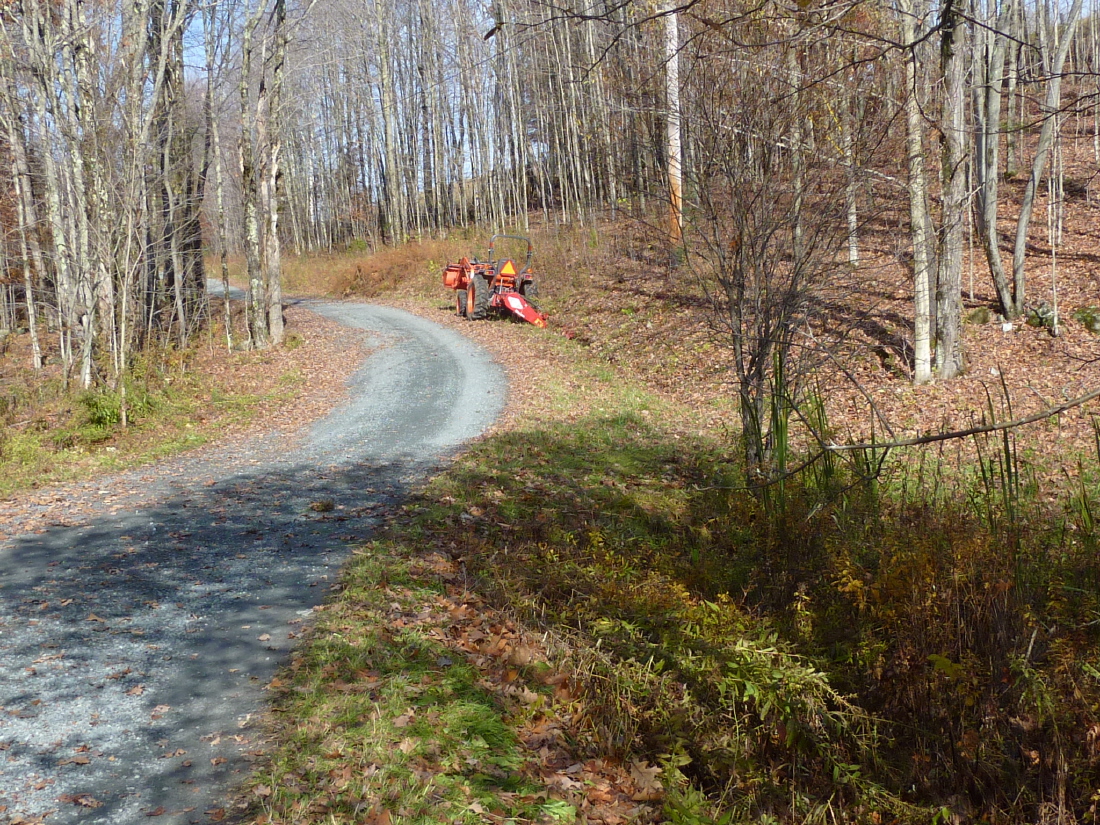

I'm not sure if this will work for you but I uae a sickle bar mower on my road side. Works well for what I have.
