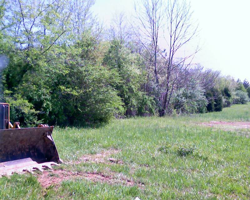

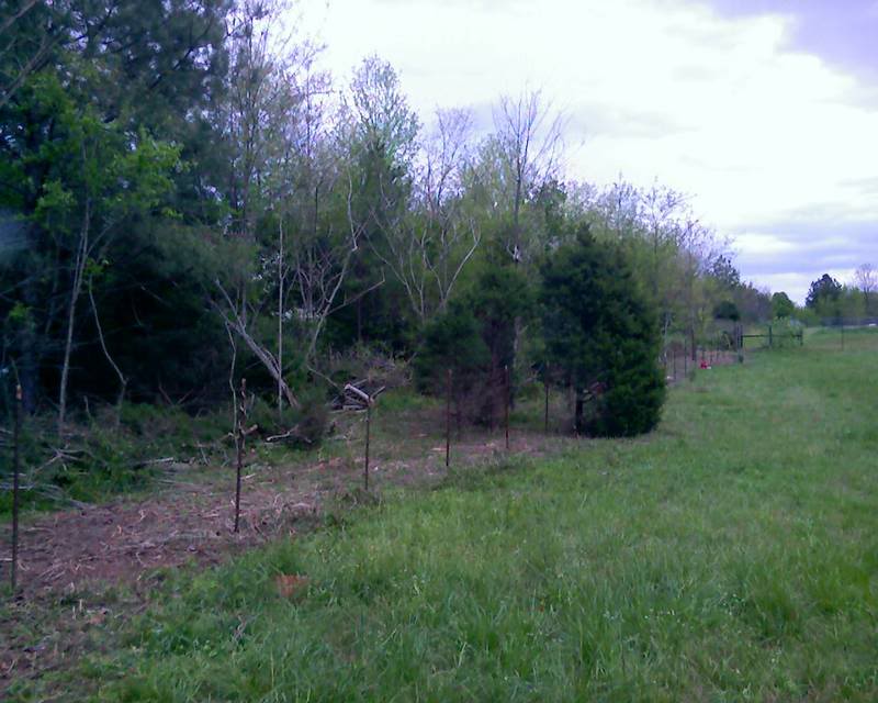

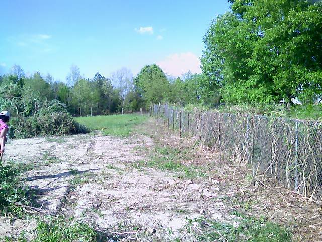

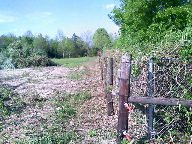

I find them indispensable, especially under fence rows. In fact I use the 3 bladed brush knife blade 3-4 times as often as I use the string head. Here are some before and after photos of some fence rows I cleared out using a Stihl FS-250 and a brush knife blade.

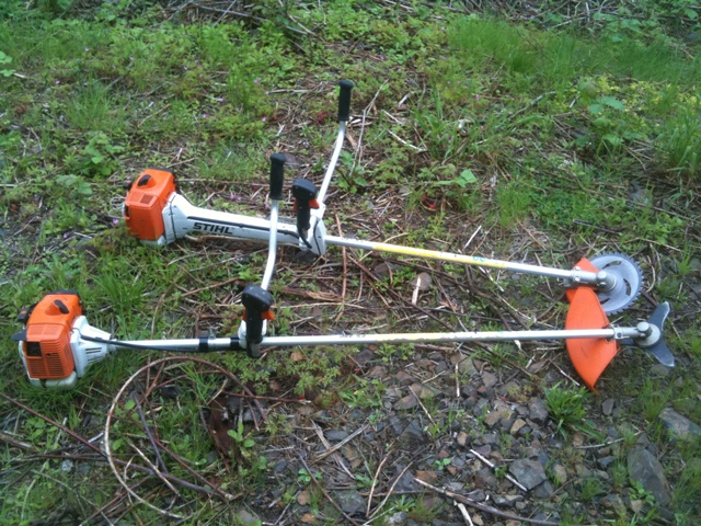

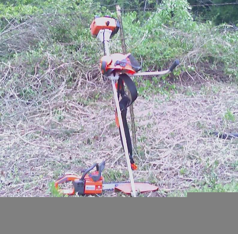

You definitely want the correct kit for the job. Never saw where you posted the type of trimmer you are try to set up.
I have many many hours with both the three blade knife and the chisel tooth blade on my cutters; FS450 and FS250 doing forestry work.
One of the details that I have not seen anyone else address is the harness and the bike handle.
DO NOT try to use the little loop handle trimmers for cutting with the metal blades.
Could it be done, probably, but your risk level goes through the roof.
The cost of setting it up correctly is far less than one visit to the ER.
There is a very good safety reason to have the body of the trimmer attached to you by the harness and to have two hands on opposing bike handles versus the loop handle.
Oh yes proper safety head and eye gear is mandatory as well if you like being around and seeing your family.
