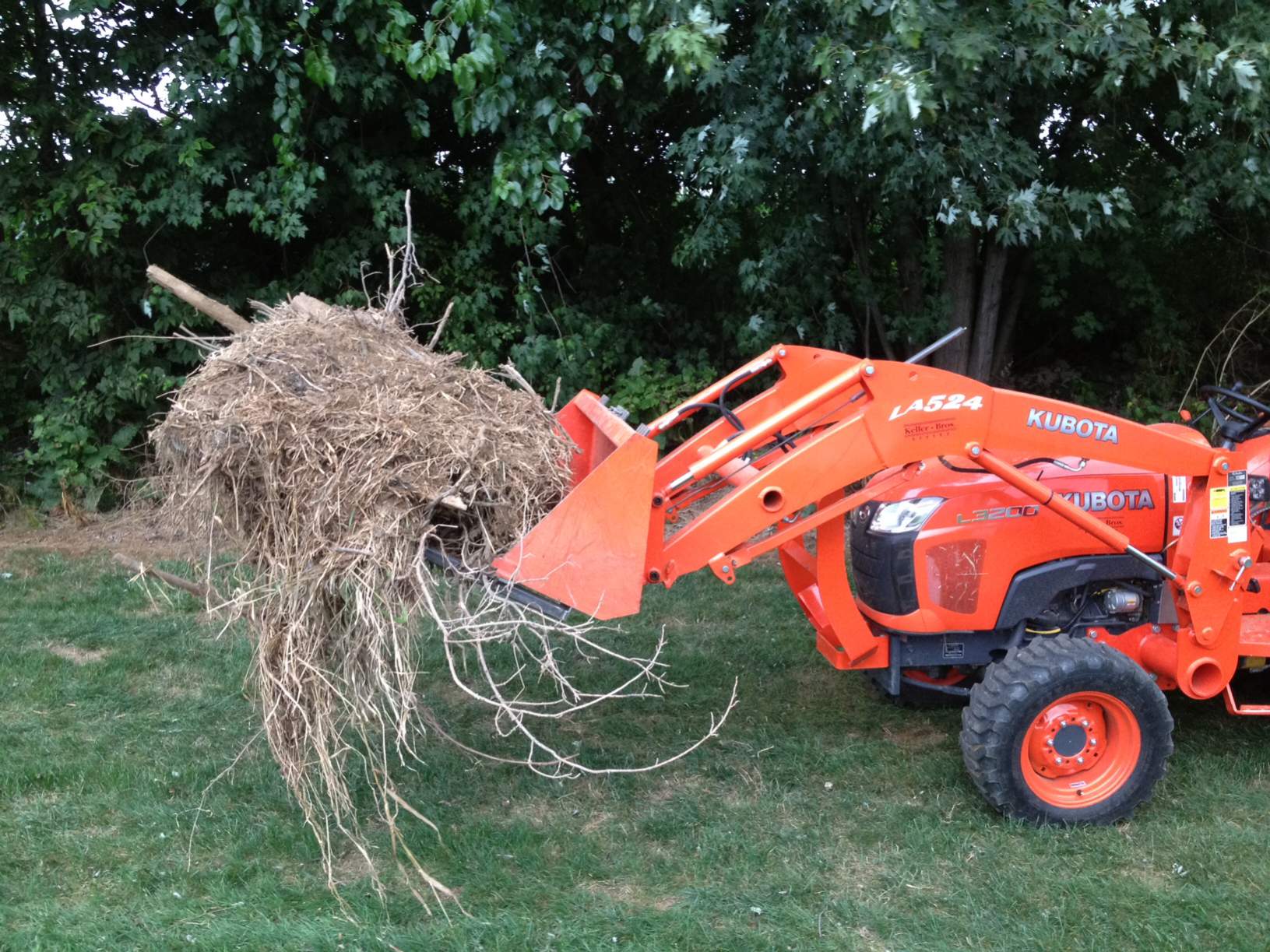

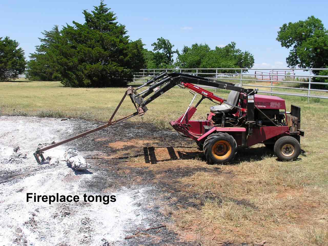

Thanks guys!

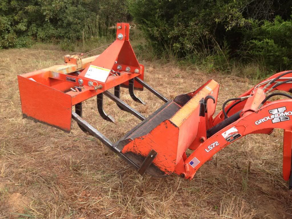

I found the forks to be an easy way to move my box blade around!

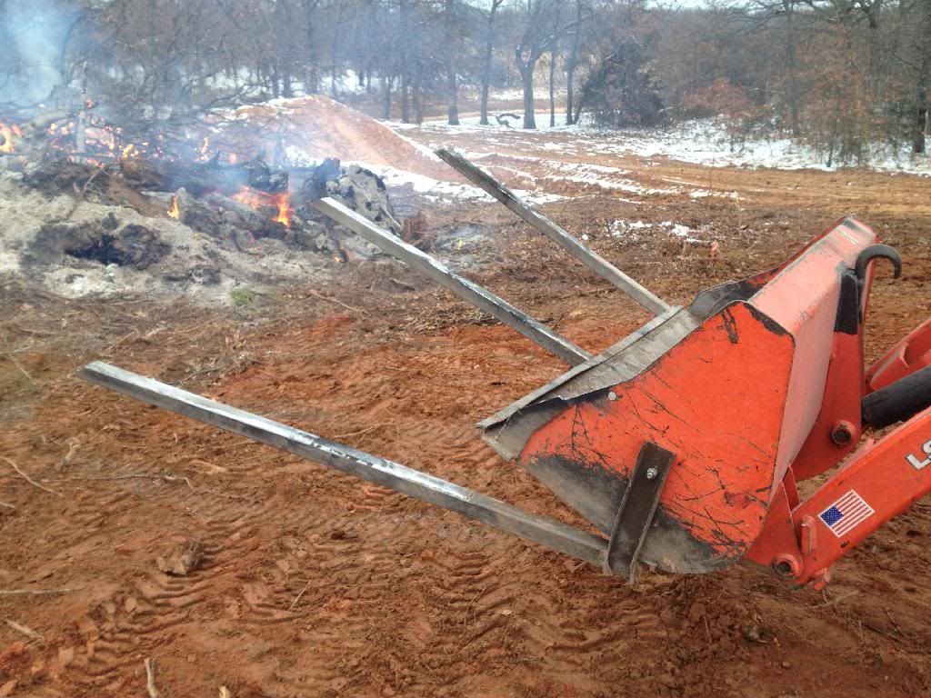

Here is a video I made while burning cedar trees. I used the tractor and forks to "feed" the fire. Too much fun!

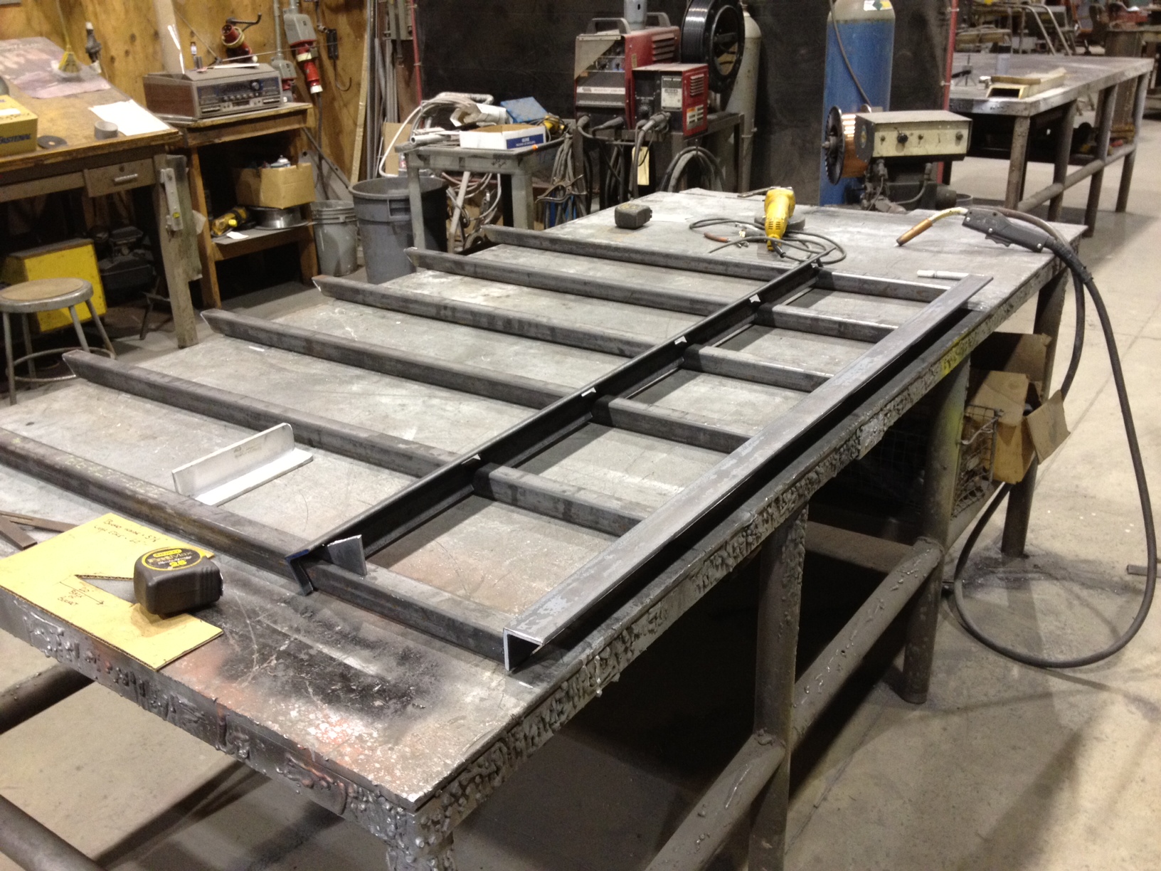

What size square tubing did you use? I was planning to make a grapple but this seems very effective and much easier/less expensive

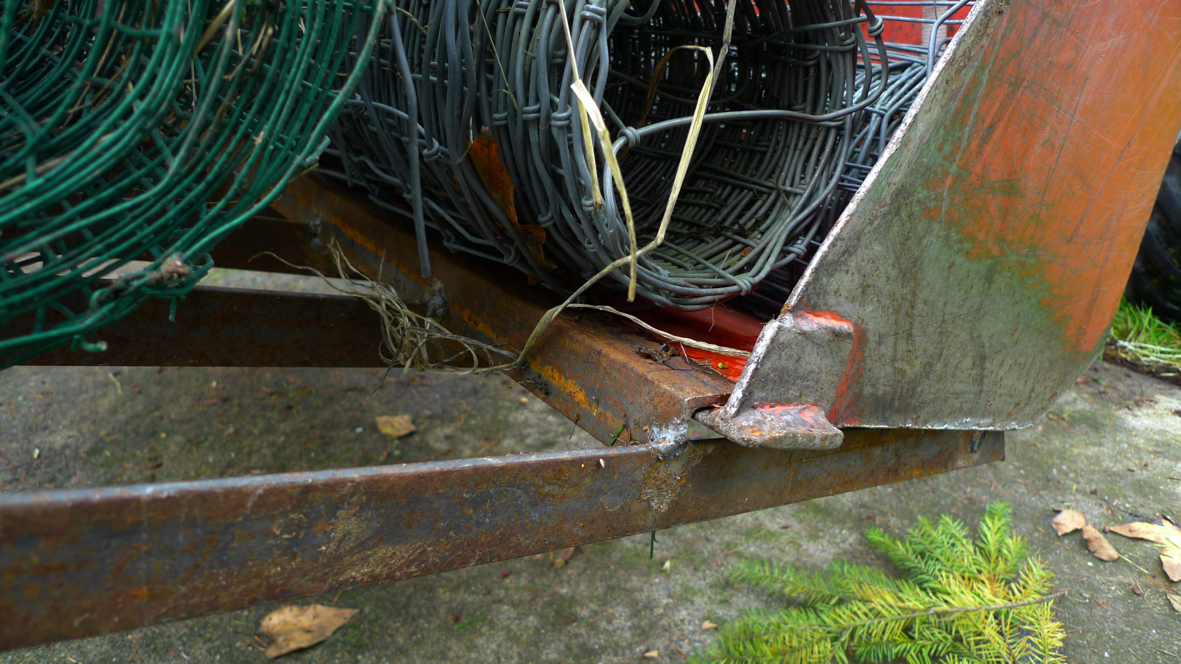

   / Brush Forks for 23HP Kubota BX2350 #18

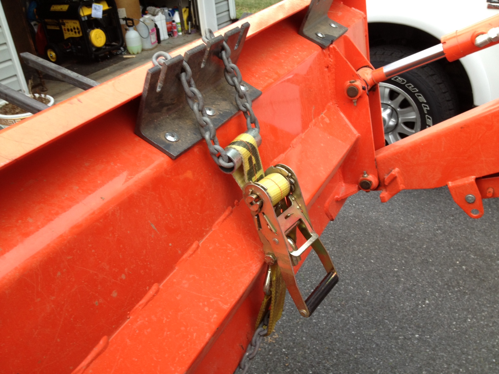

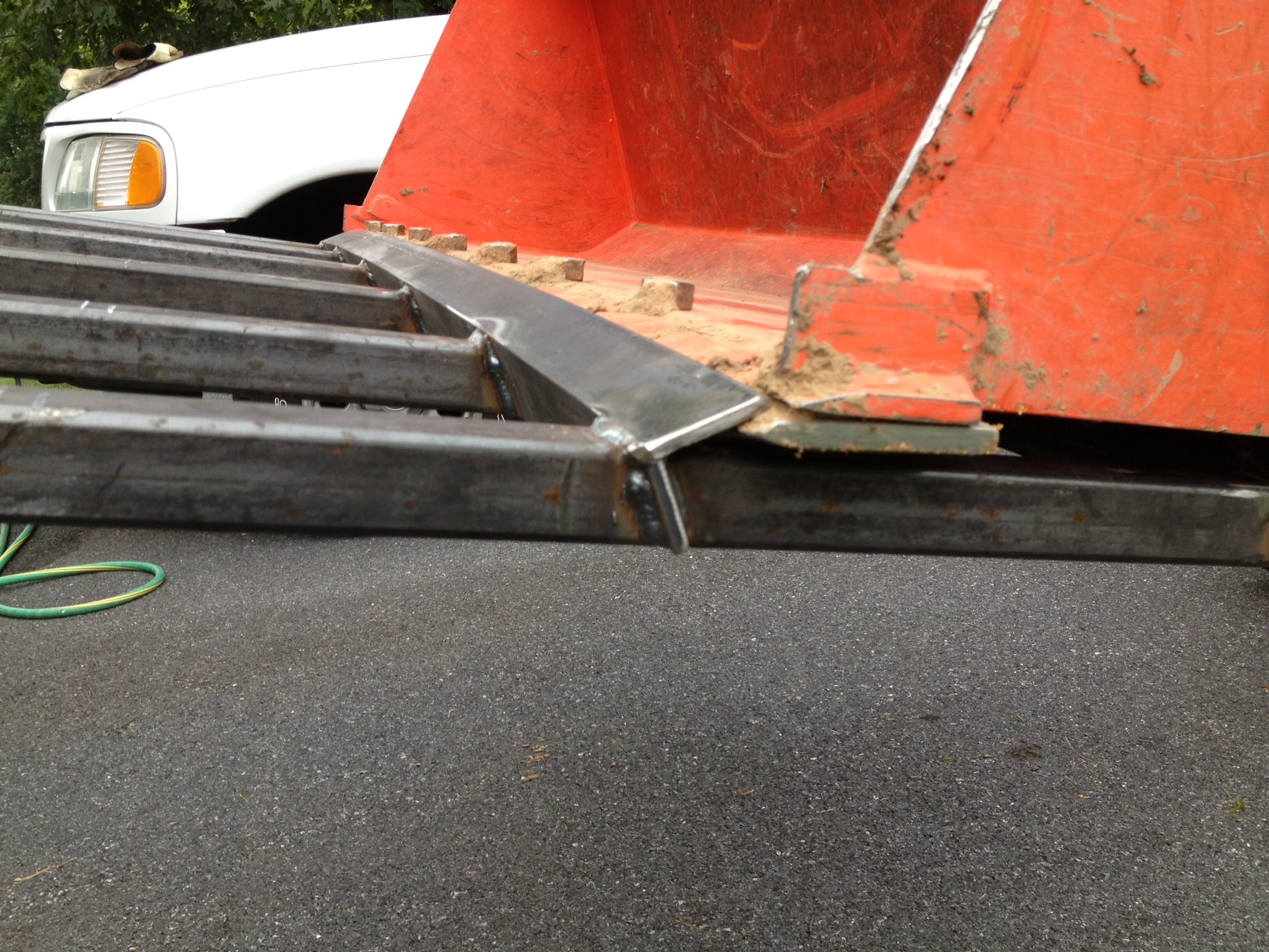

Wyobuckaroo, here's something very similar to what you plan. Material stays on without the caps being extended. They are quick on and off. I used a short piece of strap with a heavy duty ratchet strap connected to a chain bridle loop on the back end of the fork assembly. The tubes are capped and cut at a 45° angle on the leading edge. The angled end is facing down so the tip skids on the ground when going for a load.
Fork Binder.JPG Under Forks.JPG Fork Full.jpg Fork Pieces.JPG Forks Side.JPG
   / Brush Forks for 23HP Kubota BX2350 #19
I'm going to do a chain on attachment around the bucket with chain binders to keep from drilling holes in the bucket....
I also fasten mine with a ratchet strap to avoid the holes.
I noticed Chim put his bucket lip on at an angle, I left mine at right angles.
The right angle allows me to pick up the unit, move it with the tine weight holding it fast to the bucket. A quick lift of the loader arms puts it in easy reach to attach the rachet straps.
I'm not sure what size. I would measure but the forks are at our other property at the moment. I just went to a local metal shop and picked out something "that looked about right"!
After a few months of abuse I have twisted the frame severely, bent the middle fork (it was slightly thinner tubing, all they had when I went to buy it), and yesterday I finally completely broke my left fork off!
When I get time I will rebuild them. This time I will make them about 10" shorter and possibly use four vs. three forks. I haven't decided on that yet... My frame will also be much stouter and be more of a box structure.
