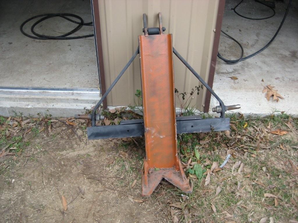

/ Brush Grabber #14
Here is a tree grubber that one of the guys built. Simple to build. 6 in channel welded to a cross bar. The owner might chime in and tell you if it works as planned. It would depend on the lifting weight.of your tractor. How I would this would be to lower it to the ground about 12 in from tree, and as you reverse, the grubber will go deeper and grab at the root area, and just keep pushing. You might not even have to lift. Just grub it.
Some hydraulic top link control would make it work really well.

/ Brush Grabber #15
It doesn't take me more than about ten seconds to wrap a chain two or three times around a small tree trunk and hook to itself. I'd imagine a nylon strap would also be pretty quick to attach. I appreciate that the brush grabber clamps hard but if a tree is so small that it bends and allow the chain to slide off then I would imagine that same tree is small enough to just knock over with the FEL. I am still unconvinced.
