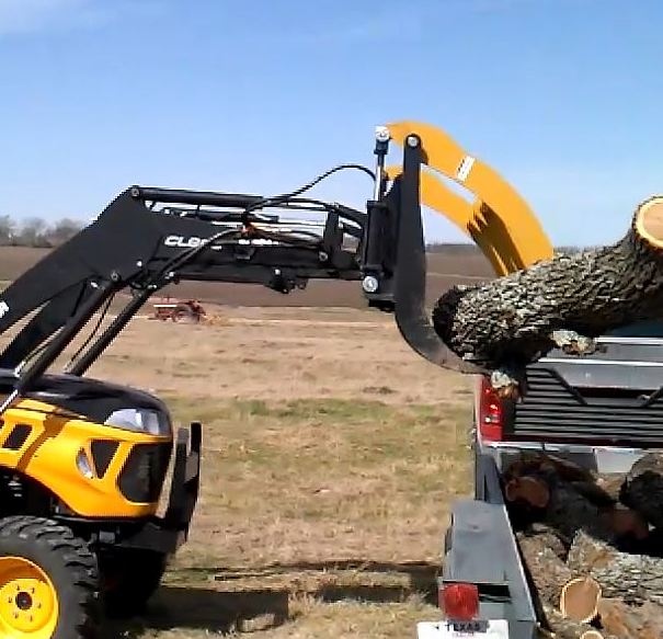

I am beyond pleased with my Armstrong Ag root rake style grapple (BGR-726). Not sure how widely distributed these are - it's made in Brenham, Texas but they only sell through their dealer network. I'll even plug my dealer, Paige Tractors near Giddings, they're great to deal with. For the price it's very well made and seems to have the geometry and hydraulics well balanced. It opens to 60". Recently I used it to place some salvaged 30" concrete culvert and was gobsmacked at how easily it handled and precisely placed each tile. I keep finding new uses for it and it's become a go-to piece of equipment for a lot of odd jobs - one of those things you wonder how it was possible to ever get along without. I run it on my Yanmar LX4500 and I had no idea a smaller tractor like this could do the things I do with this grapple. If you can find one, it's for sure worth taking a look.

Just PMed you. Anyone know of a Armstrong Ag dealer in Alabama, Tennessee, or Kentucky. This looks like the grapple I want after much reading but having never seen one operate. I have a Yanmar Lx 490. With CL600 loader (basically same as skeezaroonie. Just looking for a good match for my tractor in a root rake grapple.

I relooked at the Armstrong ag site and realized I was about to make a possible mistake in my order. Almost ordered the BGRLT 470 lbs 3/8' down tines thinking that was the one you have but yours is (evidently from the model number BGR726) 670 lb. I think I want lighter because I like to bush hog with the loader on so I can do a combination of take out this or that patch of brush or saplings and mow them up and or take the chain saw to bigger stuff and push take them to the burn pile or make a pile of firewood. If it wasn't for the mowing which in the same day I might be mowing the open areas moving at 4 to 5 MPH. A lighter loader would be better for that. Just wondered if you have any thoughts on whether yours is on the heavy side or that the tractor handles it well out in the fields on the run. Wish I knew what my bucket weighs. That would help me decide. It works real well over my terrain with the bush hog. but I am thinking it is on the under 400 lbs side since the whole loader is only about a 1000 lbs.
In a nutshell I believe I would benefit from the stronger one like yours if it is not obnoxiously heavy while bush hogging. Also I think the 64" model would meet my needs, the BRG64-5 and save 60lbs at 610 lbs if I did not get the BRGLT.
Maybe I should ask another way. Would you want to have your grapple on your tractor all the time or do you just hook up to it when you need it for certain tasks. I do most everything with my loader on. Thanking you in advance for any thoughts or suggestions.

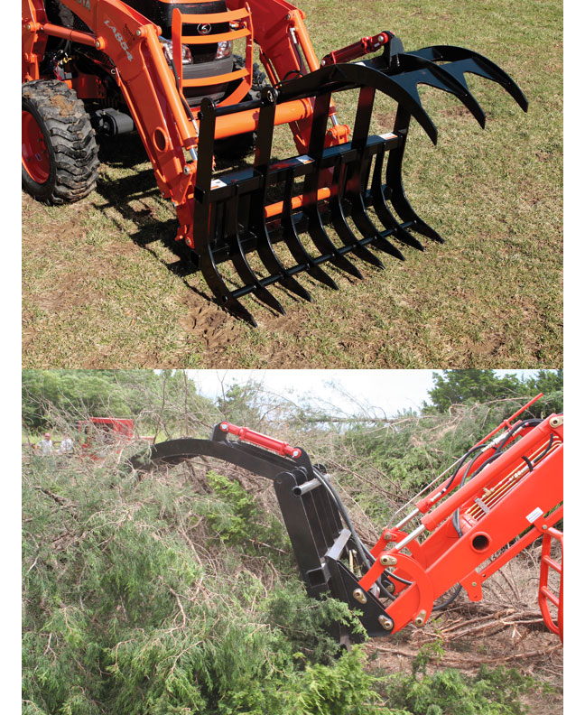

Can't help with an Armstrong dealer, but here is another good root rake style grapple, single or dual lid.
Product-10.jpg From: 333 Series "Standard Duty" - Precision Manufacturing
   / Brush Grapple, Titan, Versatech - What's Good? #29
   / Brush Grapple, Titan, Versatech - What's Good? #30
Couldn't find any prices and nearest dealer is 430 miles away. Any idea what their standard duty grapples run? Thanks
