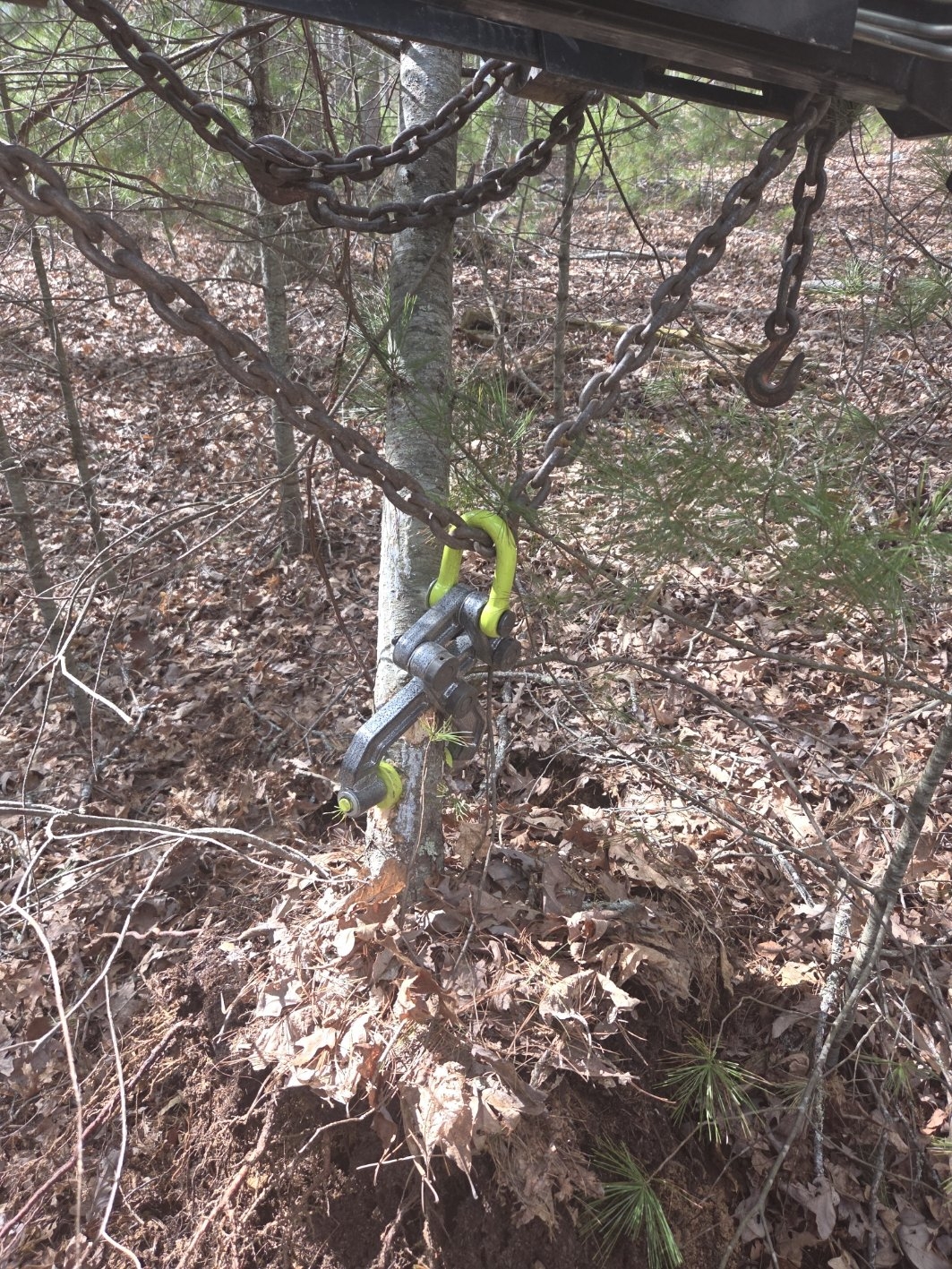

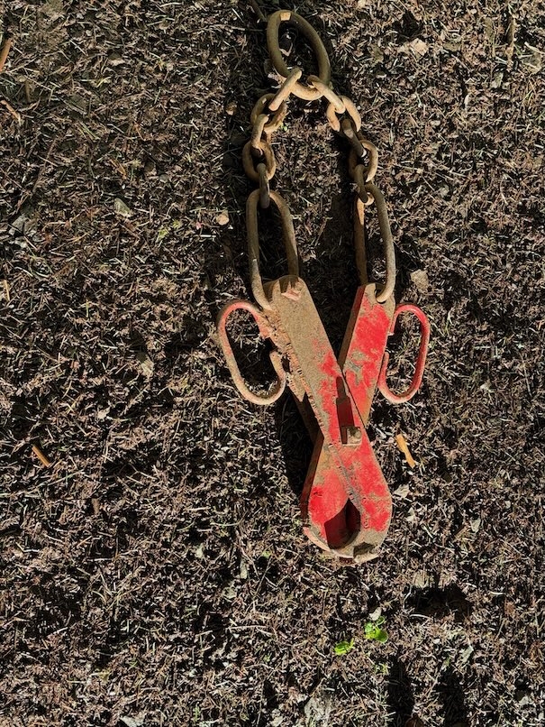

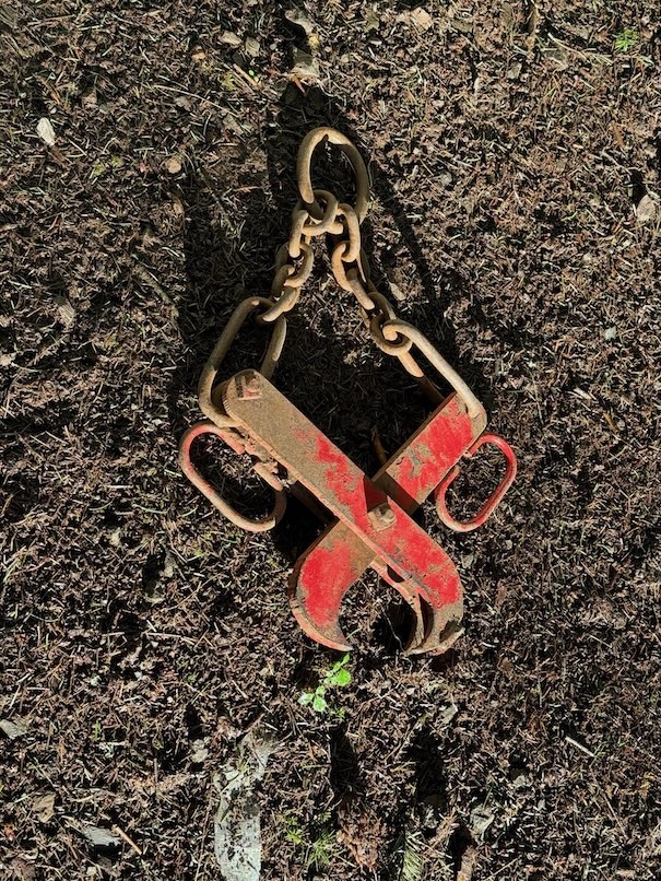

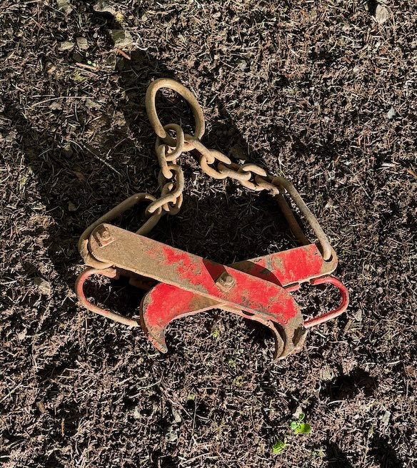

I've been waiting for someone to post something like this, but it didn't happen. Maybe there is nothing modern like it?
This came from an old farmer's retirement sale about 20 years ago. It has never slipped or failed to grip.
Widest open is around 6-8 inches and it closes to near zero. The jaws are around 1/2 inch thick

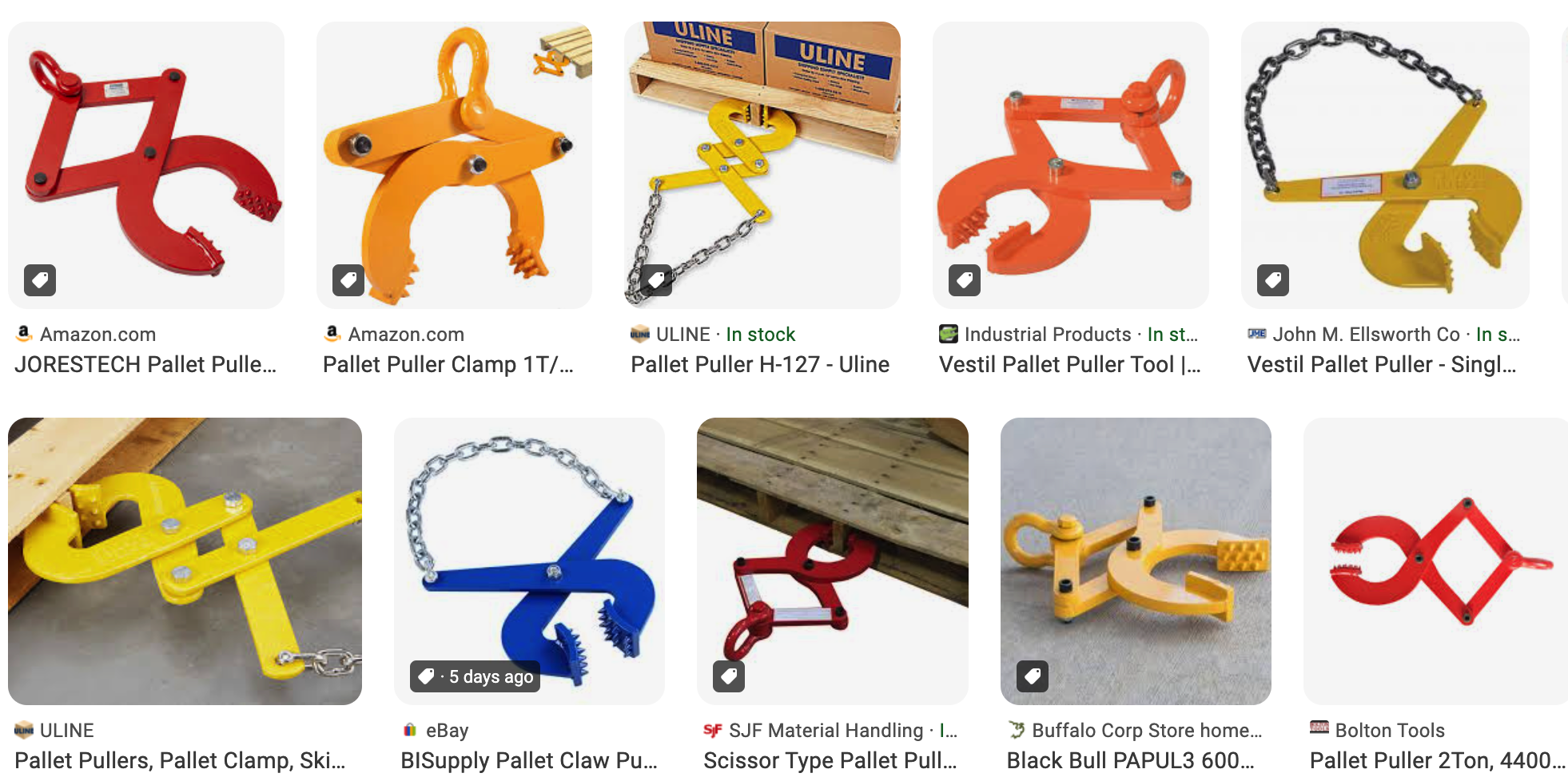

That looks like the old pallet puller. Before the pallet trucks were popular and hauled in trucks, you hooked one of these one a pallet/skid and pulled it to the back of a semi so you could unload with a forklift.
   / Brush Grubber #105
Pallet puller? Could be, but most I've seen look more like the commercial brush grubbers, but with non-rotating pads.

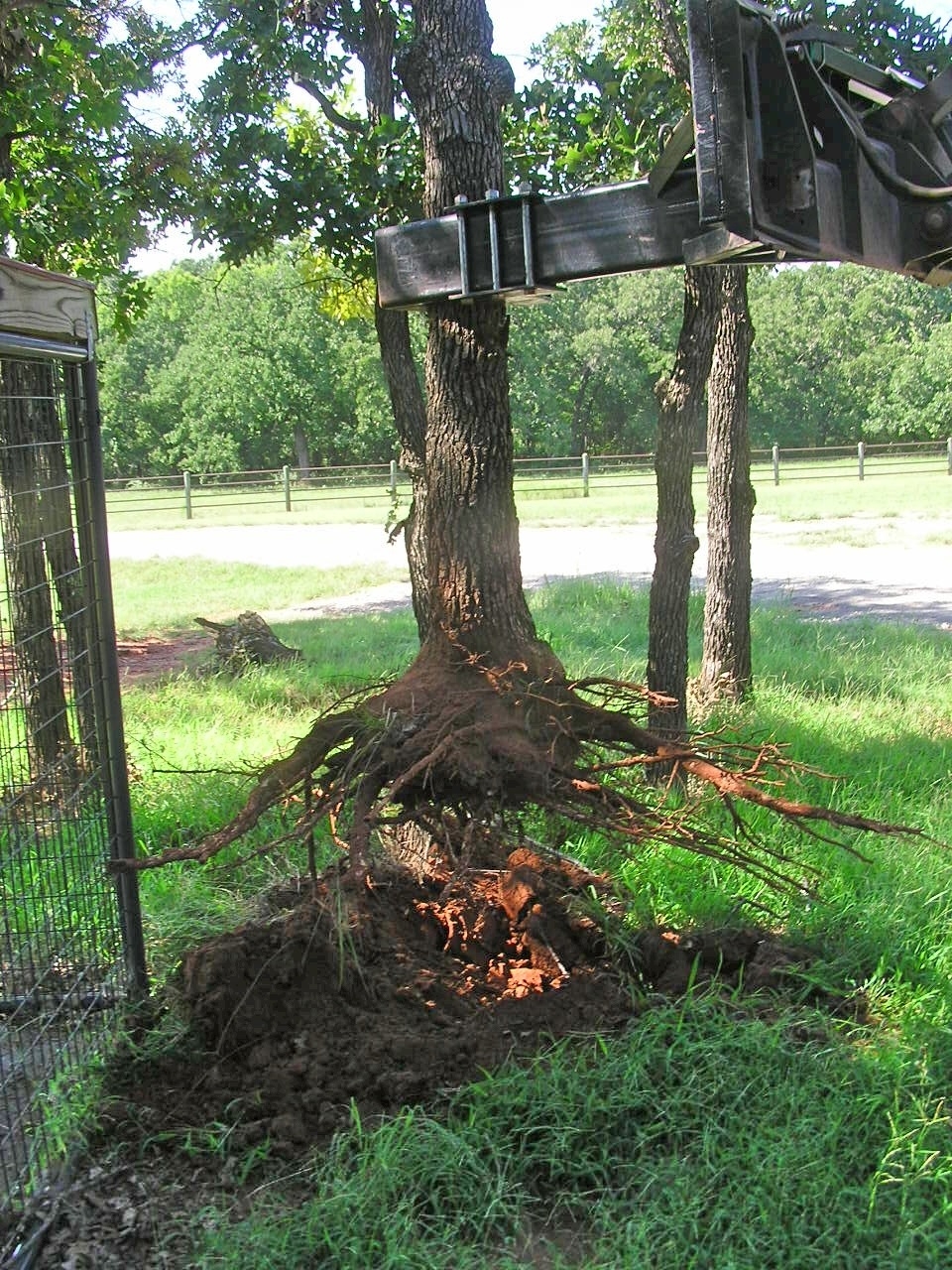

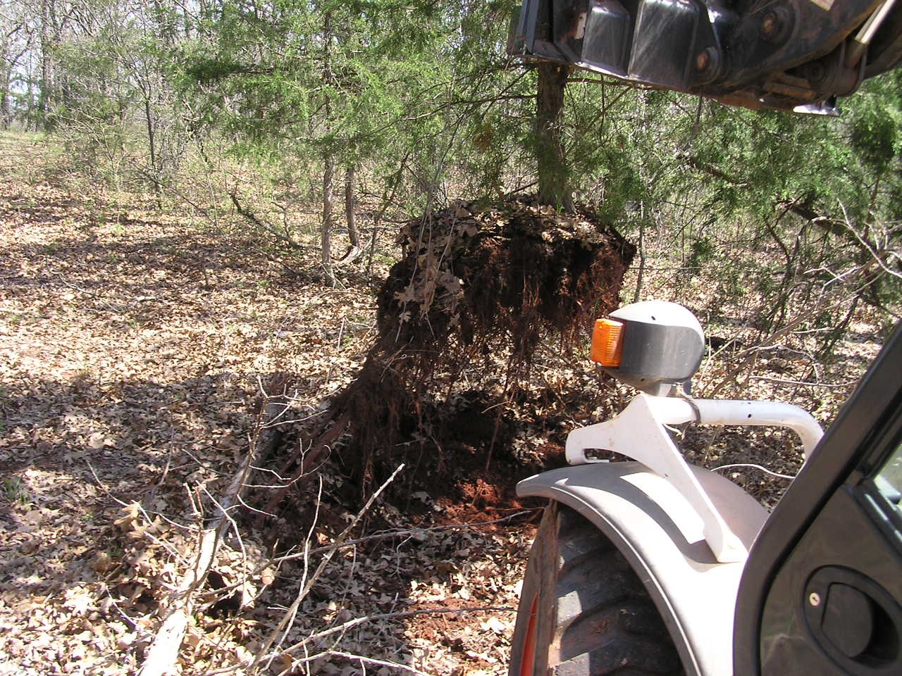

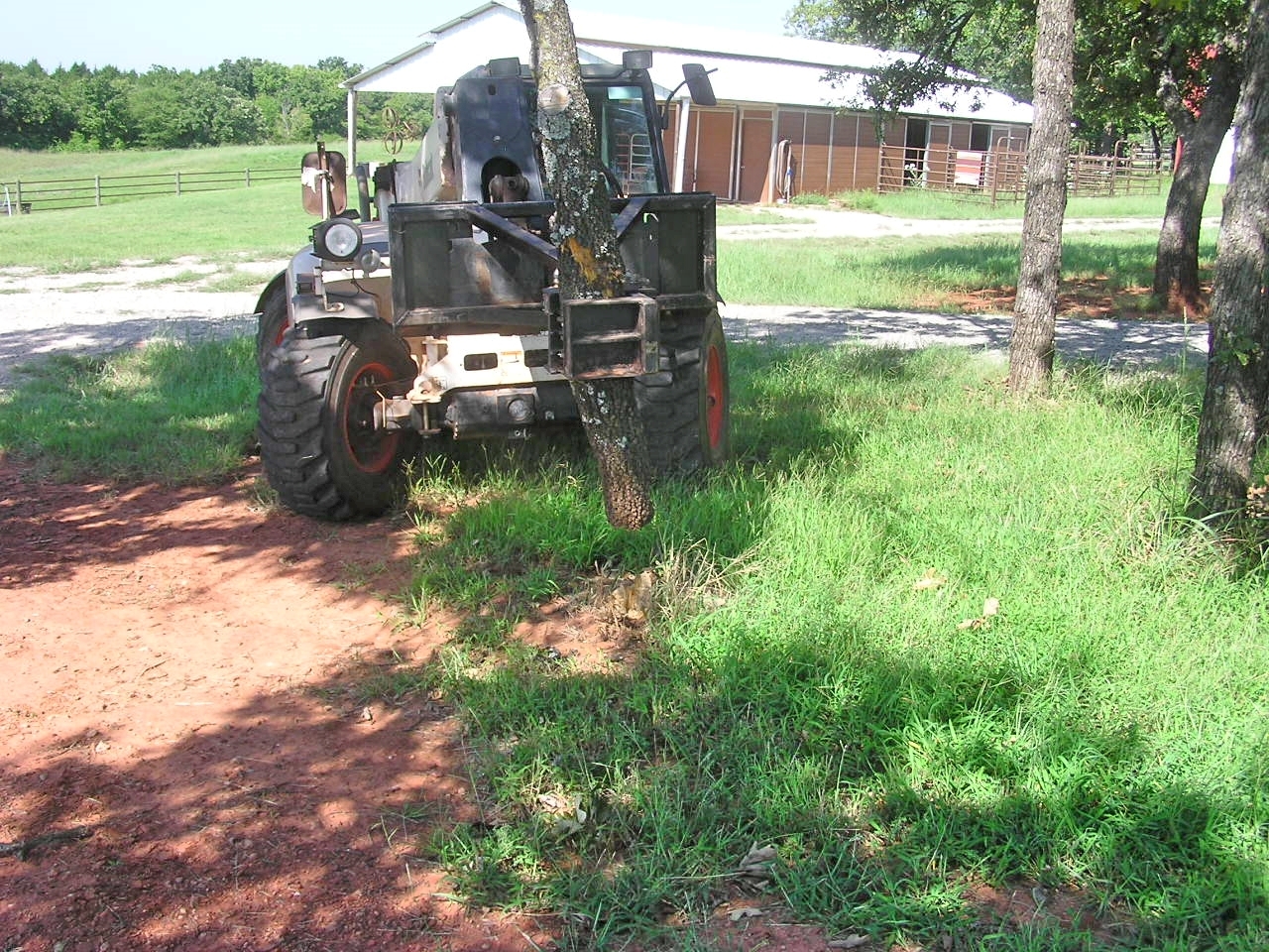

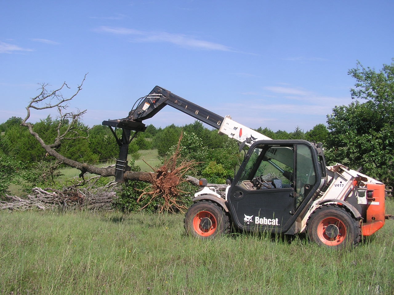

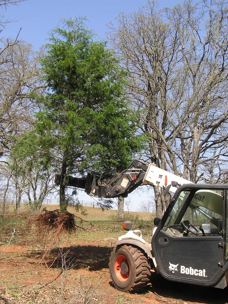

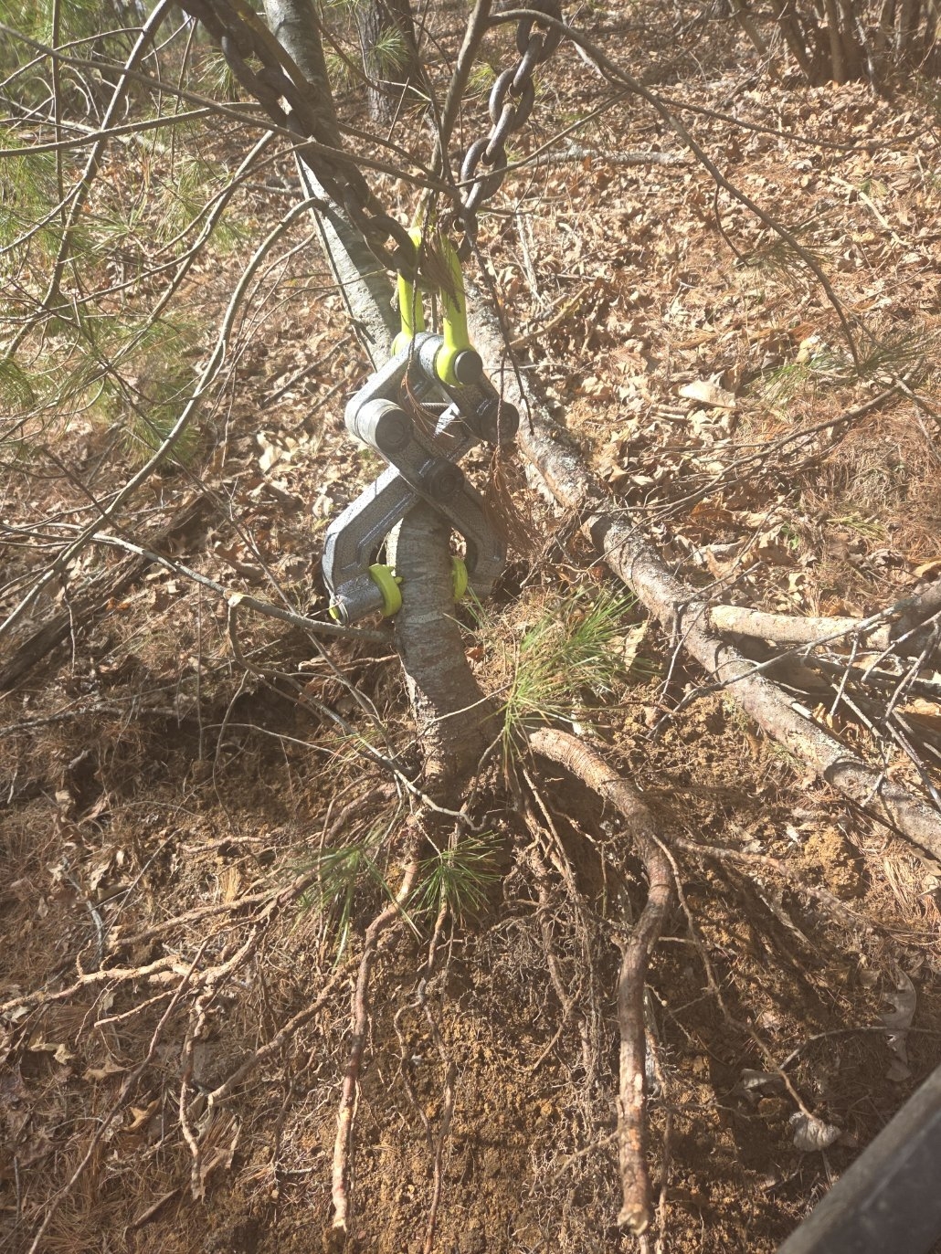

Last time I used a brush grubber I hooked, Lee drove, and Gary stacked the willows we pulled from along shore by the house. We cleaned up about 40' in just over an hour. Buckthorn, autumn olive, locust, and poplar cover a good acre or so and I'm constantly working on 'em.
Now I'm several times more productive, don't need a helper much less two, and don't have to get out of the seat until I jump onto the other tractor with the brush grapple. Anything over 4" dia is a bit tough to pull because my CUTs/FELs are on the light end for their hp.
what is that? where did you get it and what was the cost. please and thank you. 😊

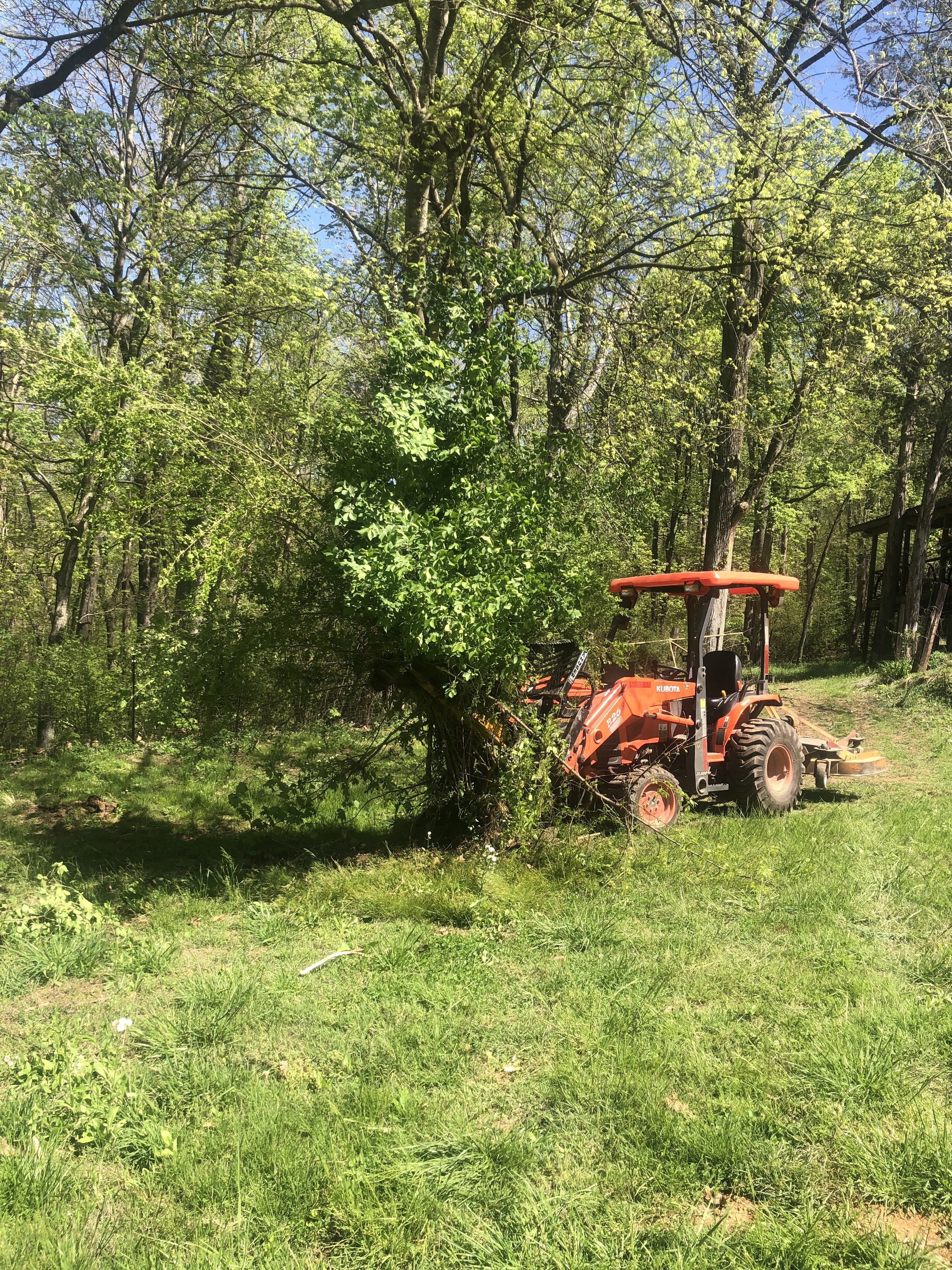

Best I can tell without someone helping your getting on/off the tractor. Who needs an exercise regimen anyway? I use forks and it seems to work fine. Middle size.

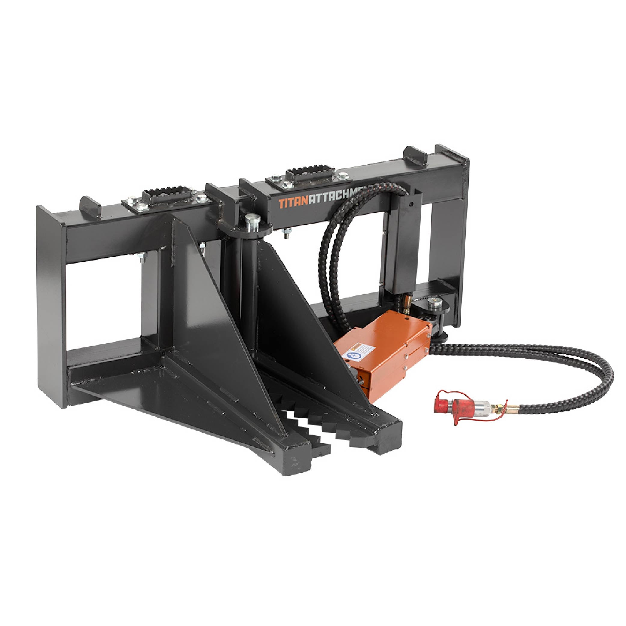

Yes, works best with two people. Wife is usually on the hook up end. Much prefers chain and pipe over graber. Better yet is the Danuser Intimdator which is one person puller. Clamp, drive forward to pull up, stack, repeat, grab pile and haul off.

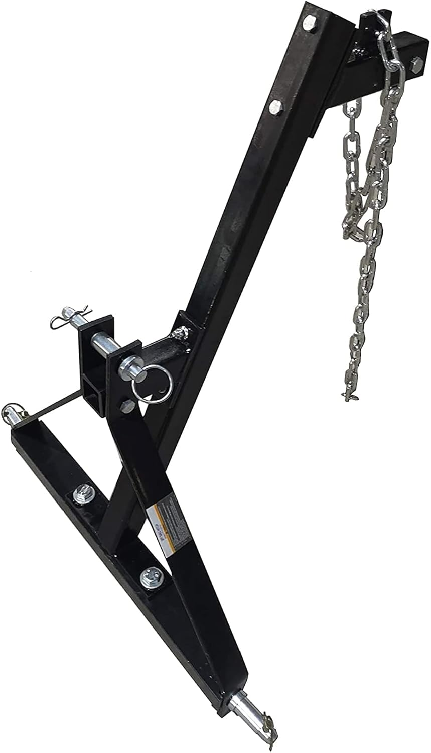

I use that chain setup, with a "timber skidder" sort of like this 1745267939741.png on the 3-point. I took this idea for an inexpensive but too spindly version I found on Amazon and the local farm/ranch supply stores and made a beefier version out of 5/16 wall 2X3 rectangular tubing I had left over from a bumper project.
I'm pulling sagebrush, so there is no way the pallet clamp style works. Sage brush is just too stringy of a wood for the clamp style to get a grip.
