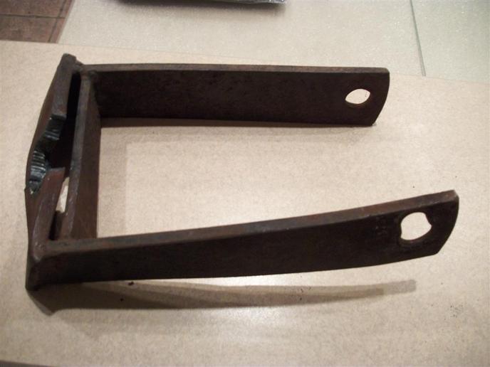

I just can't decide if to buy a new"yoke" assemblly, or have this one fixed up. The holes are elongated, the spindle is worn, and one fork is bent. Nothing a welder/metal fabricator can't handle, but the new part is $67, plus I save $10 if I buy it with the wheel assemblly. I just worry it will not be as well made as the original. Guess I could call and inquire.

Okay, now I'm ghetting somewhere. With the help of Bush Hog customer service, I found out my old style fork, part number 7417 can be replaced by the newer style fork/wheel assemblly Part number 12269. The older style wheel hub used 2 tapered bearings to support the wheel, the newer style uses a long roller bearing. The 12269 kit does not appear to be offered complete, unless you buy it aftermarket, for example Tisco 12269. I'm going to roll the dice, and order the Tisco kit for $146.70 plus $17 shipping. I know it will not be as heavy duty as the original, but my hub is completely broken, so I cannot rebuild it, and the fork is also in rough shape. I'll update you guys when it comes in on how good, or bad it is made.

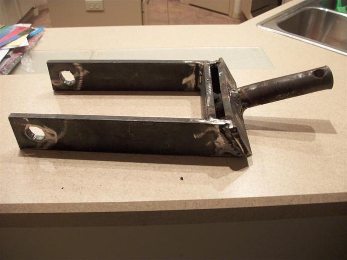

bent fork?
refab it?
here's one I made from scratch for my howse.. got the mower cheap due to the bad wheel...

bent fork?
refab it?
Nice job. My problem is I do not know how to weld. My neighbor has an arc welder, but I hate bothering him. Also, I noticed you reused the original spindle. My spindle is a little chewed up, and the holes for the axle are elongated. Check out video #3 at about the 1:00 mark to see the holes. In the photo, it appears the axle bolt holes were done with a torch, how did you clean them up, i.e. make them round again?
I toyed with the idea of having the local voc tech school make one up, or fix my old one, but that takes to much time.
The new fork is an additional $48 if bought with the wheel/hub. It is $66 bought seperately. If I take my old fork yo a good metal guy, his shop labor rate will make this a deal breaker.
I should get some welding gear and learn, but I know what a good bead looks like, and would not be happy with a sloppy job. Also cannot justify spending the $$ on welding gear right now (married, with children).
I on;y re-used the actual spindle itself.
the side pieces are new, and thus new holes.
could have made it from scratch using the correct round stock or thickwalled pipe..e tc.
if you don't own a torch and welder.. :) it could be a problem.
if you spread the cost of the gear out over many repairs though.. it mught be a bargain.
I bought my welding gear to fix a broken batwing mower. In my case.. buying an arc welder and chop saw was cheaper than hiring the work done.. so it all paid for itself in 1 job.. so i got lucky I guess...
