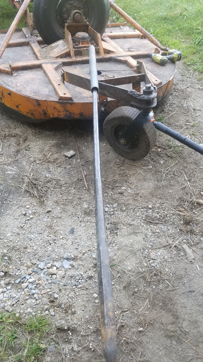

I have 2 sidewinders and have never had this issue. Are you sure that the bolts are put on facing up with the nuts on top? That way the spin of the blade tightens the nut as it spins. There should be a hole in the deck about a foot behind the wheel to access the nut. Here's my go to place if I have any questions or problems with my sidewinder:

japody, yes the bolts are being inserted with the nuts on top of the blade mount. The blade spins freely on the shoulder of the bolt.

How can the bolt be turning? The OP posted a link at the top of the thread to the bolt he uses, which has a key to keep it from turning. He also said there was a notch in the hole to fit that key. So if the bolt can't turn, and the blade swings free on the bolt, what makes the nut back off? It can't be the movement of the blade because the bolt can't turn in the hole.
   / Brush Hog Blades COMING OFF #38
The bolt either turns in the blade, or turns in the hub when swinging and stopping. I think that's what may be the question to the op right now. I believe the bolt should be stationary to the blades, but I don't know that for a fact.
   / Brush Hog Blades COMING OFF #39
The OP said in post #5 that the notch that holds the bolt is in the plate that's welded on stump jumper. So the blade swings on the bolt, which is fixed to its attachment point on the stump jumper. That's the way my Bush Hog rotary cutter worked too.
So the bolt is supposed to be fixed, and the nut is against another fixed plate. So neither should turn. But it seems the nut does. How?
   / Brush Hog Blades COMING OFF #40
Unless he has the wrong bolt's that are to long and the nut is bottoming out on the threads and not the top of the blade holder. The bolt has to be stationary with a tab that fits a slot in the blade holder OR the bolts have cut sides that fit into the same cut sides in the blade holder.. This ain't rocket science..
