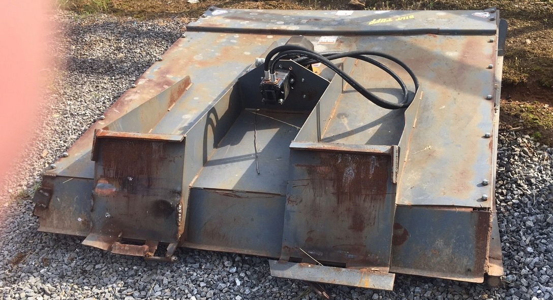

Here is a 6' mower for less than 3 grand. Might be worth it to sell your tractor model and just buy one?

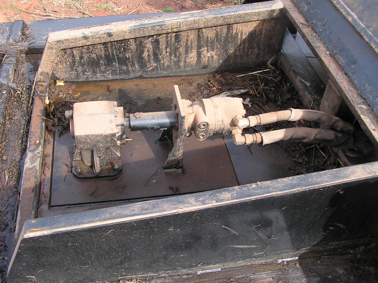

This is a ebay pic for a rough looking mower that looks like it may be a home conversion. Could be useful for fabrication ideas.

You'll need a flex coupling between the gear box and the motor. A bearing supply store is your best option, but McMaster also has a good selection. Just watch the rpm and torque rating. I'd recommend not rigidly mounting the mower to the skid steer because you'll have problems getting to follow the ground. The best install that I've seen used the 3pt hitch mounts and then had three arms coming off a skid steer plate. A chain limits the fall of the mower.
