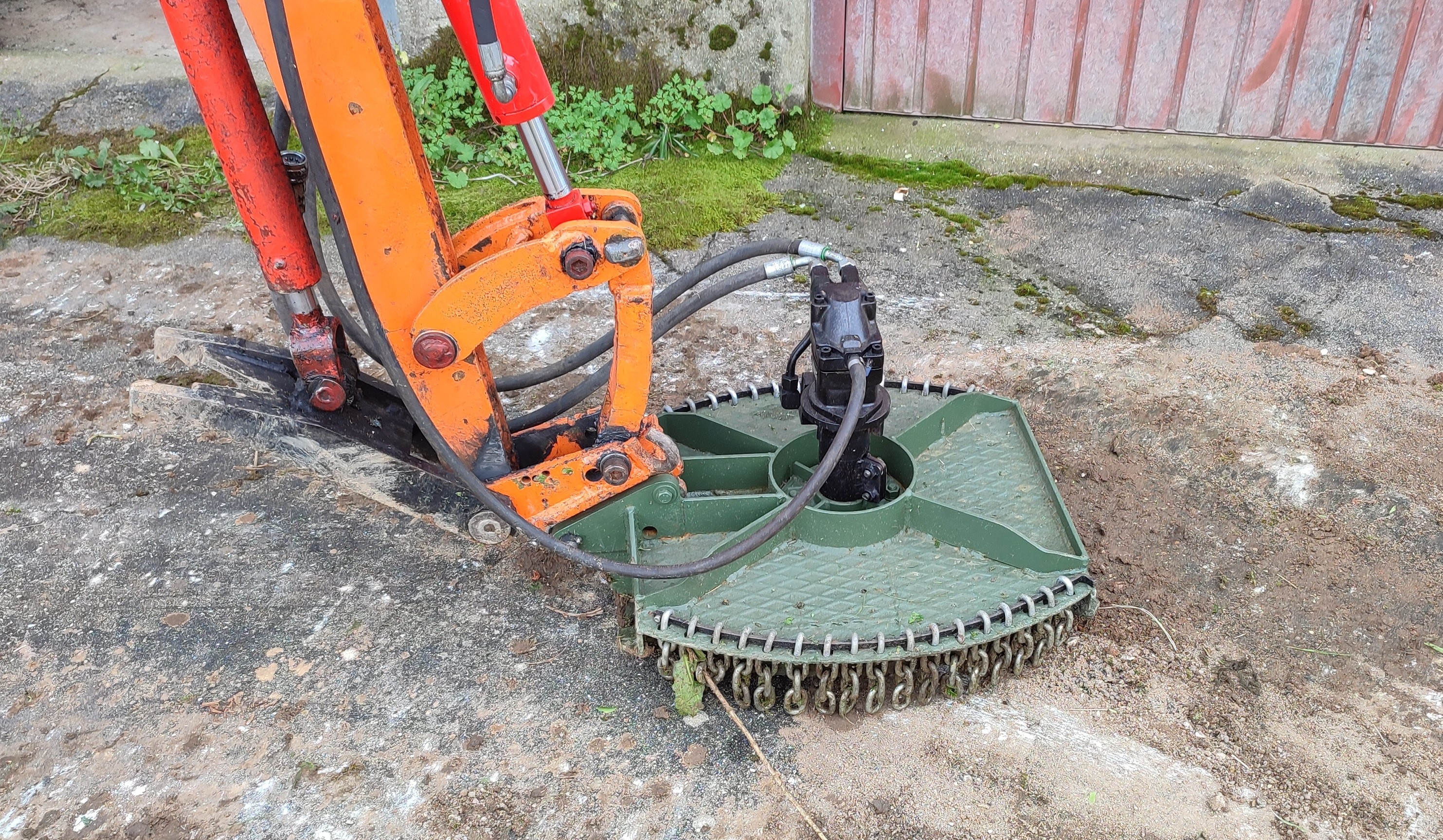

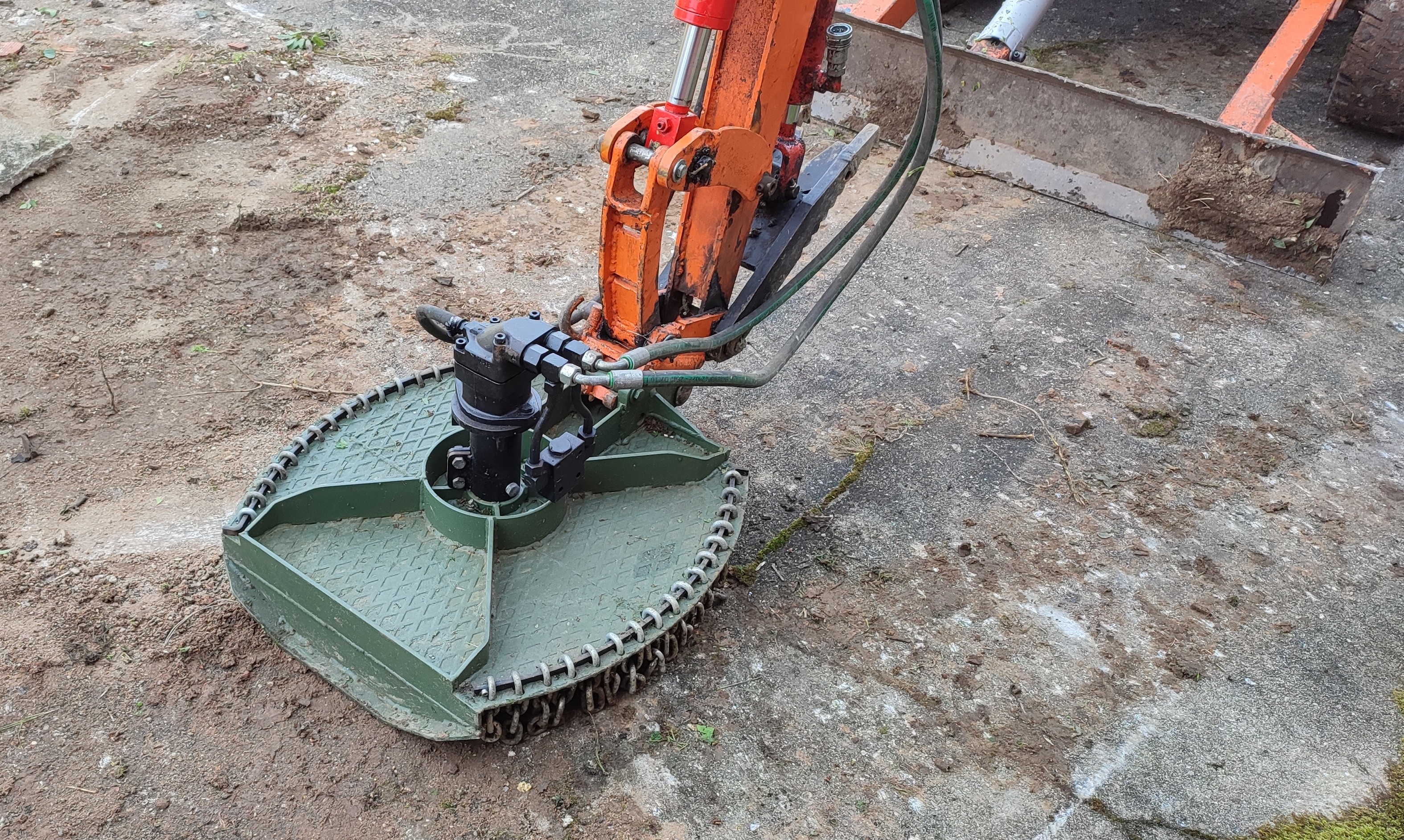

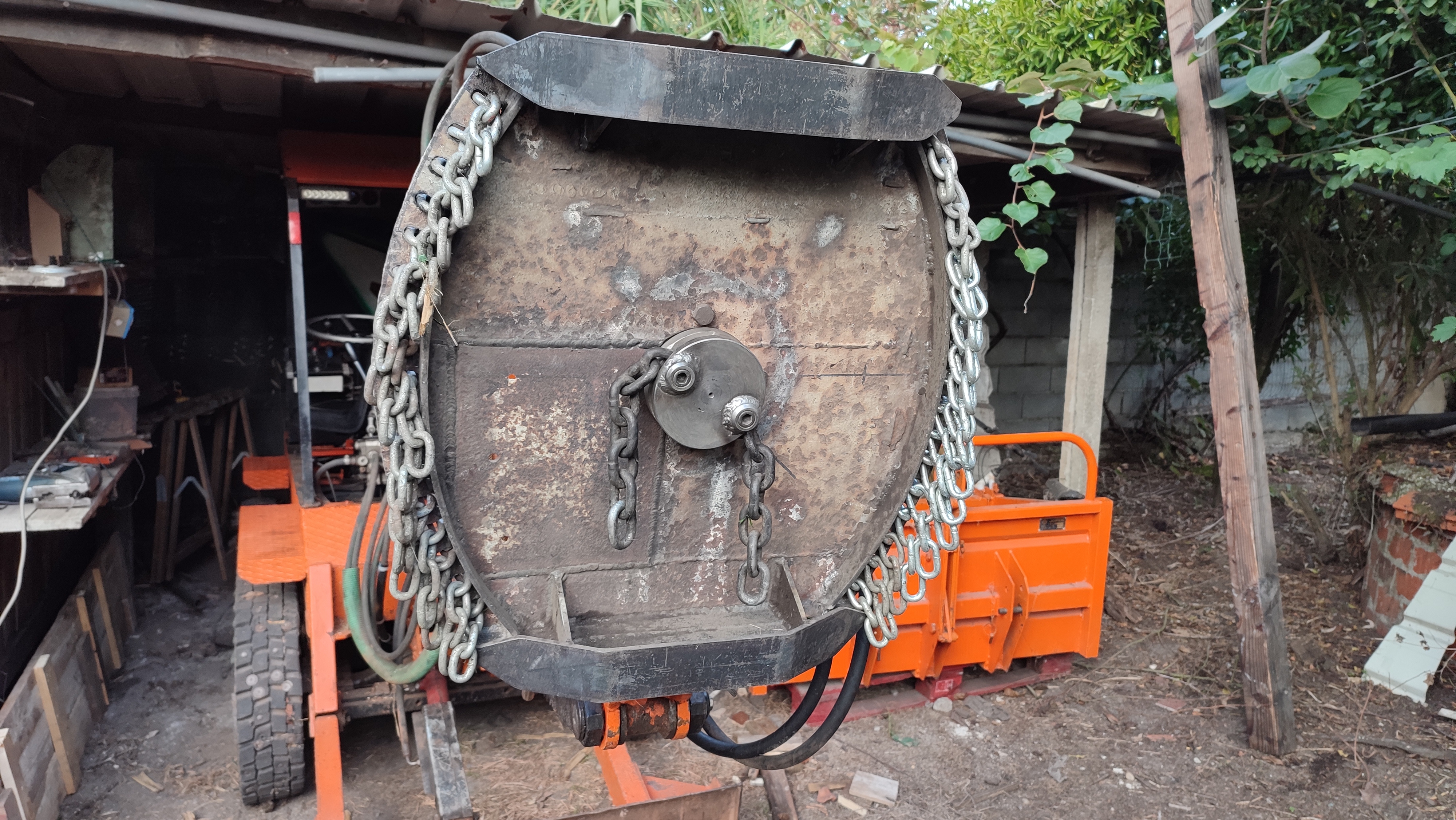

Here is an hydraulic brush cutter I built for my backhoe a month or so ago. I suppose it fits the thread, since mostly about using chains. I do have a flail mower for the backhoe, which worked fairly well, but it's just an heavy attachment and I wanted something lighter.
Cutting width is about 50 cm or nearly 20". Using 3/8" grade 80 chains. Rotor speed is about 2000 RPM.
It has been painted since, I just haven't taken any pictures of it yet. Still need to test it properly but for that I need to haul the machine over to the remote propriety, however I still have digging work for the backhoe here at home.
Every TBN member who either has or wants a 16hp or so chinese made mini-ex must be salivating at the sight of your cutter.
I wouldn't have expected a 17hp backhoe to have enough power to run a cutter?
Could you explain the way you've oriented the skid shoes perpendicular to the tractor? They also appear to be very wide compared to most brush cutters I've seen.
Your fabrication work is astounding.

So the reason I can get by with 17hp compared to a chinese mini-ex is because I have a dedicated pump for the auxiliary circuit and I match the attachments to this machine. This means I always have flow there regardless if I move my machine or use the arm.
In my case, 17hp is pretty much the bare minimum. Ideally I would need an engine with about 25hp to be comfortable for what I want to do with this machine. In this configuration, I do lower the pressure for the arm to leave more HP for the auxiliary circuit so the engine doesn't have to work that hard and mostly because I refuse to rev it to the near max RPM.
This has been working very well with a flail I had. All these months later and I haven't had the chance to test this new cutter I built.
Regarding the shoes or skids being mounted perpendicular to the machine is because when using the cutter, you move the arm left/right instead of moving the machine forward or backwards. This way, it also protects the operator from debris.
As far as the width, we run the brush cutters dragging on the ground, so the wide shoes let it float better and won't let it dig much.

About time I took this cutter out for testing. I only have some pictures of it painted though.
As far as performance, I'm happy with it. I tested it on some overgrown brush. It took it just fine, no issues, no weird noises, no vibrations. Just smooth operation. I would like to test it on some thicker and dryer material as well.
One thing I could possibly change and may happen eventually, is to move the rotor down some. I left it a bit to close to the bottom of the deck. I would like to go a bit closer to the ground.
I did noticed an huge difference in hydraulic oil temp by running this cutter instead of the other flail cutter I have. With the flail, the temps would sit at around 60C. With this cutter, it sits at around 40C, which is the same as when just digging holes.
Eventually, I would like to upgrade the engine, preferably an air cooled 3 cylinder diesel in the 30 to 35hp range. This would allow me to run a bigger pump on the auxiliary circuit for more flow. Then, I could push the RPMs on the cutter from 2000 up to 2500 or 3000 RPM.
Unfortunately, no videos and no pictures of the before and after because I got carried away with it and forgot about. Once we finally get a break in the rain, I'll take some videos of it.

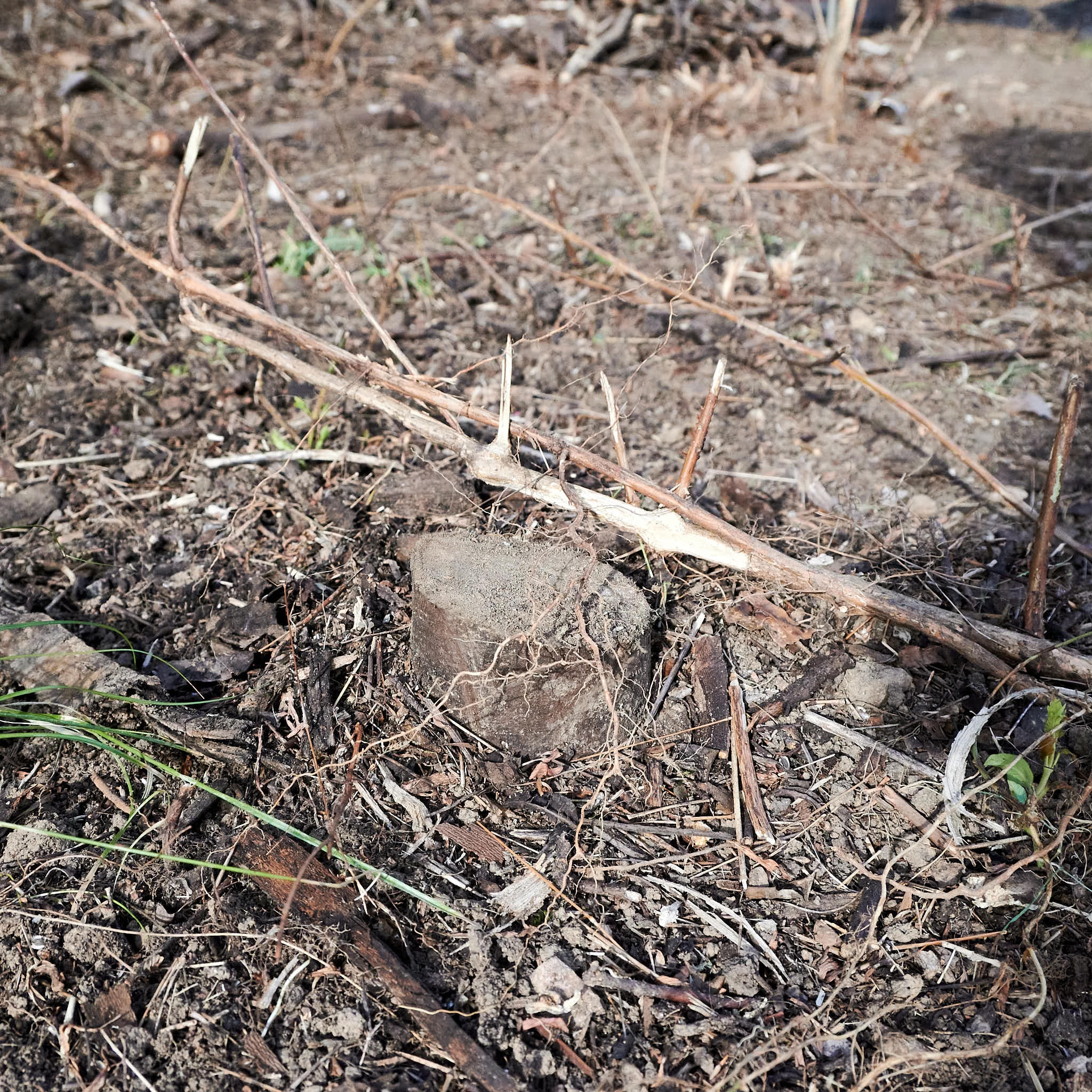

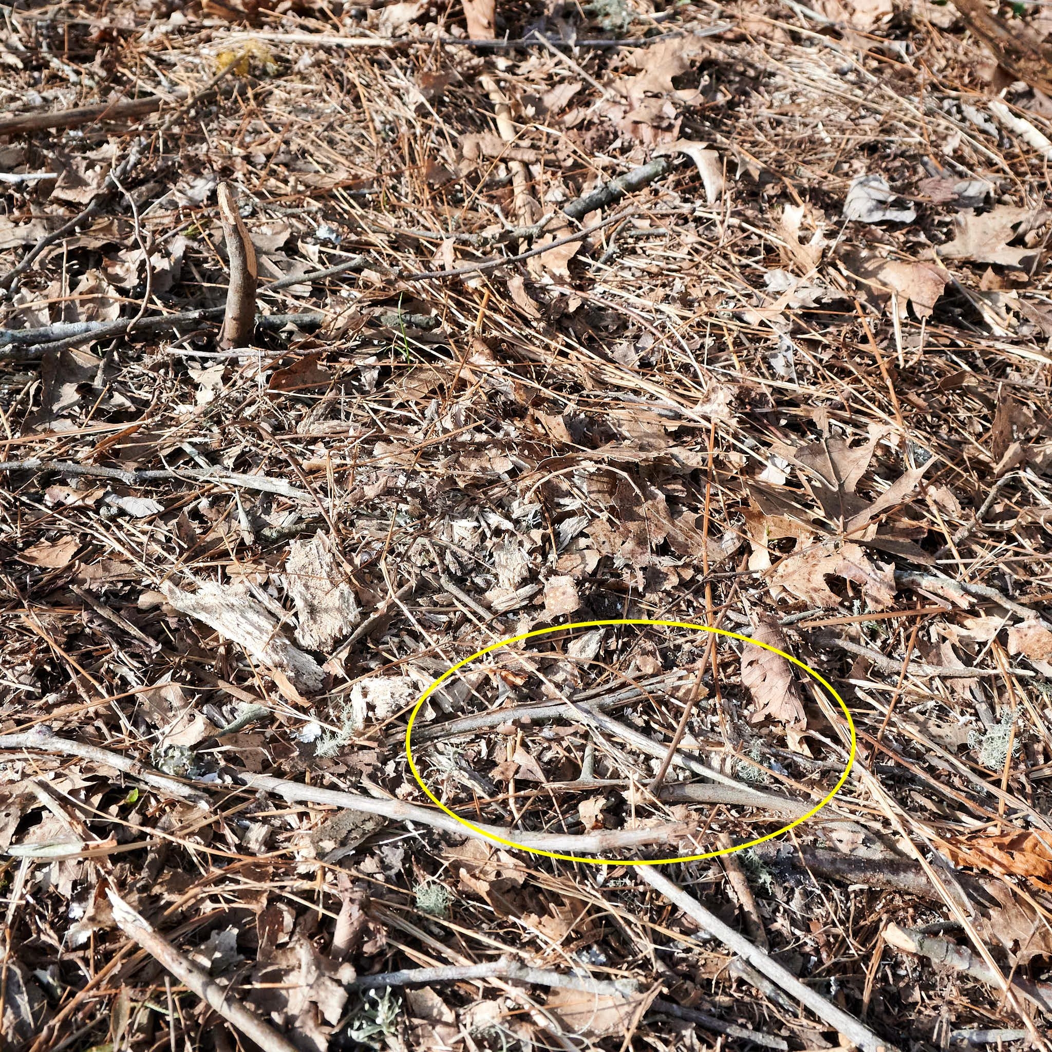

On the topic of chains, I've been hand clearing an area of honey locust trees because I didn't want to puncture any of my tractor tires, especially the rear ones filled with fluid.
I've cut the trees down and hand raked most of the area, but I'm still finding thorns here and there.
It would be nice to have a forestry mulcher grind the top layer of ground, but they have a $1,200 a day minimum. The work might take them 30 minutes.
Don't know if it even works because I've never used it, but I have an old Gravely front mount tiller attachment for my walk behind Gravely tractor. I thought about tilling the ground, but there are still some stubs of tree trunks and tree roots that would interfere.
In my imagination, it would be nice if I could beat these remaining thorns to pieces with chains.

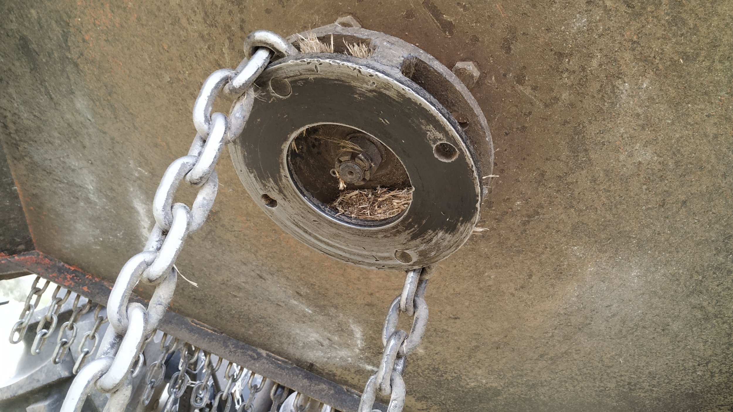

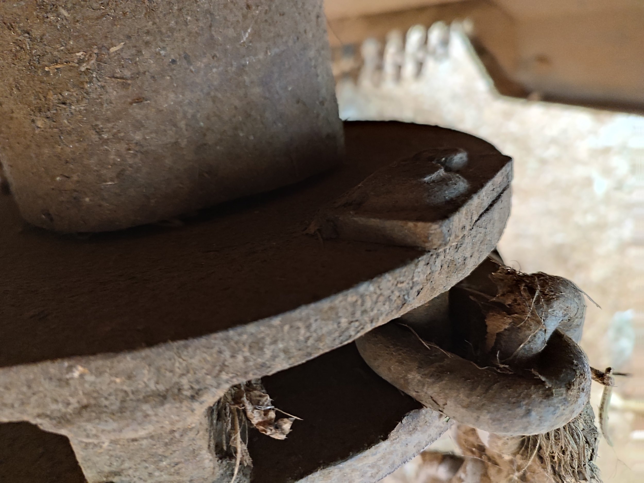

Cutting with a new or freshly sharpened brush hog blade is nice but this shows that it doesn't really have to be sharp to hack down heavy brush and small trees.
Cutting field grasses the sharp blade wins.
This is a rip and tear operation. I have pushed the limits of my old Woods Dixy Cutter.
Build these out of the older brush hogs with heavy duty gearboxes and use a stout tractor. It will test it depending on the operator.
It looks like Scootr picked up as HD brush cutter. This could save you from a lot of nasty hand clearing work.
Let-r-rip

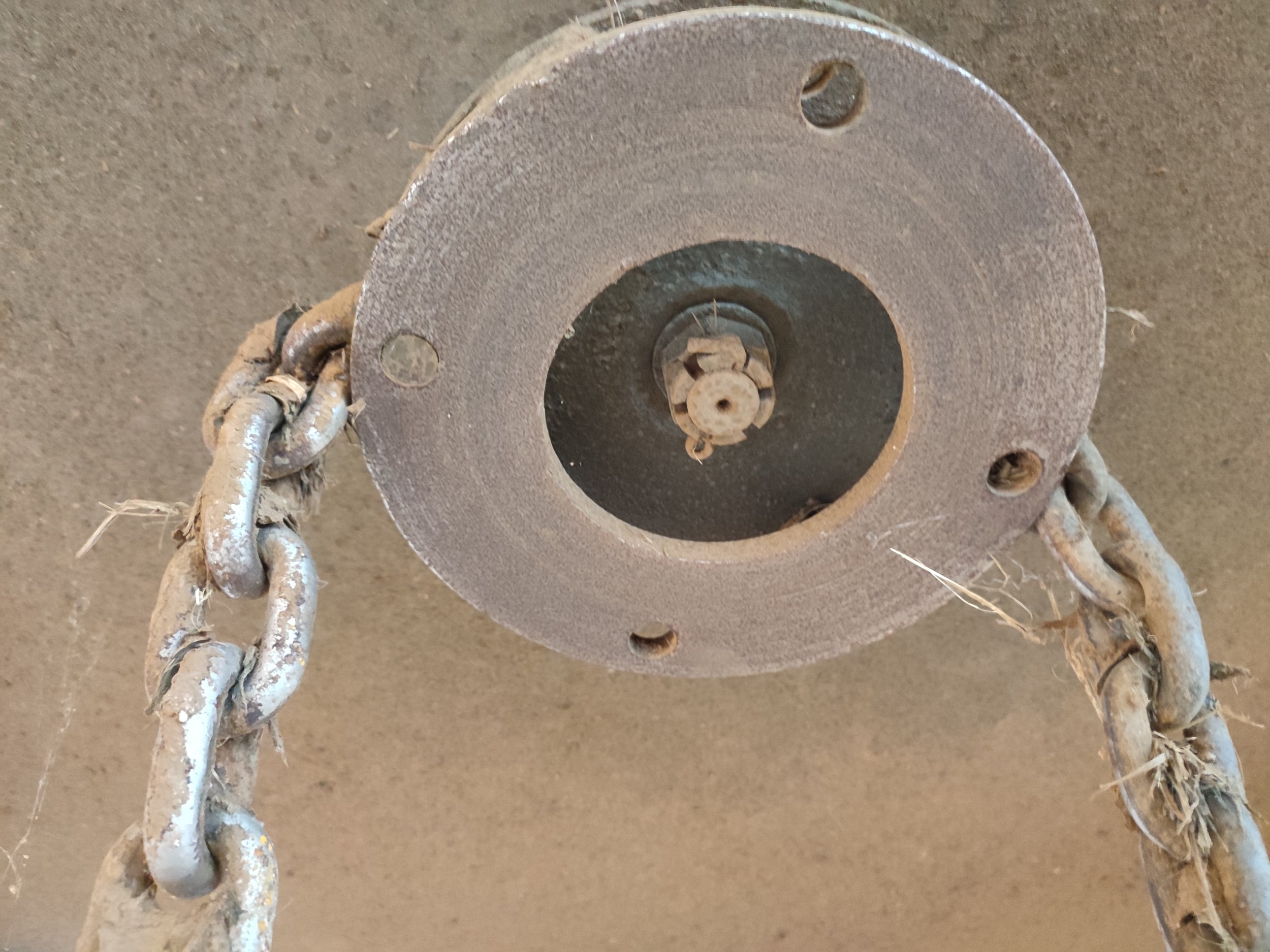

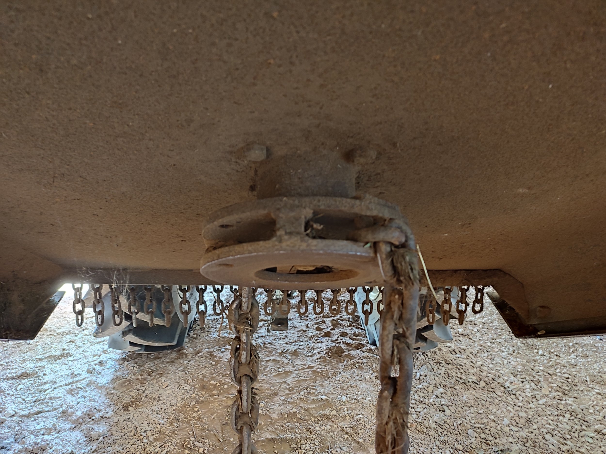

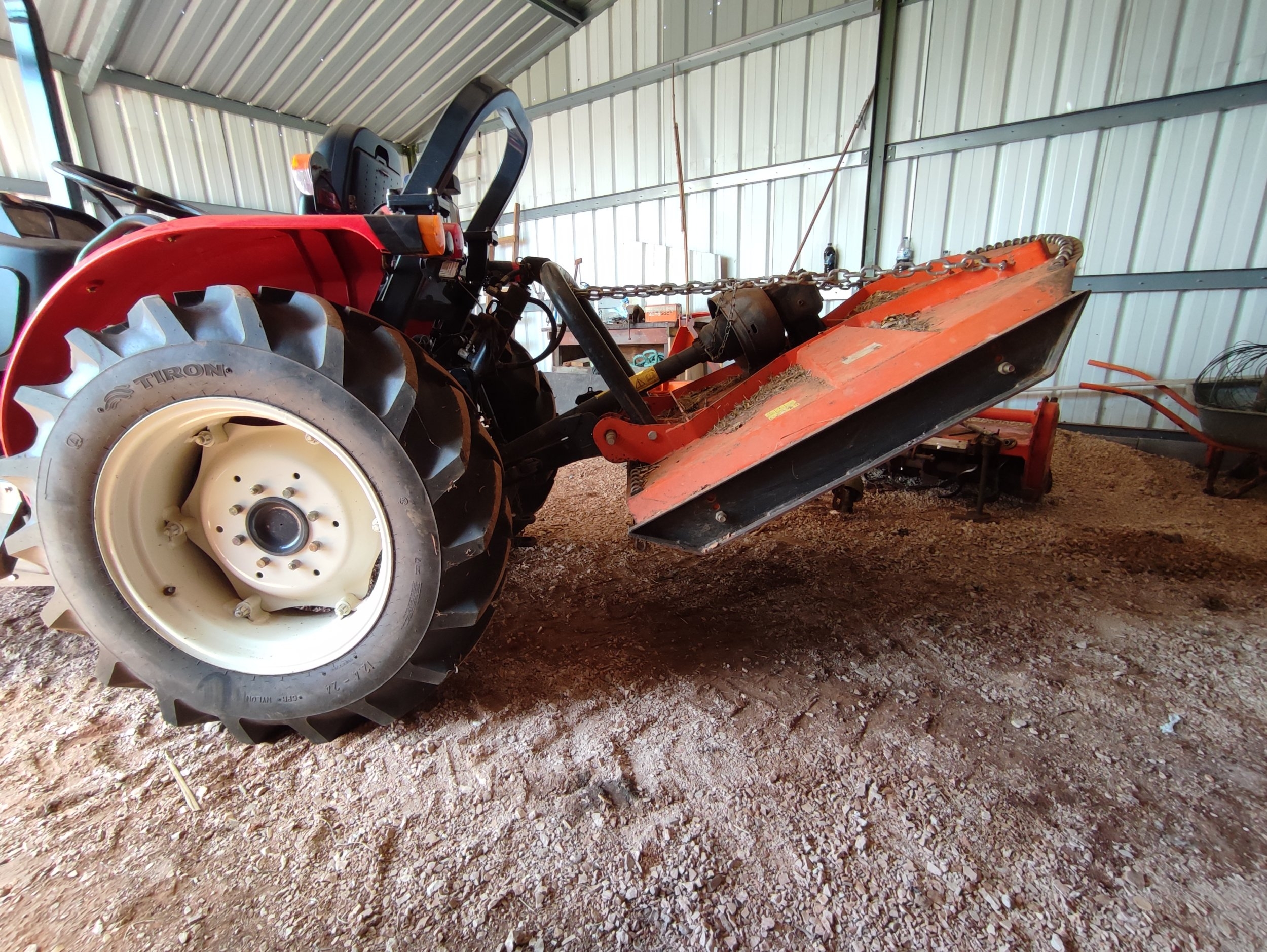

The old Brush hog Model 12 I found could be as old as 70 yrs. It's heavy built and was in need of some repairs.
It was ideal for this experiment which has become my go to cutter, I mean slasher. (y)
