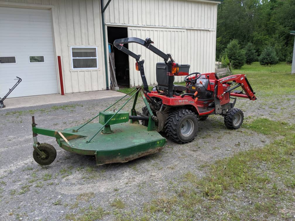

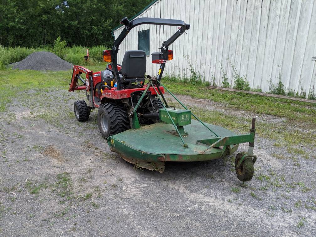

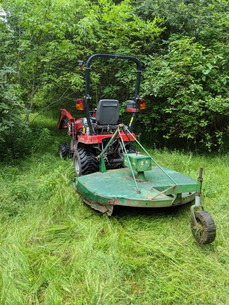

So I was able to test out the 5' John Deere 205 Gyramor cutter and almost to my surprise it was an absolute success. The cutter doesn't have quite the same footprint that other 5' cutters do. Even without the loader on my machine (which I left home due to limited trailering ability) I was able to steer and lift and handle the cutter like you would expect on a larger machine. I was in grass/brush as tall as me and it hacked it up no problem. Ran over a 1" sapling and the only affect it has was noise...no bogging. Tranny in low, 2WD and 3 hours of very competent mowing and I was sold!
After trying to negotiate a fair price with my uncle he gave me a deal I could not refuse...the good home family discount of free!

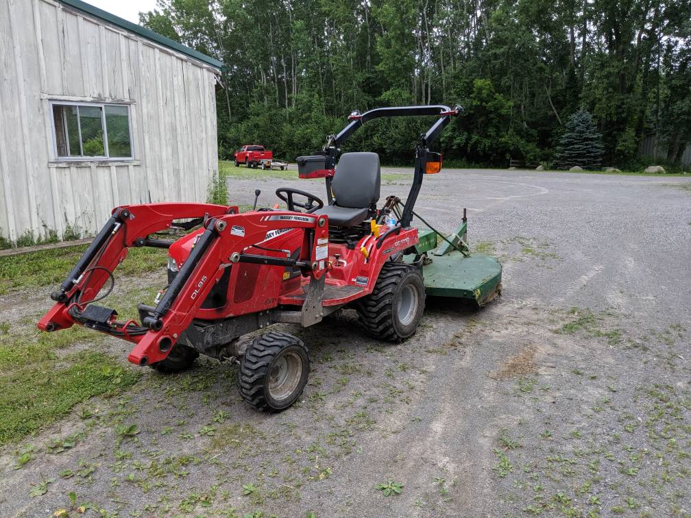

She'll now be retired to my garage for a bit where it'll get some parts, routine maintenance and a fresh paint job! IMG_20190720_113127.jpgIMG_20190720_113217.jpgIMG_20190720_113151.jpgIMG_20190720_095412.jpg
   / Brush Hog on GC series tractor #10
Lookin' good!
Interesting about your "half-way up" ROPs locking bar -- I made some exactly like that! (After nailing my garage door once or twice....:ashamed:)
