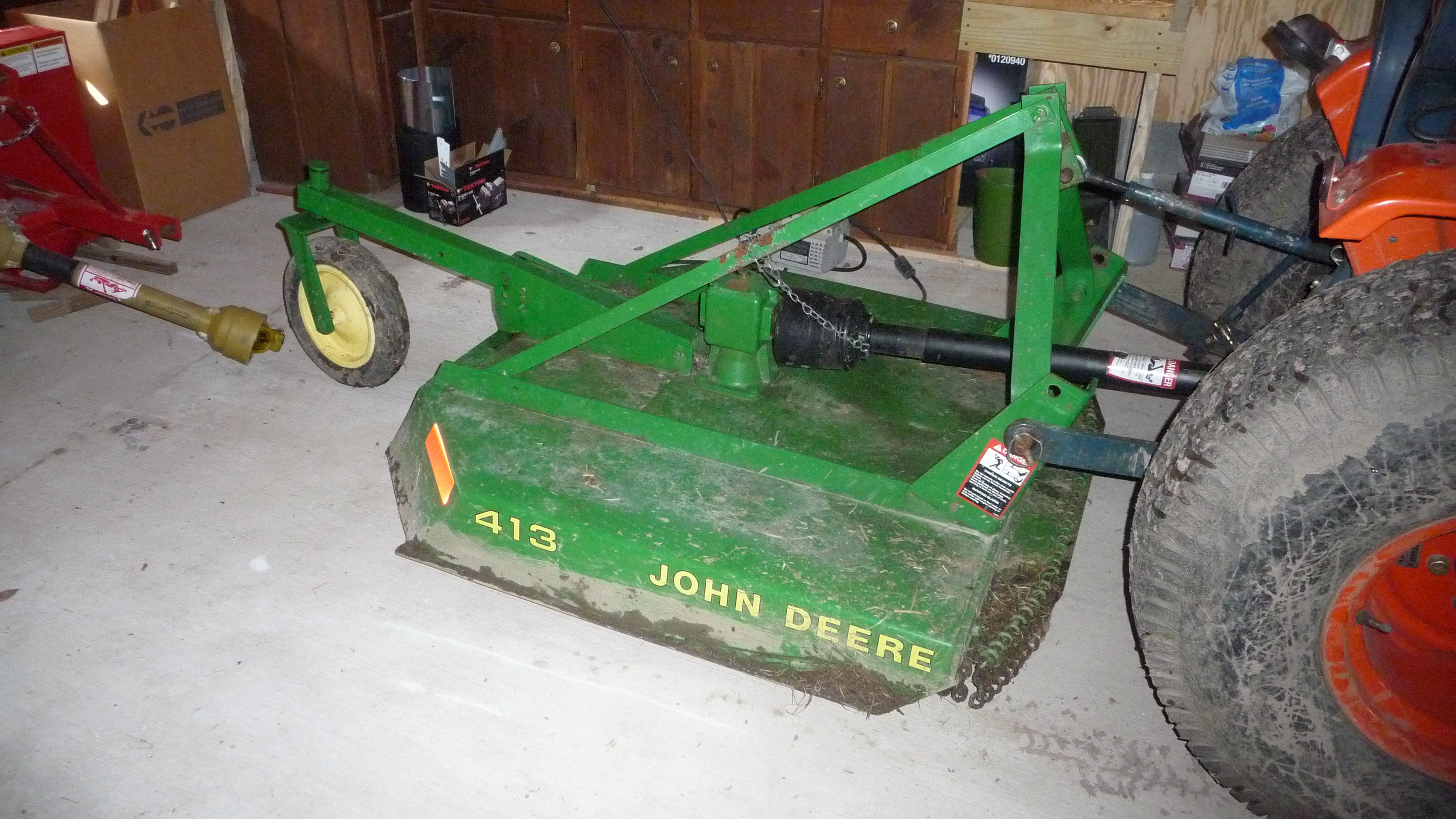

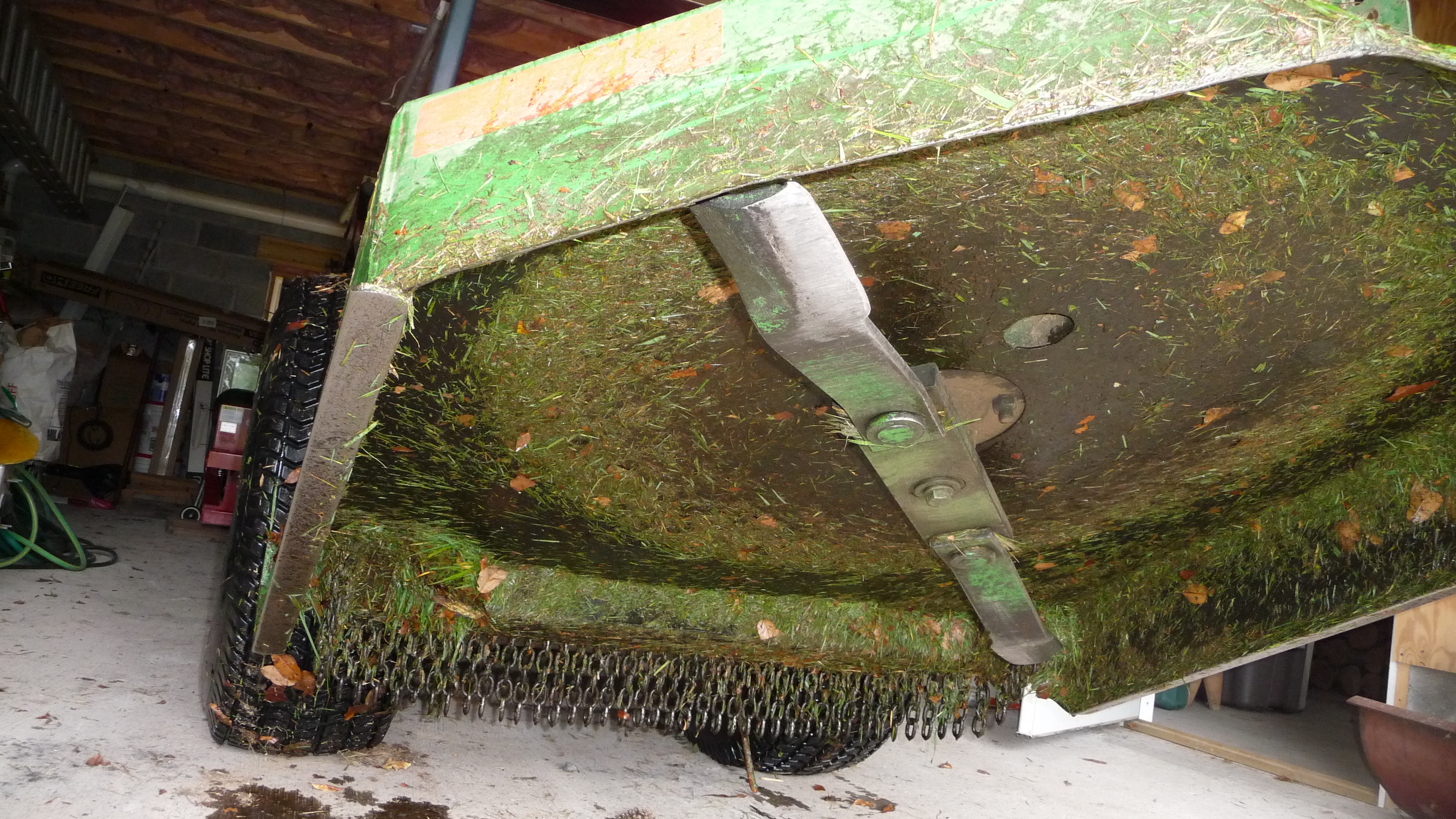

Here are a couple of pictures of the 4ft JD 413 that I use on a B2150 Kubota. The price and mode of purchase in my case were about the same as yours. From a cousin... [a 5ft Bush Hog brand I use on another Kubota B2150 cost me $1000.]
I have to look up fluids for this unit at a base level. There are no seals leaks or signs of seeping lubricant anywhere. I'm already having some issues finding new/replacement shoes for the bottom. New blades are at the ready. I'm also in luck! This unit uses a built in slip clutch system, not a sheer bolt.
