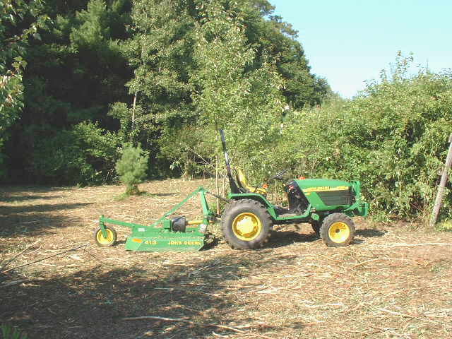

I have JD's 4ft cutter for my 4100. Its 455 lbs. Long tail wheel too. Loader makes a fine counterweight.
When I use the cutter without the FEL attached (which I rather do, definitely a more stable feel on the slopes) the steering can get a little light so I add weights on the front bumper.
Just out of curiousity, how much weight are you using...did you get your weights from Deere and what was the price?

Yep, JD front suitcase weights. Approx. 42 lbs apiece. 5 weighs it down real good but three can get ya by. They'll work in other situations too. I hang them on my back blade for added weight too. Check around with some dealer's on the price. When I bought mine they were $28.00 each. They work out good for me. Easy to transport along with the tractor and implements.

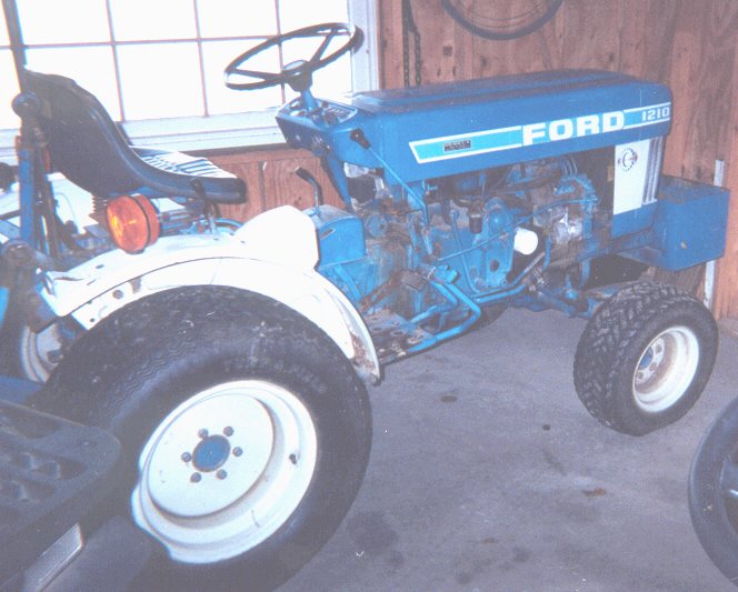

Wifes stepdad uses a heavy duty steel box bolted to his bumper of his lil' FORD 1210. Fills it with a couple of solid concrete blocks for counterweight when he uses his "MINI BLAST" sprayer. He doesn't have a FEL so the box stays on the tractor all the time. Makes a handy toolbox when its empty too./w3tcompact/icons/smile.gif
I'll post some pics.

Here's a pic of the 1210 with weight box.
