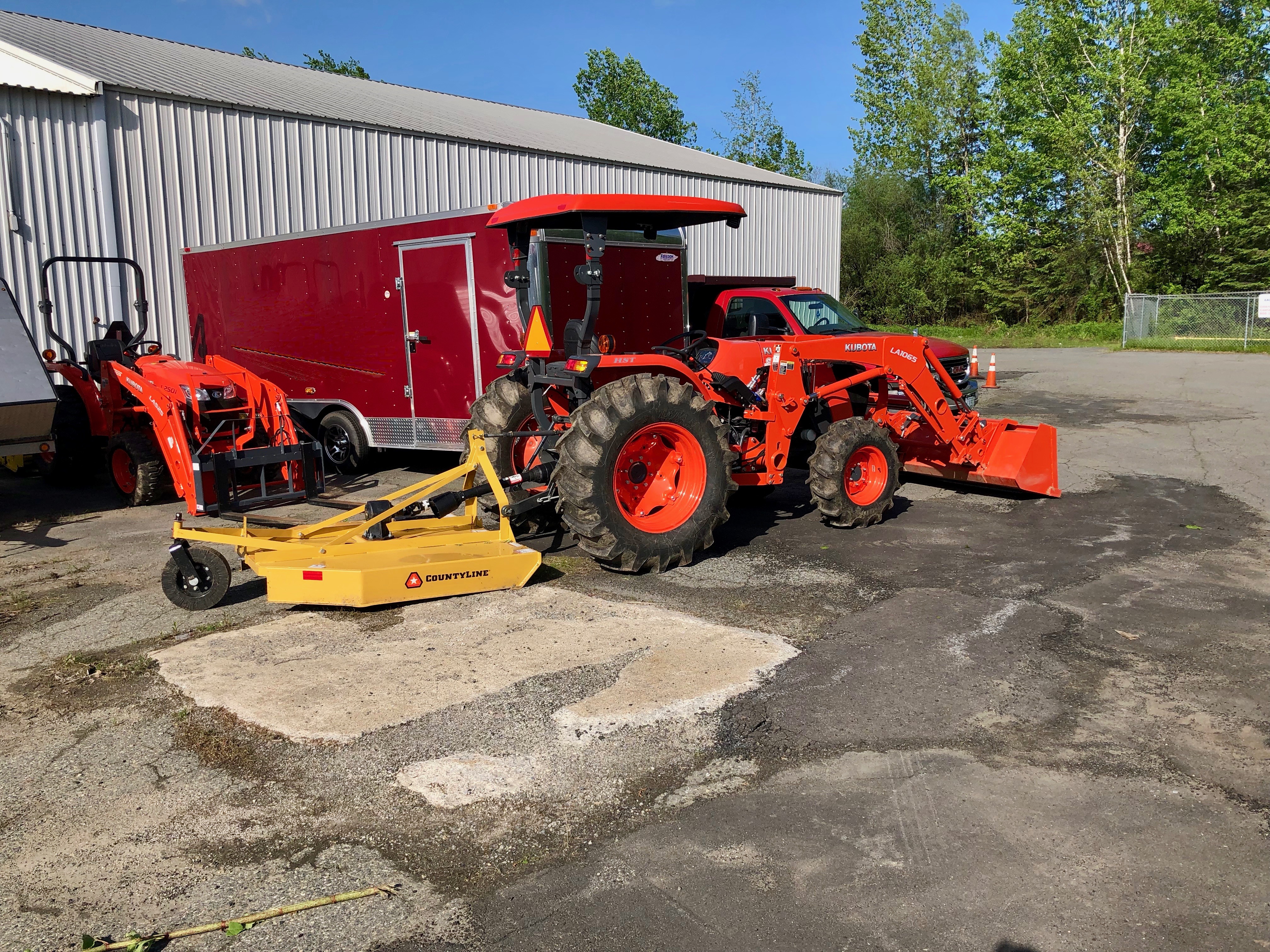

I bought a County Line 5-foot rotary mower from Tractor Supply yesterday for $1200. This is what I would consider a middle of the road mower. It is a step above the Chinese units that are imported and a step below the major names like Land Pride or Bush Hog. The mower itself is manufactured by Tarter of Kentucky. The gearbox is made by OmniGear which is a US owned and managed company in Houston but the manufacturing is done in China. The driveshaft is 100% Chinese. The metal deck and side skirts are a little thinner than what you'd see from Land Pride or Bush Hog, but still adequate. The rear wheel is laminated and will last a very long time assuming it is not roaded. There is a grease fitting on both the rear wheel swivel and rear wheel hub. The blades are on a stump jumper dish and are the lift / grass design. There is a tool caddy mounted on the deck with the owner's manual inside - I will remove this and put two cheap box end wrenches and spare shear bolts inside. For the money, this is a decent quality mower. If you needed a mower for everyday, commercial use I'd probably get something heavier duty. But so long as you use this mower within it's rated limits, I think it will last a very long time, even with a lot of use.
