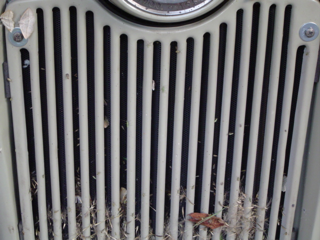

Brush Hoggin' with a RED BELLY FORD .. hay seeds in radiator ... HOT! Cure??

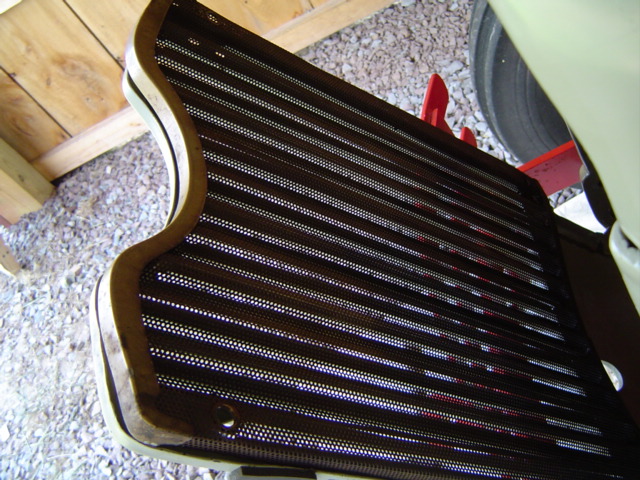

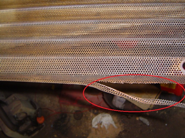

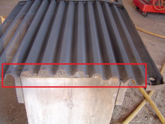

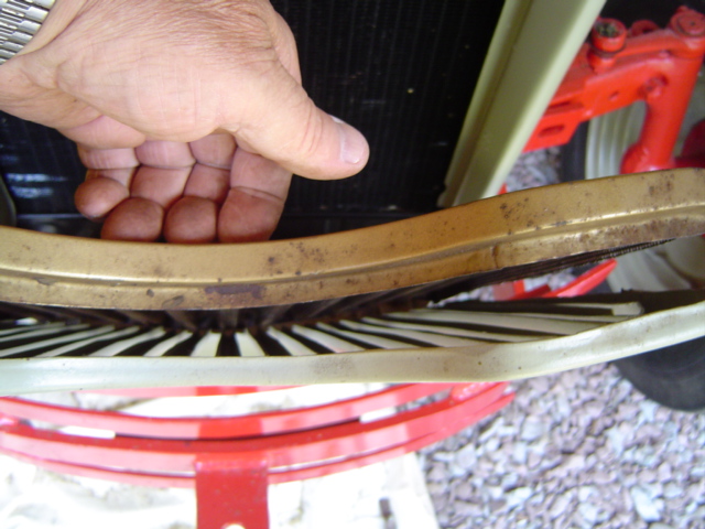

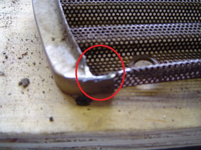

OK, my grille screen arrived today. ... generally, it was in pretty good shape,with a little rust and dirt and the bottom channel was cracked in the center ... more on that later.
Remember this is from a Ford 871 (?). The first thing I did, was to try it in/on the grille. it was about an 1/8" wide on both sides (more than the grille). The top had a lip which went in side the grille top. So, I cut the outer edge off each side and removed some of the outer channel corner.
Since the bottom channel was cracked, I removed it, as I felt it wasn't needed and without it, the seeds and trash could drop through, rather than sit on top of it.

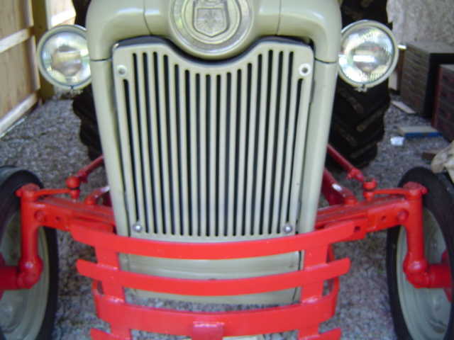

The top holes in the grille matched with the top holes in the screen. The bottom holes in the screen were right behind the 2 outer grille slots. I'll have pictures of this tomorrow, as I painted the screen, after blasting.

"Along with the sunshine, there's gotta be a little rain sometimes"!
So, last night, while I was enlarging one of the holes in one top bracket, the drill grabbed the last little bit and screwed the drill bit right into the radiator! :thumbdown: Then, when I drilled out the pop rivets, so I could get to the damage, the bracket dropped down, between the radiator and the side cowling. So, this morning, I cleaned the radiator up and applied some J-B Weld ... so that is setting up. Then I had to take the large bolt, at the bottom of the cowling out, to retrieve the bracket.

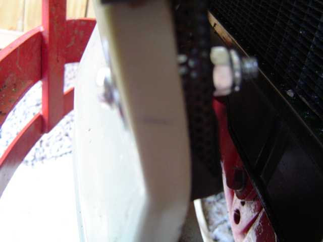

Now, ........ the grille screen sits in the grille, which is pivoted on the bottom. The top of the grille was originally held in place, by a bar, that went across and was behind the cowling.
The bottom is fastened to the grille with a 1/4" bolt, a flat washer, the grille, a 1/2" spacer, the grille screen, a flat washer and a ny-loc nut.
The top will have 1/4" bolt, flat washer, grille, 1/2" spacer, the grille screen and screw into a "U nut plate" on the bracket, which is pop riveted to the side cowling.
Hopefully, after the J-B Weld sets up and I leak-check, I can finish it up.
Update: ......... Well, that hasn't come together, yet! Still leaks, ... clear back, at the back edge of the second row of veins. I cleaned it up again and re J-B'ed it. I did go out and salvage my original radiator off the pile!
