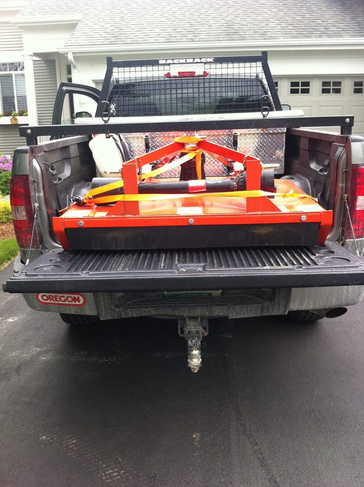

So ended up picking up the Countyline 48" model from Tractor Supply this afternoon... and quickly realized I should have asked more questions when I was there, as I need to run out in the morning to pick up gear oil, a couple 15/16 wrenches/sockets and a center pin for the mast. I did pick up the lynch pins but forgot or didn't realize I needed everything else. Ah well, a good lesson and I'll be out the door early tomorrow.
Thanks for all the input folks.View attachment 428346
I can't tell in the pics if you have a slip-clutch or shear bolt. If it is a shear bolt pick up a couple of extras, while you are there ,or you will probably going to end up returning to get them.
   / Brush Hogging Hard on Tractor?
#28
Shear bolt; good to know, thanks
