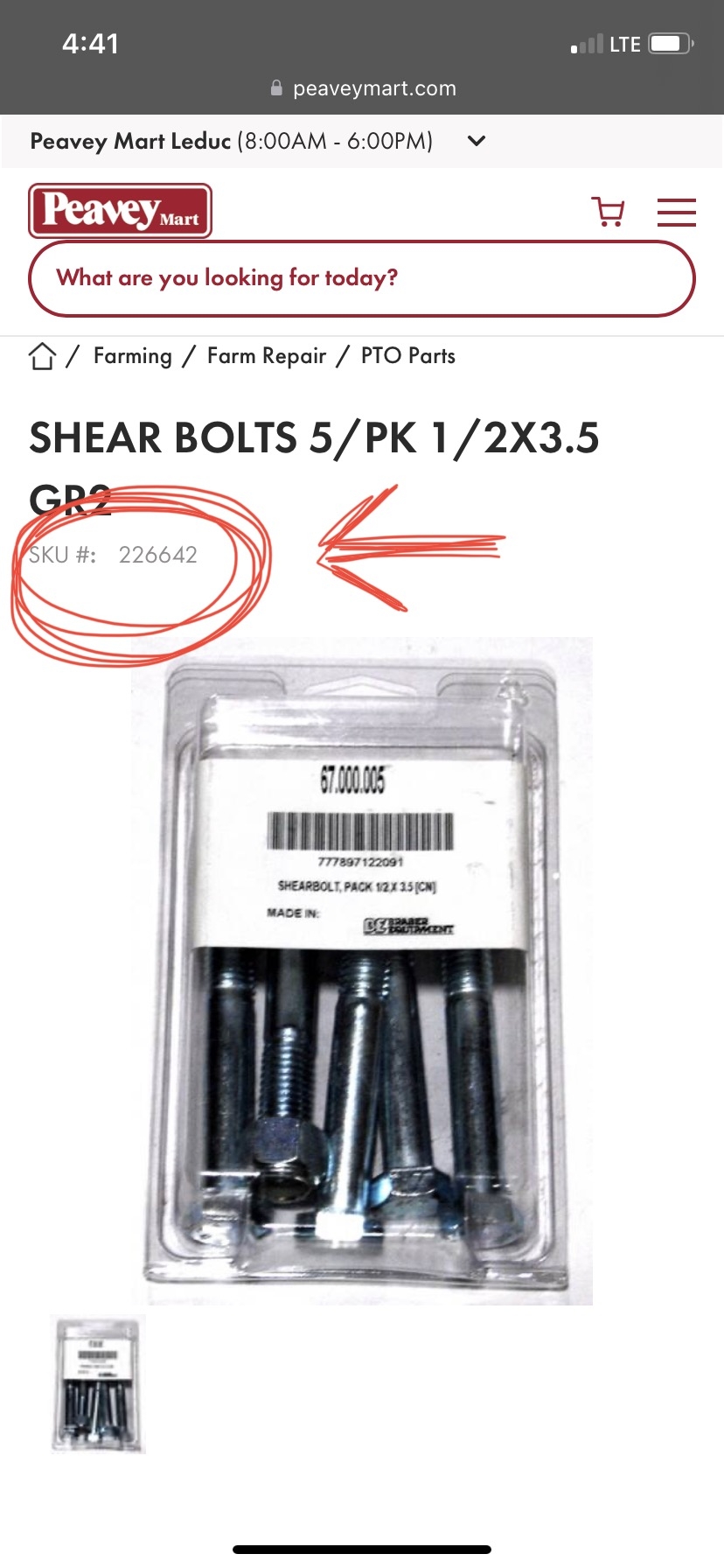

I wish I could remember if I was using a proper shear pin or not… but a while back I backed my brush cutter over what I thought were very rotten logs… well they weren’t and boy o boy that was a mistake.
Long story short, the internal gears that drive the pto completely shredded and I had no more pto.
Was quite a process but I opened up the tractor and replaced the damaged parts
This never would have happened if the shear pin would have sheared.
These are what I get from Peavey Mart
